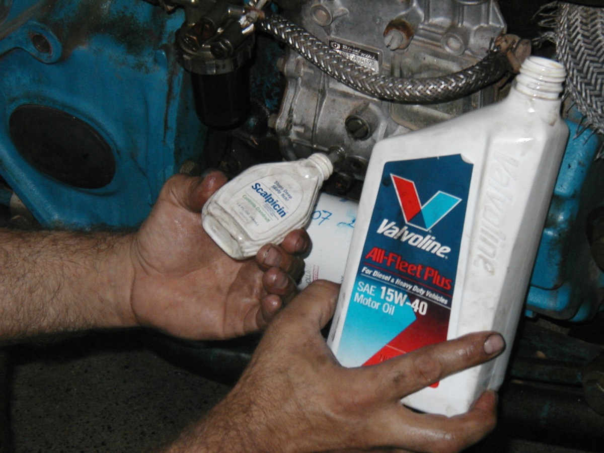

Finally, I changed the oil (used 15-40 OK?) in the injector pump, the level was low and oil was very thick and dirty, a little tricky to refill though, check out the picture, drilled an 1/8" hole in the tip of a scalpicin bottle, took about 2-1/2 bottles to reach level, a little less than 4 OZ's I think,

"It a good thing that you changed..that injector pump is even pricier than alternator. One thing though ... from the pic it appears you filled it from overflow hole. Althogh it should equally work well you should have done it by removing a cap on top of the injector as marked in the pic below. you have a cap on top, a level indicator hole and a drain hole. you first open the breather cap, then open drain screw to dump the bad oil. To fill you close the drain hole followed by opening of the level hole and filling from the top using a small funnel till oil start leaking out of the middle or level hole. you have not done any harm but did not need a squeeze bottle."
JC
I thought there should be an easier way, my filler looks a little different than the picture in your manual as mine seems to have a breather cap on it.

1)I do have the breather cap on mine as well, there is a hex cap right below the breather cap.. get your small crescent wrench and open the cap and breather all at the same time. Breather stays with the cap and use a little funnel to fill.

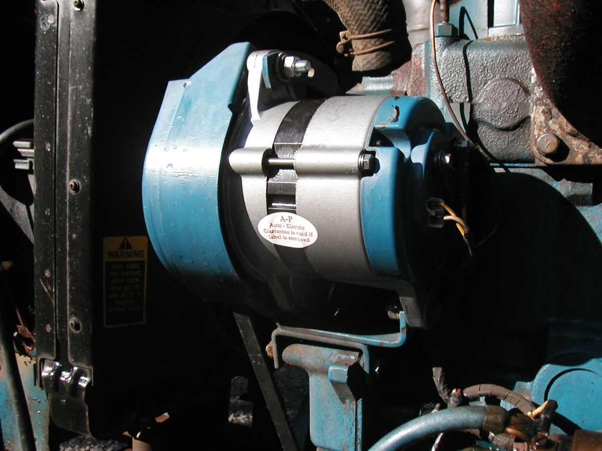

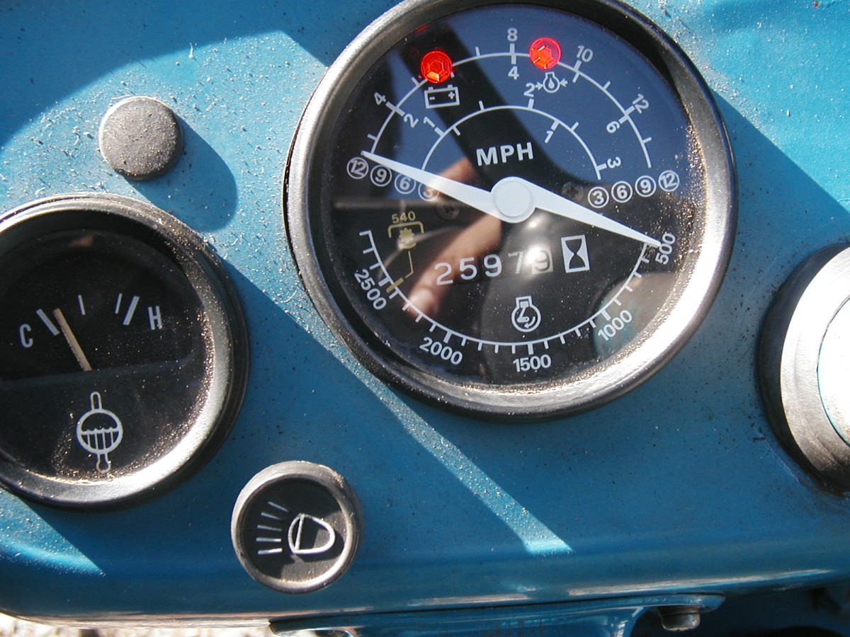

NO no no, MY fault, no capacitor it was the rectifier they said was fried, along with bad brushes and bearings, and something to do with the rotor I think. The bearings are the only thing that might not have been bad, cause to me it seemed tight with no noticeable play, you could hear some grinding when you spin it but I thought that was the brushes.
Anyway everything appears to be A-OK now, it was a good sign when the battery idiot light came on for test when I turned the key, which it never did before, broke out the digi meter for a more accurate reading, got 14.1 volts at 900 RPM's and 14.7 at 2500 RPM's at the battery, the guy said it should not be over 14.2 volts or I may need a regulator but he didn't say at what RPM so I'm gonna run it for now.
They charged me an extra $20.00 for what I don't know but I'm not complaining since they did jump on it right away, I wasn't completely honest with them when I told them I was broke down in the field. I thought they were giving me a new one as it was so clean when I picked it up today, even painted the pulley, they said they put it in the tank, the case looks brand new.
They called it a Hitachi alternator and a Datsun type regulator, if that means anything.
Sandman, I did have a loose belt and replaced it but that was not the problem.
JC, Thanks again for all the help, I am gonna have to sell this thing eventually but I'm gonna keep it through the hay ride season for the kids, it's just not the same feeling with my John Deere with the shiny plastic hood and Electronic over Hydraulic tranny.
A pic of the alternator
