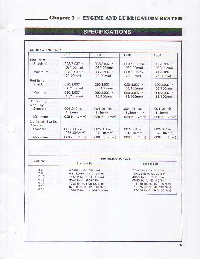

Russel, do you by any chance know the torque specification for the bellhousing bolts?
   / Ford 1700 clutch adjustment #62
I checked my book and found the list of torque based on bolt size, both standard and special bolts.
Russell
