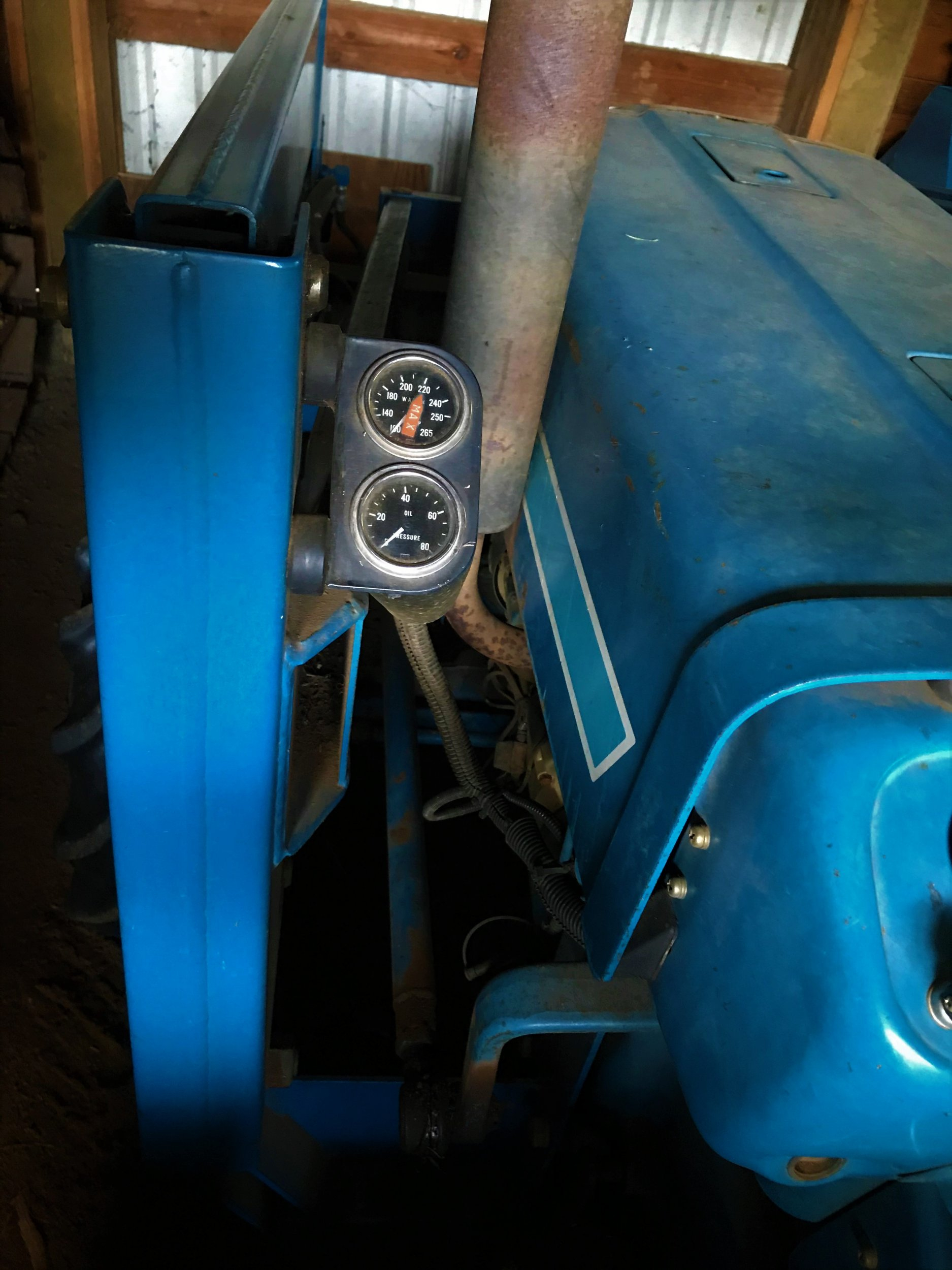

The battery on my Ford 1310 is also forward of radiator and it's never been an issue as far as blocking air flow.
The only time screen in front of the radiator tends to clog up often enough to be an issue is when mowing pasture of tall hay in mid or late summer, but I think that would happen with most ordinary tractors.
