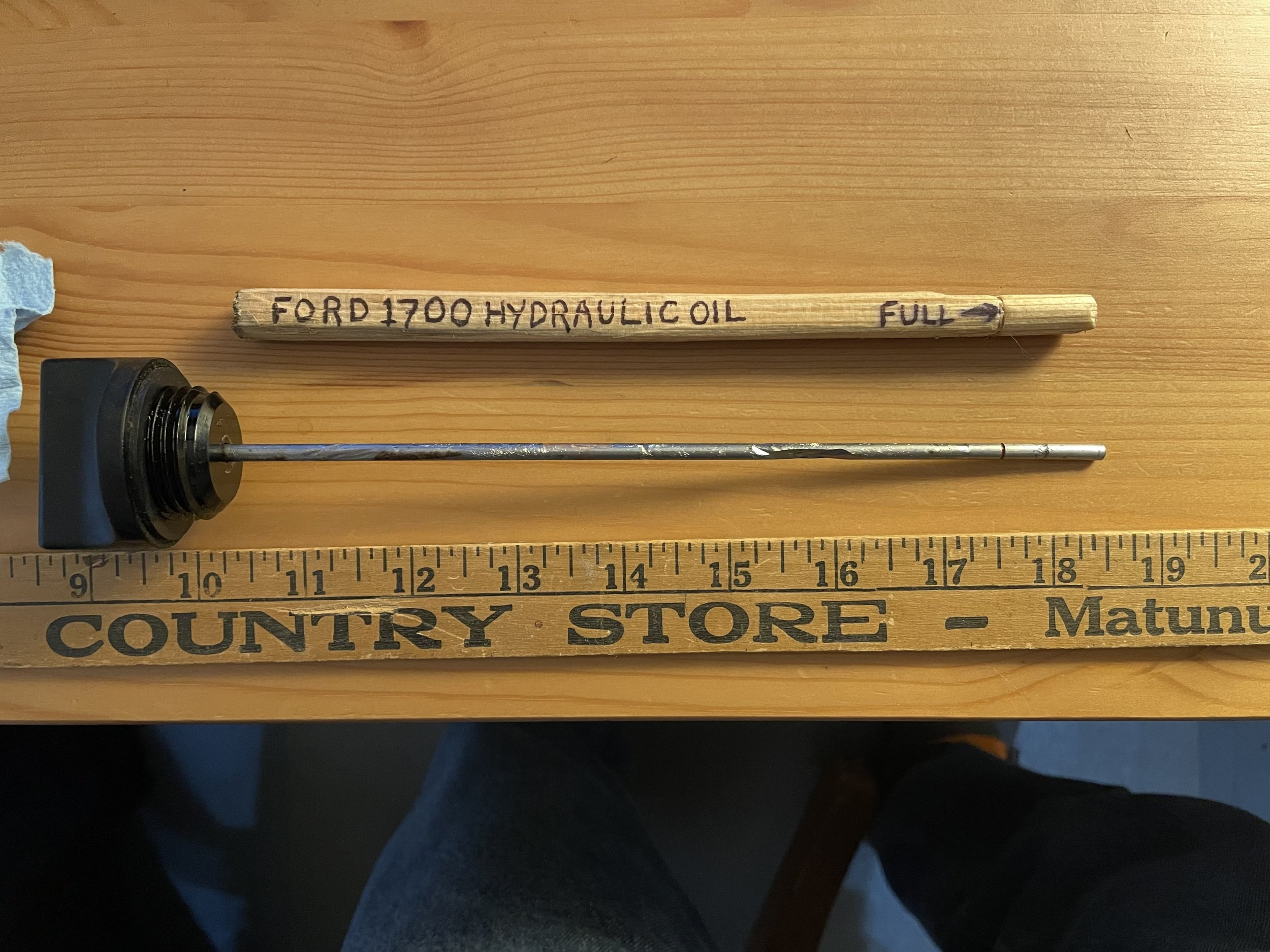

I have a 1981 Ford 1700 4x4 and the steel shaft of the hydraulic dipstick became separated from the cap and fell into the transmission. Poorly designed it is just pressed into the plastic cap. It resided there for some time and jostled around getting shaved nearly in half by the gears. Lucky we saw it down there!
I just received a similar quote today for about $126 to replace. Im just using the cap in place now and have fashioned my own dipstick (that I keep in the toolbox) using the old one for reference
