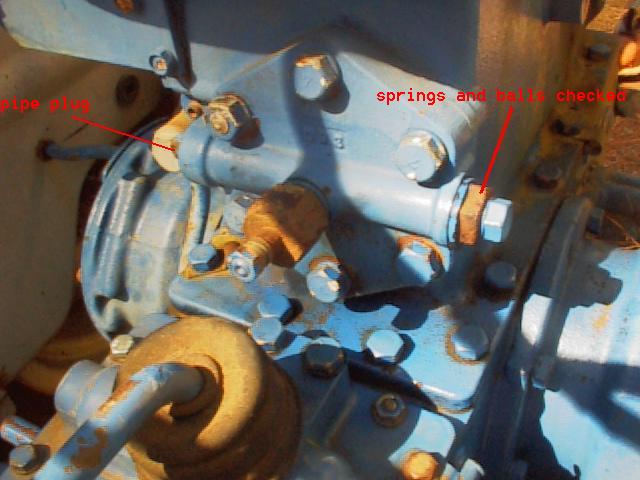

Here is a picture of what I have. The "double headed" bolts on the right side each contained a spring and ball. The longer (inside) fitting had the o-ring on the end like the one in your picture. That outer bolt was also hollow and had a spring and ball that inserts down inside the larger fitting against an orifice in the end of the larger fitting. (hope this make sense). All that looked just fine.
On the left side, just like yours, I have a pipe plug which would be the place to insert a gauge like you mentioned.
I made some effort to adjust the control in the center, which I suppose adjust the rate at which the lift travels. I am positive it has not been moved since it rolled off the assembly line. Mine does not have the knob like yours. There is a nut over the top of the shaft. Just under this nut is a knurled section that I suppose would be adjustable....if I have guts enough to try and get that outer nut lose. It's tight and I was in fear of twisting it off. so I left it alone for now.

hey Old,
Looked at our picture. The one that you marked " Spring & ball checked" is not your " adjustable" pressure relief mechanism. it is not the same as I have pictured. what you saw is the picture below. The stiff spring and the ball on the right side is lift piston shock relief (not adjustable) back to diffy. The flimsy spring and the big ball is normal flow from to the top of lift piston. There is also another hole that allows oil entry in to cylinder chamber. That does not have a check valve but does have rate of return needle valve. when you lower you lift that is the unchecked path where oil goes back to diffy thru lift spool valve.
Follow the pump discharge on the right side of the tractor (smaller dia)out of the pump. It will go thru the relif valve like I pictured before it goes to the spool.
The "control in the center" is the rate of drop knob... yours does not have the knob.. but the same difference. That does not do anything at all to your lift. it only restrict the flow back to diffy hence making the arm drop faster or slower.
I really think it is best for you to get a gage and measure system pressure and as you increase the lift at some point the relief will chatter. You wanoo know at what pressure it happens.

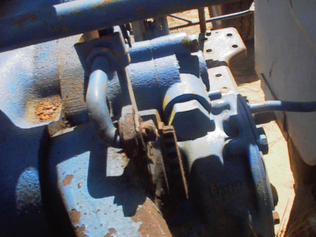

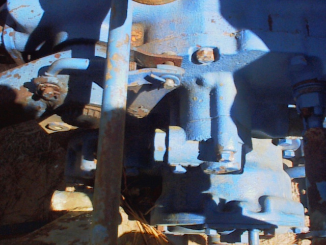

I have three pictures attached.

well, you're right , the relief valve sure looks different. I went to CNH Website (I went to CNN first thugh:D:D) and downloaded yours and sure enough it looks exactly like my 1700 on the website. I attached the page to this posting. However it looks like does not matter. I'm sure if you take the cap off you will see a stiff spring and a conical shape valve ( relif). I bet ya a dollar that yours might use shim to adjust the pressure (a washer with the right dia can be used). It might uses shimslet say with certain thickness giving you about 50 psi. Add shims and you're increasing the pressure. Remove a shim and you're reducing the operating pressure by 50 psi. I looked at my IT manual pages and it shows 1500 exactly like my 1700.
