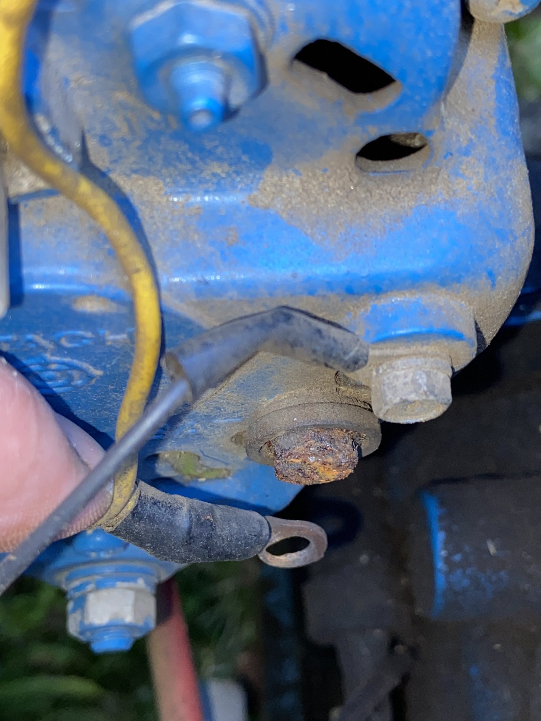

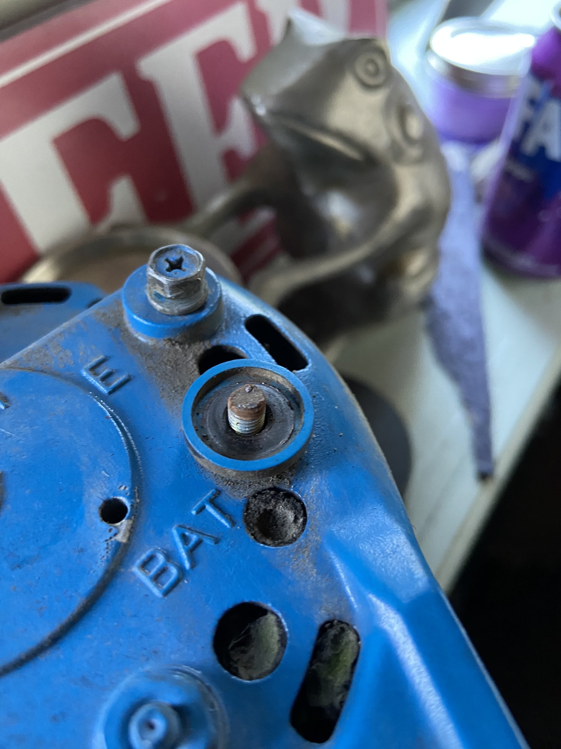

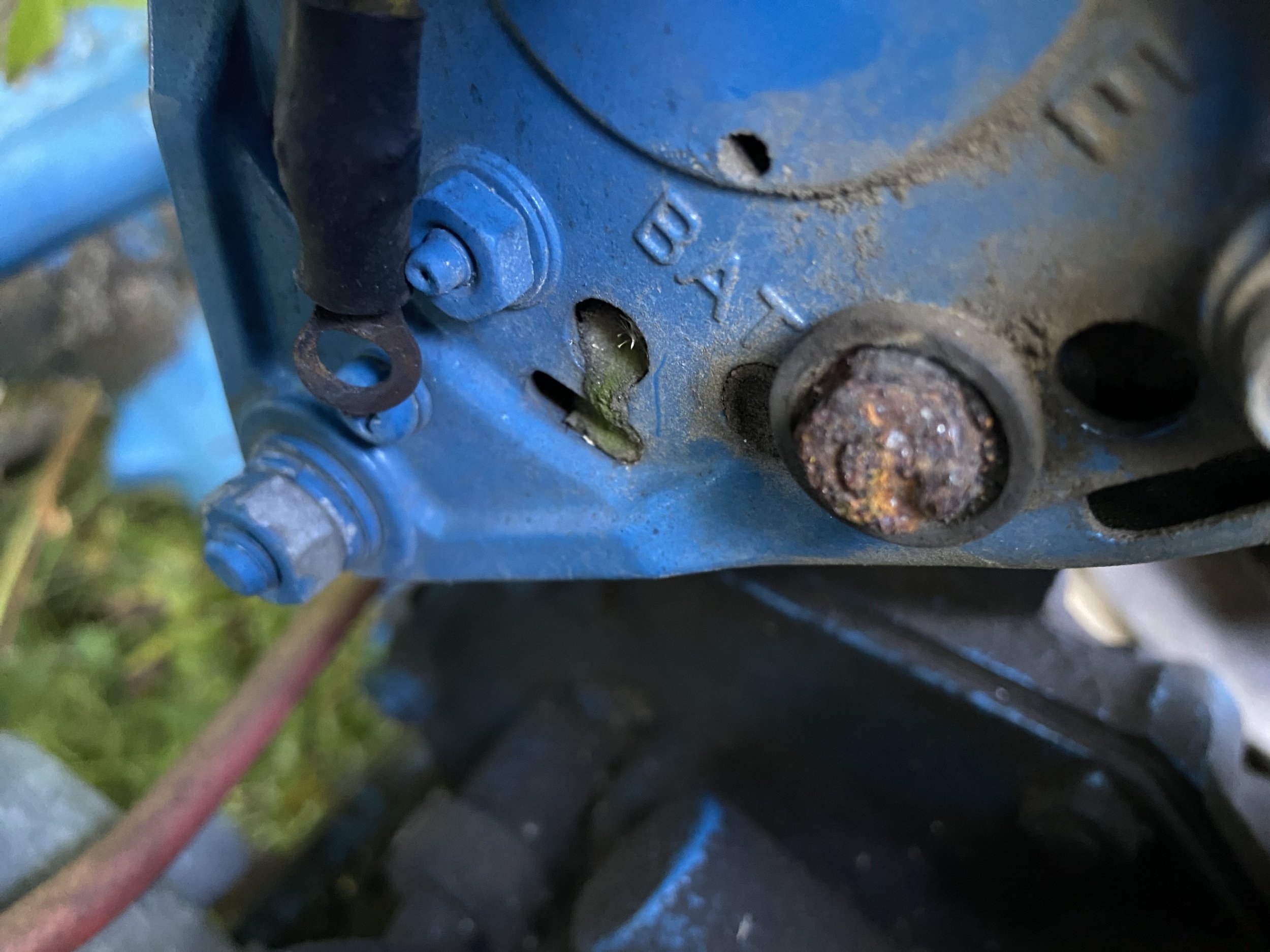

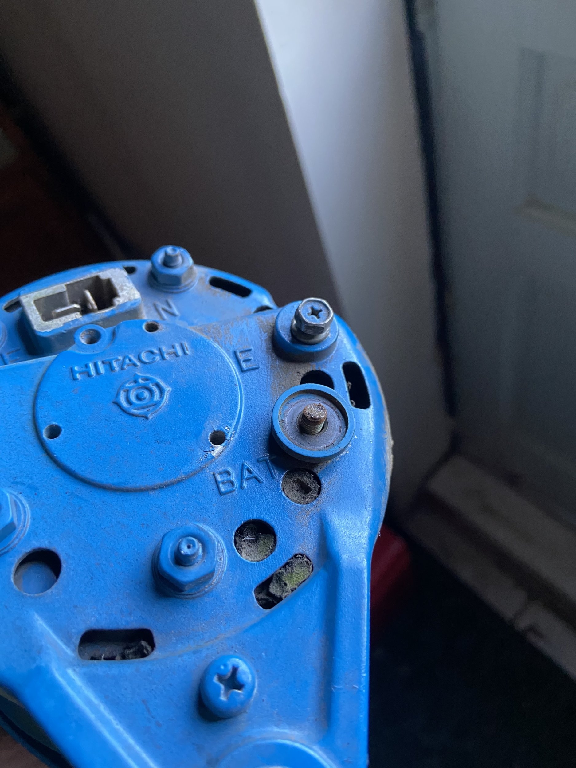

I believe I found the issue. I chased the POS wiring to the back of the alternator and found the “BAT” pole was naked, with what appears to be a broken threaded post, rust nut, and a connector hanging in the breeze; assumedly previously connected to said BAT post. See pics.
Only question: seems I have to open up alternator to get to that threaded bolt to replace, and I do not enjoy these jobs - keeping armatures in place and brushes/magnets from springing out of place. Wish I could somehow thread a new nut with some connecting hardware to “make the connection” with the threaded post…. Maybe something at Lowes/hardware shop??

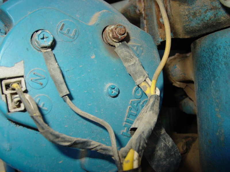

Yup, I think you are in the right track. i don't recommend taking anything apart. I zoomed in and it seems you have enough thread on the positive post. I just clean it up good with dremmel and wire brush and find a nut that fits it. I would wire brush the eyelet or crimp a new one as they are readily available in Lowes or even HF. You will not be able to find that stud easily and once you open it up you are in a point of no return. Below is how the wires need to land. It would not hurt to smear a thin coat of grease on the new bolts to mitigate the future rust if you wish. I hope she'll start with the first try.
