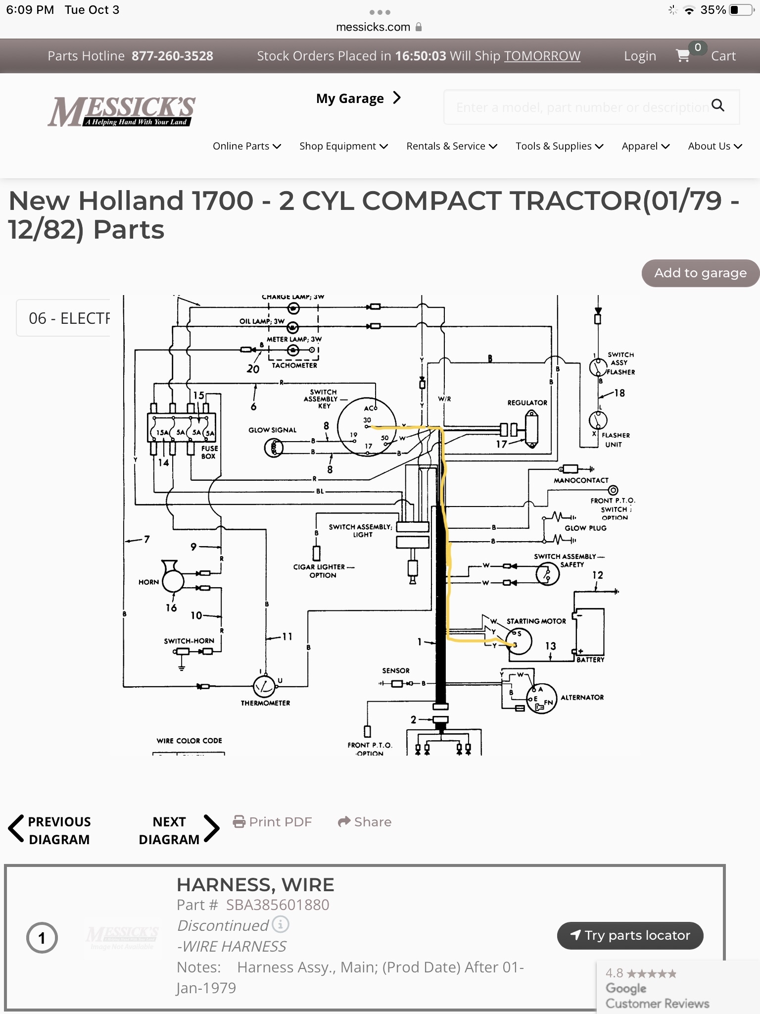

When you say, "check for voltage at the ignition lug" I'm assuming you mean one of the pins on the back of the ignition switch? Can you tell on the image I attached which is that lug? (Sorry if I'm a stooopid)
Yellow is the line in from the battery lug.

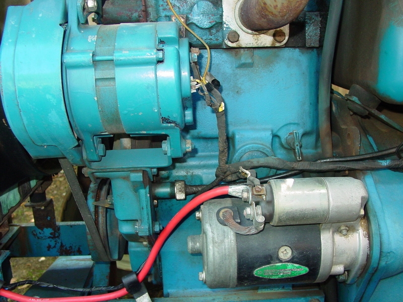

The big top lug on the starter is what he is talking about. This will confirm whether the problem is with the cable or not.
Also, with the tractor out of gear, you can take screwdriver and lay across that big lug to the small tang on top of the starter to see if the starter will turn over. This will verify whether you have voltage on that connection at the starter. Again, with the tractor in neutral!

This is what TractorTech was talking about to short out the lugs with a screwdriver to turn the starter manually independent from any circuit or safeties that in this case is only neutral safety, lugs connected to bare wire and the red.

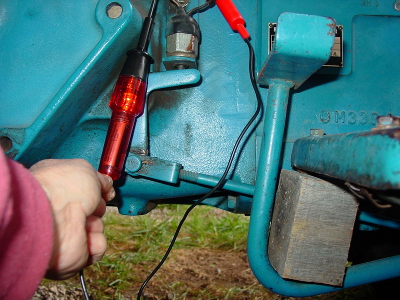

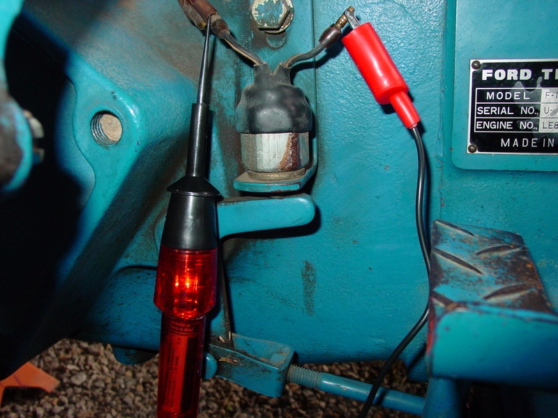

This is how you test the clutch neutral safety switch,
1- switch is normally open so with clutch pedal not pressed on the test light is off. By pressing the clutch down the light with illuminate proving a closed switch to complete starting circuit.
