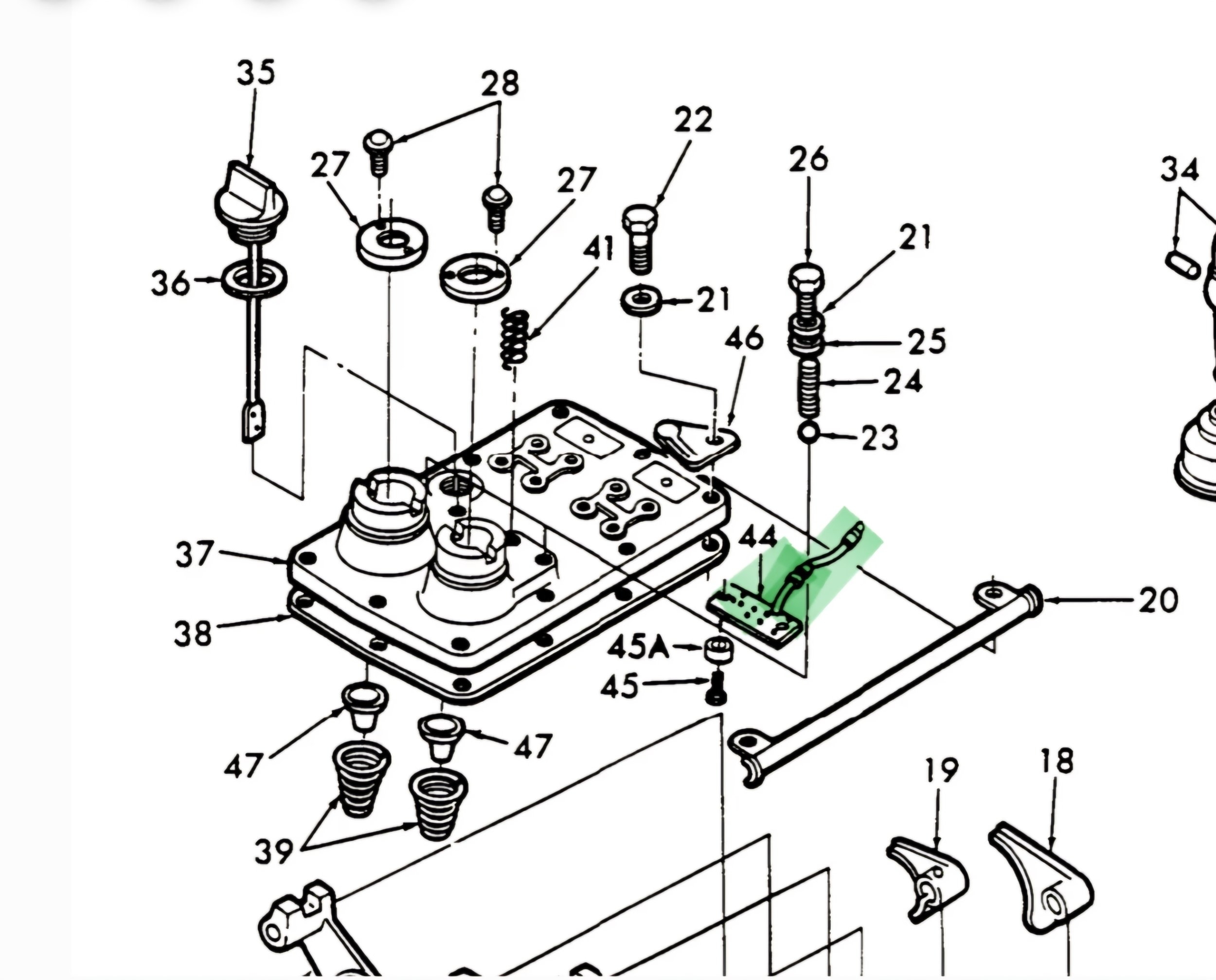

Sounds like the neutral start switch may be acting up, 44 in the picture. It is a printed circuit board under the shift cover.
Also, when you are trying to start with the screwdriver on the starter, are you touching the top, large lug to the small tab/tang? If so and the starter motor just runs, then the solenoid on top of the starter is stuck or bad.
If you try that method again, wrap on the solenoid with the handle end of a large screwdriver. Sometimes they just stick after awhile.

Good question. I forgot that model also has the clutch pedal switch besides the transmission neutral switch. No PTO or seat switch

Thanks for all the replies. Don't have any easy options for raising the bucket unfortunately. Took out hinge pins and tried to get hood off but it's just me and it still binds up on the hinge and I can't get it around them.
Best bet is to get it started if possible. I'll disassemble what is shown on the diagram and see if I can see a problem with the neutral safety switch.
