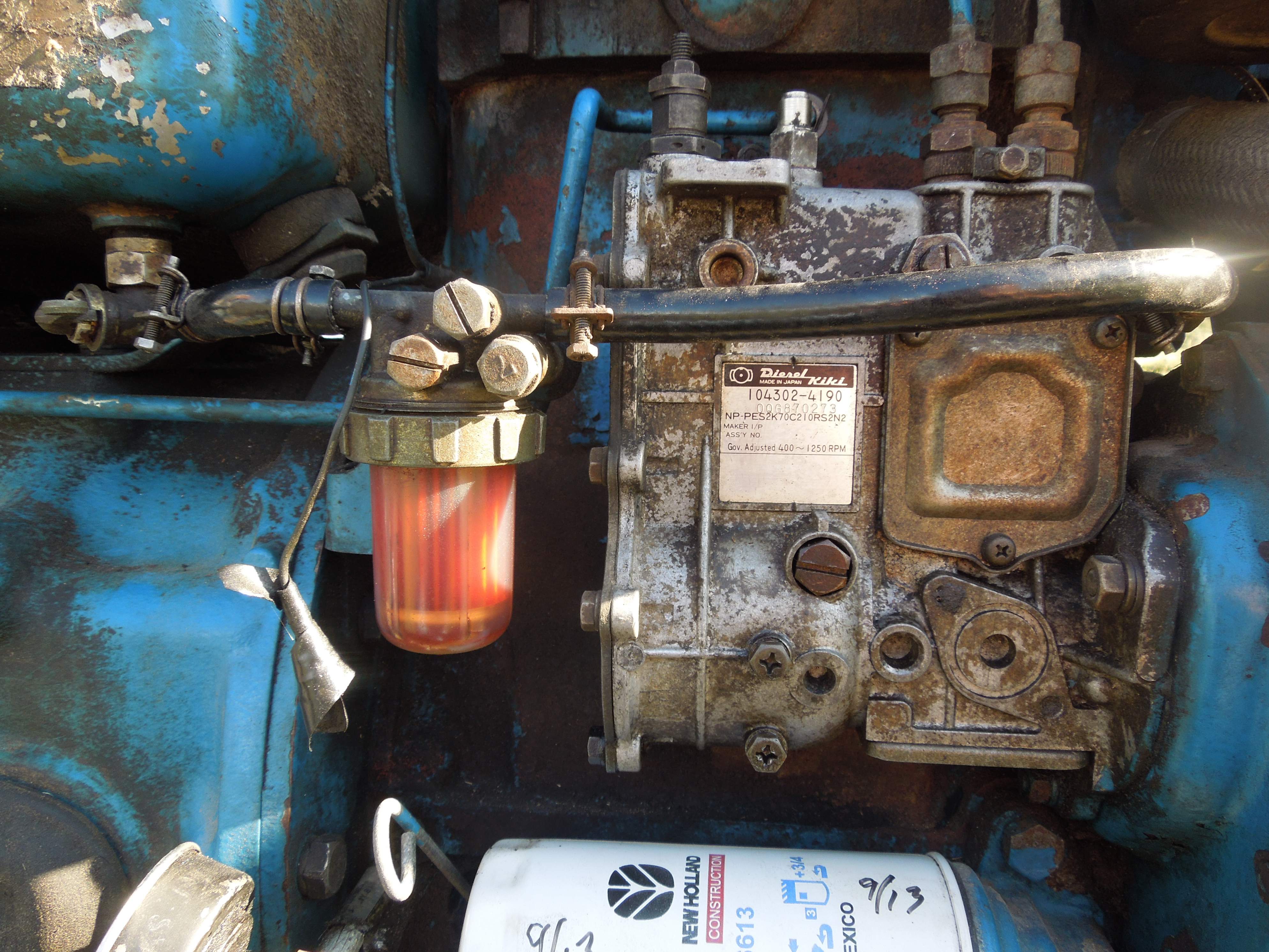

OK, I checked the tightness of the glow plugs and they were fine. I then pulled the fuel hose off from the injector pump to check for flow. There was a steady stream that was a little less then the thickness of a plain pencil (sorry for the lack of a technical term/measurement). While I had it off I decide to just drain the off road/red diesel. As you can imagine the tank was full so it was taking a while. Towards the end the flow really slowed down. At that point I decided to turn the valve off and remove the tank. After getting the fuel out, I found a piece of rusted sheet metal about a half inch by inch and half. I also heard something banging around in the tank. With a flashlight a could see what appears to be a rusted, metal rod/tubing about 8 inches long. In the field I was wasn't able to get it out, but I plan to take some needle nose pliers to it later today. With the light, I could definitely see some rusting in the tank. I'm guessing the long piece could even be off a seam inside the tank. As promised, here are some pics...
Here is the new alternator I installed and the starter that was rebuilt.
Here is the famous injector pump:
Off hand does anyone know where that wire that is tapped up is supposed to go. I haven't looked in the book yet, but it travels to that area with the same wire that powers the glow plugs. More pictures to come...
Thanks to all.
From a picture in Pete Clausen's thread, I think that wire goes to an oil pressure sensing element down near to where the oil dipstick is located.

Jim,
You are right. The wire does go to oil pressure sending unit.

Cj,
I'm not completely convinced that you fuel system is bled of air fully. You can take the nuts( two) completely lose and expose the end of the injector pipes before going to injectors. have someone crank and you observe flow or you can do it while seated and looking at the end. You must have small amount of pulsating fuel coming out without any bubbles. Air is compressible but fluid is not, even small amount of air in the line can compress back and forth without against the 2000+ psi that injector spring can cause. 2000 psi is not the stiffness of the spring but the pressure to squeeze the spring is about 2000 + psi. verify flow and report back with the result. also make sure to open up the screw next to a plate (plate with screws ) is open so by gravity air can be bled right up to pump cam mechanism.

CJ,
You need to look at the tank outlet height in regards to filter intake and injector intake. On some tractors like my Kubota there is a small transfer pump before the injector.
In your 1700 system is gravity type all the way to the inlet of the pump. following is the process you need to go thru where you can also see visual feed back of what's going on.
1- Make sure tank has fuel above the tank outlet. Just imagine you changed the filter and it dry and you just put it in with the tank valve in closed position. when you open the valve you will see no flow as the air is trapped and can not escape the filter bowl.
2-There are two screws on the bulb as you open the first one partially you should quickly see the bowl start filling up and air escaping from the screw hole you just loosened. Continue doing so till bowl is full and only fuel is coming out. You need to close first screw there. Then open the second screw that removes the air on piping on bowl cap. As soon as only fuel comes out close the screw just the same. So far you have bled air all the way to outlet of the filter.
3-Now you need to bleed air from the rubber hose to the inlet of the injector. There is a large screw on the top right (about 3 o.clock), next to the plate with 3 screws. loosen the screw there and all the air is bled just to the inlet of injector pump.
so far all you have done is by gravity and nothing else. The last piece is to remove air out of the metal pipe to each individual injector. This has to be done by cranking the engine. as I said before air is compressible and fuel is not. You can crank all day and the air will just happily pulsate back and fore with no pumping.
4- loosen the nut and crank engine a few time till the fuel travel up to injector while expelling the air. Once you see solid fuel and no bubble then tighten the nut , preheat and try to start.

For a long needed update, I finally got to get back to checking the fuel/injection system. I started by adding more fuel to the tank. The tank height looks to be in the factory position. All of the rubber pads that the tank sits on are still there. The bottom of the tank is higher than the fuel filter bowl. I turned off the fuel cut off below the tank and again dumped the fuel from the bowl. There was a little more sediment in the botton of the bowl that I clean out with a little gas and a tooth brush. I verified the filter was still in the right spot and put on the fuel bowl back on.
I then turned the fuel supply back on. The bowl filled up with fuel in about two seconds. I then went on to the two bleed screws about the fuel bowl. I opened both at the same time and fuel streamed out of the first one and trickled out of the second on. I closed the first on and then the second one started to stream. I then moved on to the bleed screw on the injector pump. Upon openning that one, I got a steady trickle of fuel. From there I moved on to the two metal lines feeding the injectors. I totally took the nut off the left one and with my extra set of hands turning the key, I watched a pulsing of fuel squirting out about every 3/4s of a second. I put that nut back on and went to the right injector line. With the nut off, I saw the same pulsing of fuel.
I replaced the nut and then turned the key switch to the left to warm the glow plugs for about 15 seconds. I then tried to start it with the fuel lever at about half. It turned over, but didn't start. I put the fuel lever at fuel throttle and the engine turned over a little faster for a moment and then back to the previous speed. All this time the exhaust is white. Thinking the battery could be a little week from all the current and past troubleshooting, I hooked my truck up with jumper cables, but got the same result.
I moved on to pulling out the glow plugs. I noticed they didn't seem warm at all. I put them mostly back in the block and connected a jumper wire directly from the positive battery terminal to the plugs and help for 15 seconds. I then took them back out of the block to find them to hot to touch and smoking with what appeared to be some "carbon" on them, but no where near red as I saw in someone's past post. Could this be caused by bad glow plugs? Is there a test that can be done on the glow plugs? I didn't notice that they do cool off fairly fast.

Cj,
all you have done is right and as suggested with the right sequence. You have solved the fuel delivery issue. up to injector. There are couple of things that can make starting difficult from here. one being glow plug that is not heating and assisting the combustion. I have taken my glow plugs off but did not glow it directly and measured the temp. I'm out of town and can't do that for compassion. Might be able to do it next weekend. Secondly if you do not get a good spray patten from your injector it'll very difficult to start. fuel has to come atomized in to the combustion chamber to ignite by heat of compressions. If you have leaky valve or bad piston ring you may not have the compression you need. There is no issue with pull stating as long as you do it in higher gear so you will not stress out the low gear and damage to transmission. Be ready to communicate well with the driver that is pulling you and the rig and ready to pop the gear in neutral or clutch to cut power to transmisson. Make sure the throttle is in the middle when pull starting.

CJ,
Professional shops use hand operated pump to build up the required pressure (2000 + psi) range to simulate injector operation inside a safe glass vessel in order to check the atomization and spray pattern. I have heard guys checked the patter against some card board. I don't have spec of the pattern size @ what distance to the card board. I'd probably look for a round and good atomization by visual inspection. Be warned that diesel at that pressure can easily puncture skin surface causing severe injuries.
