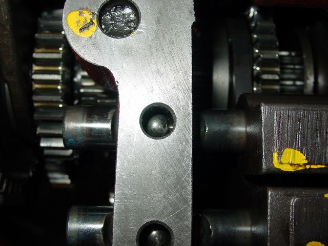

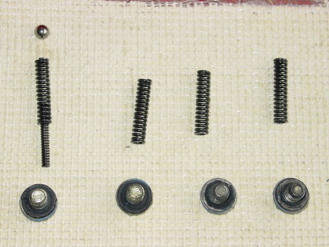

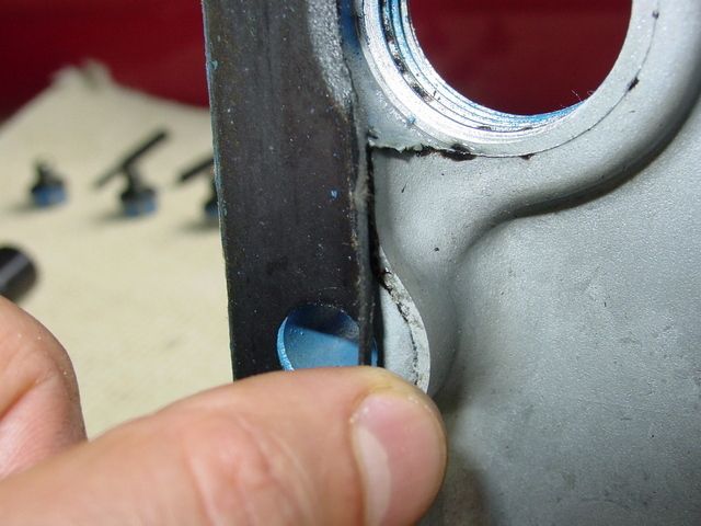

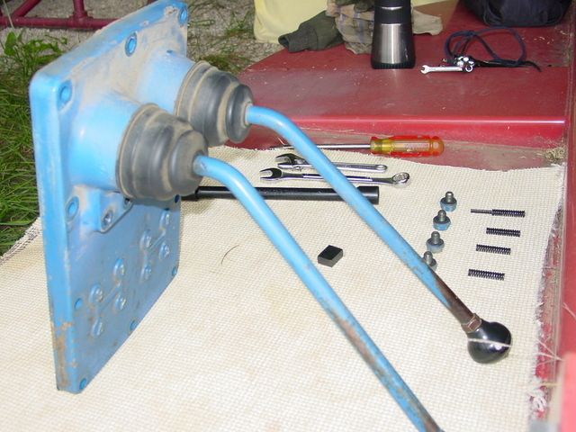

As promised. Pics are self explanatory do ask if you have question. Your problem is stuck detent ball and spring or perhaps brocken spring.

Which screw came with 2 springs? I don't see it called out in the drawings at messicks or new Holland?
   / Ford 1700 transmission innards.
#17
Under each shifter there are two bolts and each bolts is on top of one spring totaling 4 bolts and 4 springs. On my ranger selector the left bolt had two springs.
