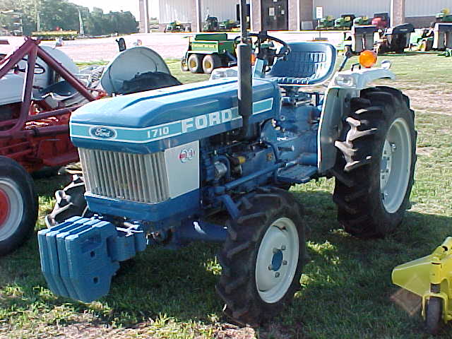

Looking at buying a Ford 1710 4WD with FEL all 4 new ag tires
and 1500 engine hours,the price is $8500
My concerns on this model are as follows:
1. hydralic speed in cold weather (for FEL)
2. Was told to watch for transmission/4WD problems in this model. Any truth to that?
3. Reasonable price?

Only found this one at Machinefinder.com listed by a dealer in Nebraska. Asking $9500, no loader but only has 355hrs on it.
Steve
Champagne Taste, Beer Budget
