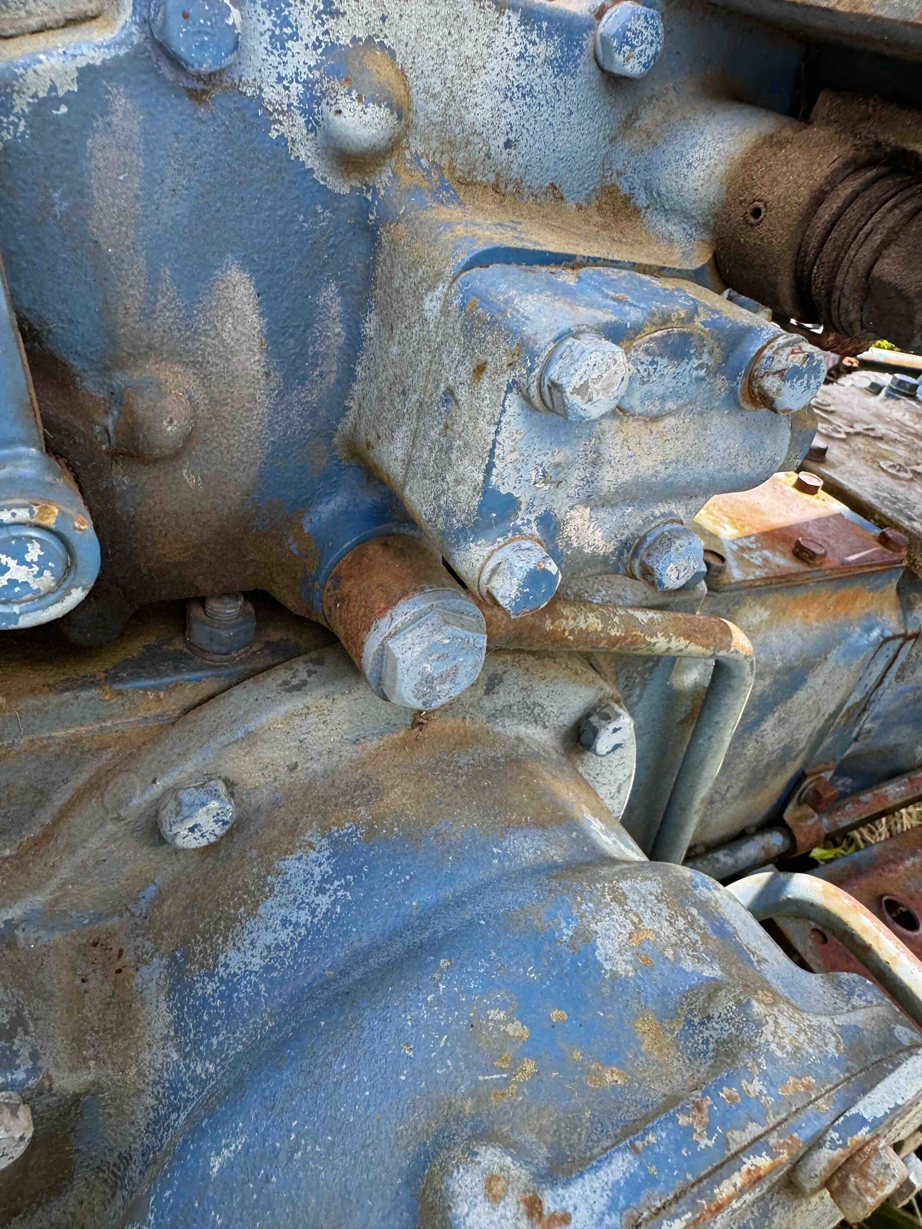

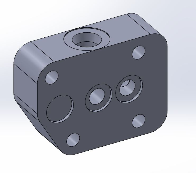

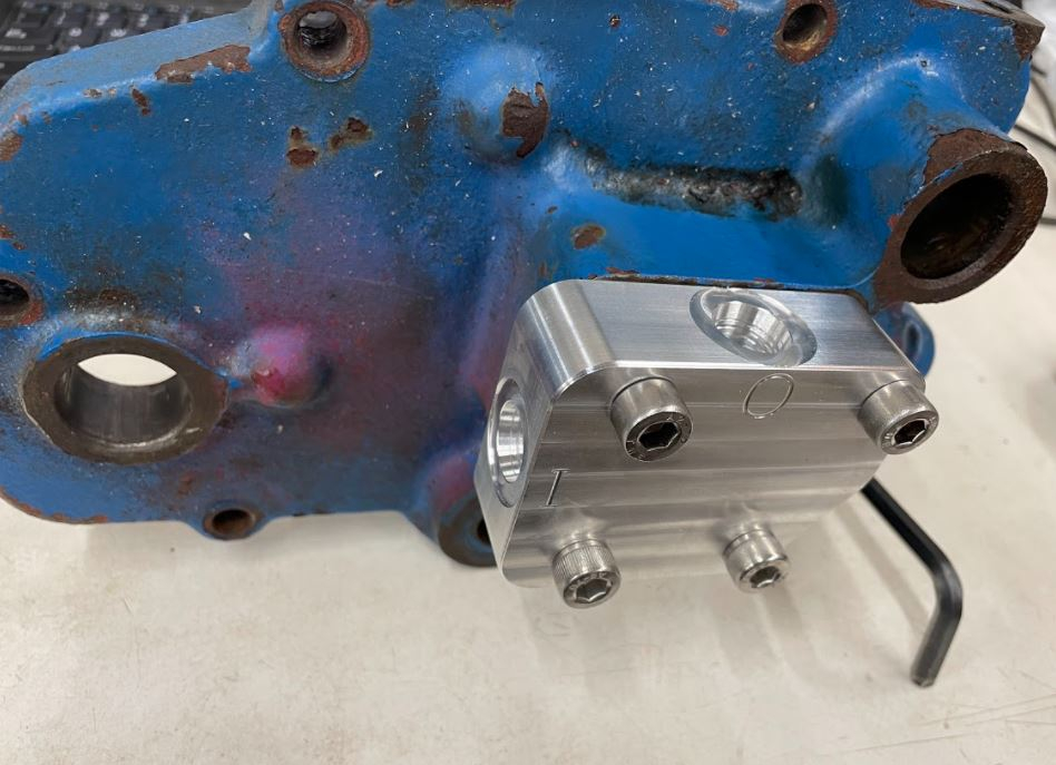

Hi Nick, That looks like a 1700 with draft control. It should have 2 levers for the three point. I have machined an adapter for a 1910 with draft control (see picture) which looks like the same shape and bolt pattern as your 1700. The only issue is that the 1910 has the relief valve upstream from that 4 bolt cover, where the 1700 has the relief built into that cover. I should be able to modify my adapter for the draft control 1910 to incorporate use of the relief valve.View attachment 745328View attachment 745329
Hi Ted
Did you ever manage to know if your adapter would work with the 4 bolt plate? I'm in New Zealand and I have a 1900 and it too has the 4 bolt plate and the draft lever too.
I really would like to use a 3 point hitch forklift attachment that needs an auxiliary hydraulic feed. Any help would be gratefully received.
Thanks
Jonathan
