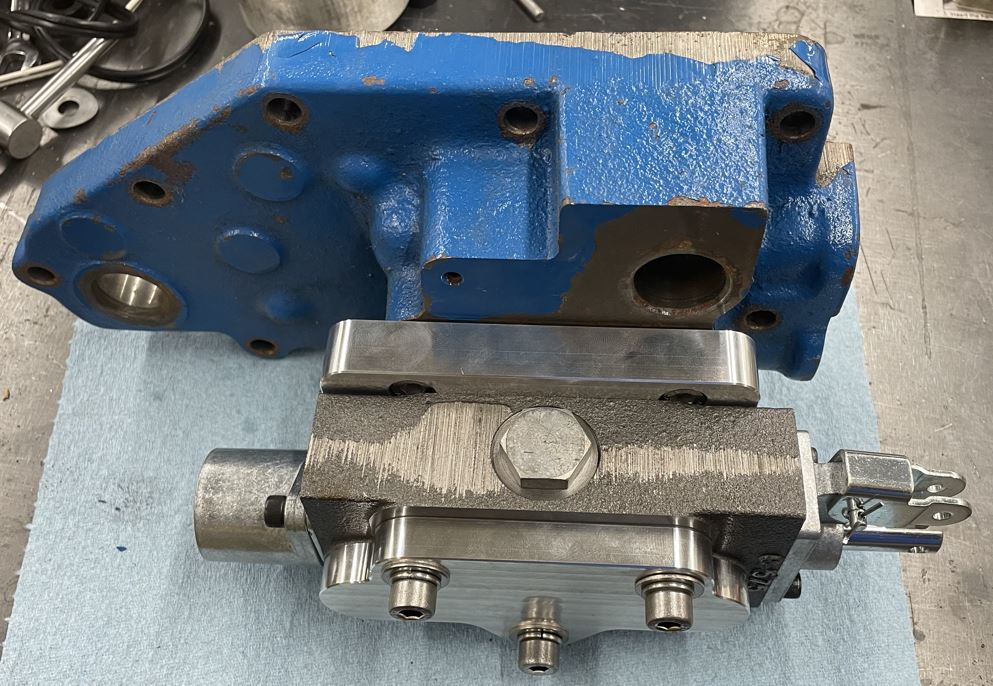

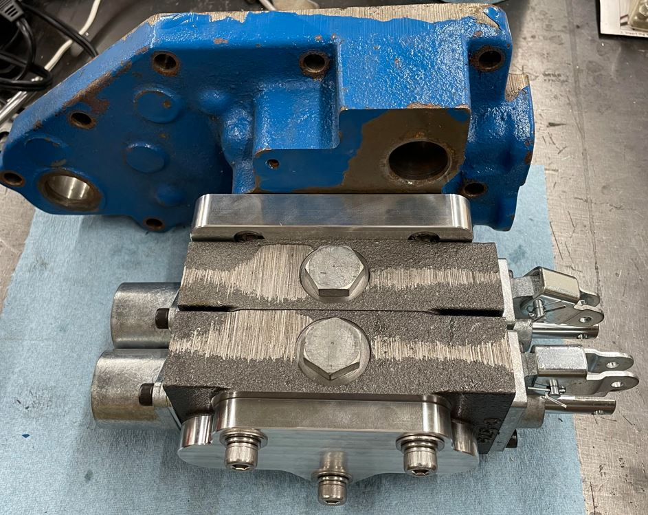

Sorry for the delay (recent job change so have been super busy) but I've finally finished designing the 1720 remote valve adapter and machined the first prototype set. I still need to work out the valve handle since it needs to sneak through the 1720 sheet metal into the operator area. The outlet ports on the valve point down so need to figure out some fittings there.
The last picture shows two valves mounted. That is the cool part of the sectional valves that you can keep adding to the stack until out of space.
Ted

Looks good. Appears there would only be about 3 inches of clearance below your plate to the top of the brake housing on both my 1720 and 1920. Here are two files of an exploded dwg of the OEM valve showing the fittings, etc. and a parts listing. Maybe you already have this info.

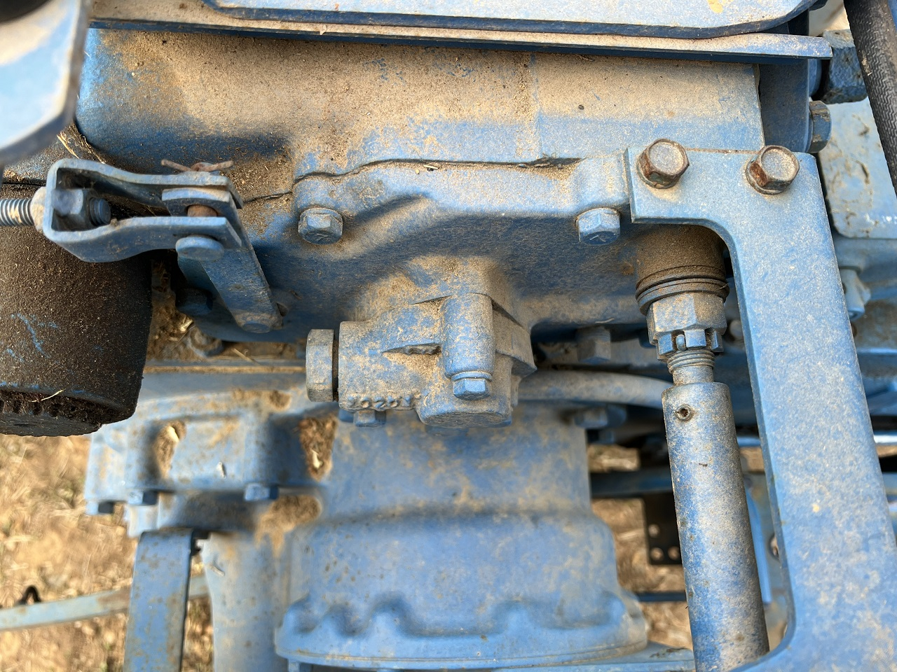

You're correct on the clearance being only a few inches. I'm guessing that's why the OEM valve is using banjo style fittings rather than 90° ones. I did snap a picture of the 1720 by me that has the remove valve.
