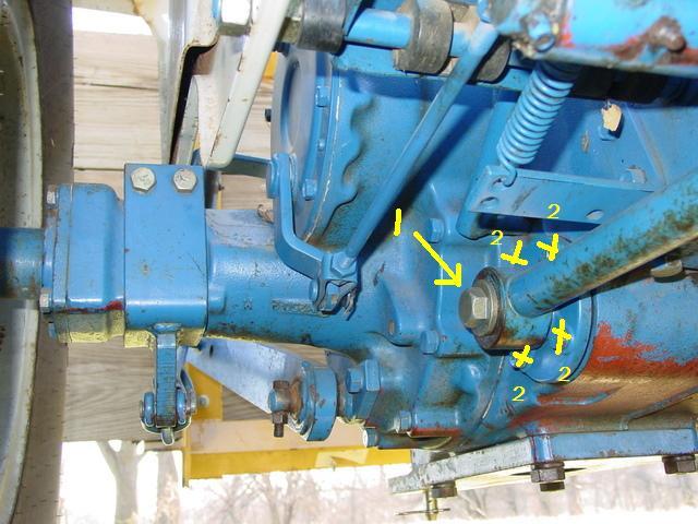

I am an 1710 owner.
Yes, first you unscrew the bolt on the tube labled #1.
Then undo the four bolts labled #2 to get to the screen.
I am betting when you do, you'll find your screen is badly contaminated. Mine was- and I don't think mine was cleaned in 20 years. Rinse it out with gasoline (swirl around and it comes clean quickly) and then put in back together and put in fresh hydralic fluid, and it will work like new.
That's what happened to me- just like what you describe-milky fluid and poor lift capability. Cleaned the filter and put in new fluid, and it worked 1000 percent better.
Good luck.

James,
The picture that you re posted is actually my 1700 which is perfectly okay. Does 1710 have inlet screen and looks exactly like mine? if so OP can look up a few thread I started that goes step by step thru the same process.
JC,
ps. NH website does not show inlet screen.

I was surprised. I thought all the tens had the screw-on filter.
