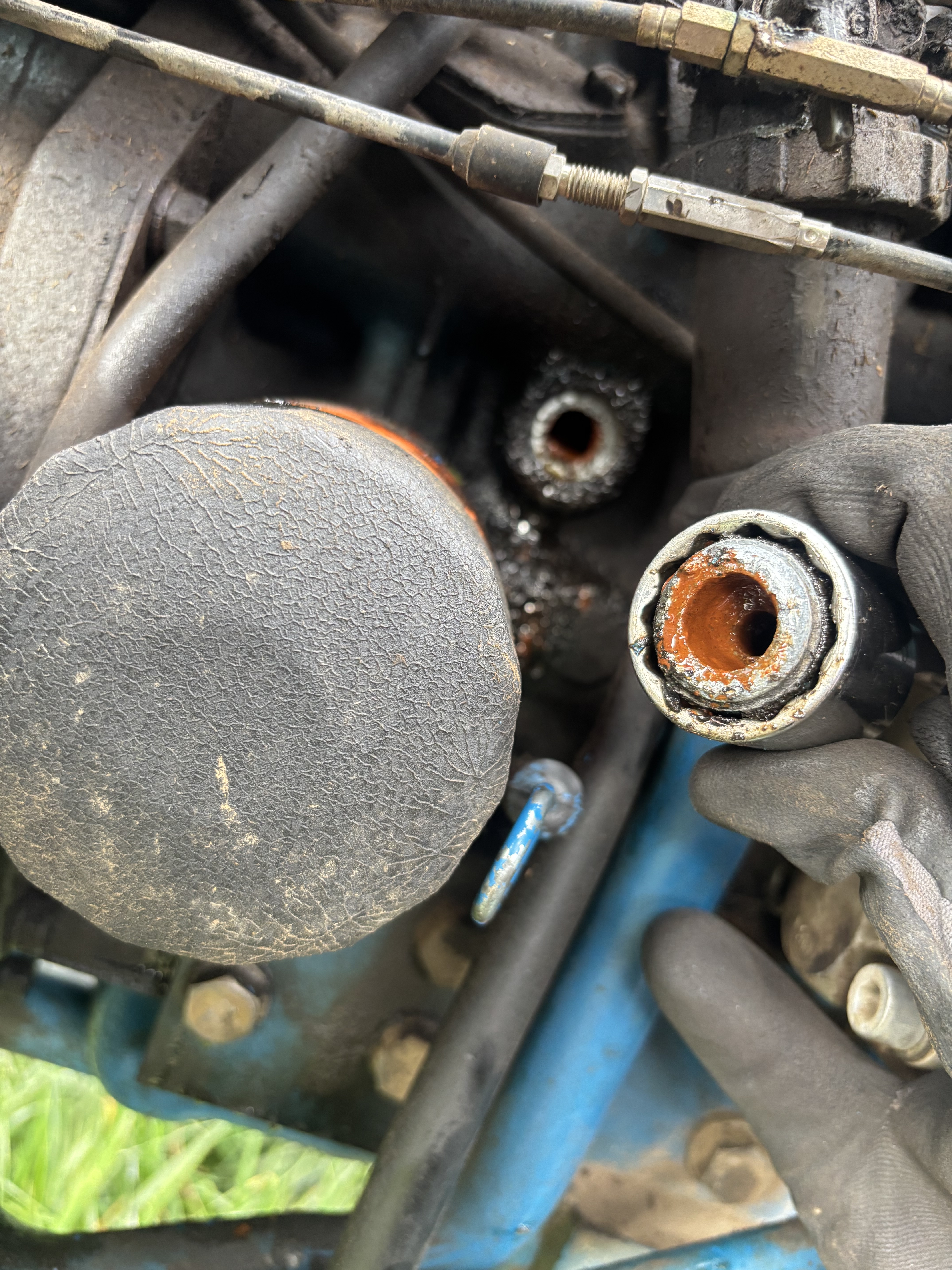

Anyone have any ideas on how to fix this? I have a 1990 ford 1720 that had a coolant hose leak down by the drain, tried to take the hose off the replace it and the nipple it attaches to broke. I tried removing the whole piece that threads into the block and that also snapped off. I had a breaker bar on it when it snapped so I got some good torque on it and the threads didn’t break loose. That makes me think using an easy out probably won’t work. Any other ideas or am I SOL?View attachment IMG_7838.jpeg
   / Ford 1720 coolant piece broke in block #2
I would clean up the area and dry it off. Then i would try squirting penetrating oil on the threads (WD40 is not penetrating oil) and keep it wet for a week or so. Then I would try an ez out and see if I could get it out. Don't snap off the ez out!!!
If that fails, I would use a die grinder or dremel and see about grinding the metal down, until I could just see the threads in two areas on opposite sides. DO NOT damage the threads. Put a rag in first to keep metal out of the engine. Then I would take the ez out and put it in, making sure the teeth of the EZ out were not on my ground down areas. In theory the ground down areas will flex allowing the ez out to unthread the broke piece.
If that fails I would grind two more areas down. Making sure to put a rag in first to keep the metal out of the engine. Then i would use a cold chisel and try to spin the broken piece out.
If that fails I would then use the cold chisel to beat the pieces in collapsing the broken part. Once you get one piece broke out, the rest will most likely fall out with a tap.
There are other ways to handle this, however this would be my approach. Take your time and don't damage the threads. Also don't use a breaker bar on the ez out, your changes of breaking it off are too high.

Thanks for the replies, I tried the ez out this morning and got a good bite on it but it still didn't want to break free. I put some pretty good pressure on it but think i might break the ez out if i try any harder. Ill let it soak in pb blaster for a few more days and try again, if that doesn't work then i will break out the dremel and see what i can do.

You could also just use a file to file through the wall of the pipe until threads start to show. There is a tool made for removing pipe nipples that most good hardware stores sell. This tool has splines and a splined wheel that has a hole drilled off center. When inserted into a pipe and turned the wheel cams outward and grabs the inside of the pipe. Cutting a groove in the pipe wall and then using some penetrating oil along with the tool could just do the trick. Just let the penetrating oil soak in for a while.

I've used a similar idea only cutting with a hacksaw blade. Just wrap a rag around the blade to protect you hands and start making a slot in the fitting. Once you have reached the threads quit cutting and use a punch and hammer to slightly collapse the fitting. You might have to cut two slots but once the threads are loosened up the fitting will easily come out.
   / Ford 1720 coolant piece broke in block #14
I like the hacksaw idea. Because the pipe is probably rusted in place, and because rust expands which makes things tight, slightly collapsing with a punch is a good idea. The broken pipe doesn't need to be saved, it just needs removal.

Also, I have noticed in one or more of the attached links to other threads, that this fitting might be/is British (BSPP or BSPT?). Best to not replace it with an American NPT fitting: they have different thread angles.

I was able to get the old piece out of there. Ended up drilling it out and running a 3/4 bsp tap to clean up the threads. Unfortunately I am getting deployed overseas on friday so I didn't have the luxury of time to let the penetrating oil soak and get the tractor going before i leave. @Sportsman762 Just waiting on the replacement part to show up so i can get it back together and going. Thanks
