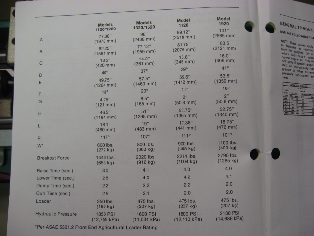

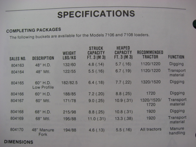

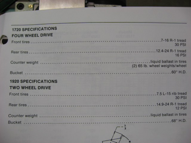

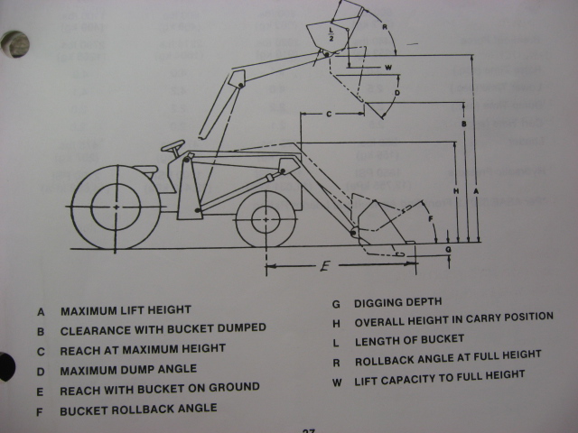

I don't know which was more confusing, correcting brightness or puttin' these in a PM. No specs for 1920 w/4wd. (??) This is from NH's 7108 manual (without permission)

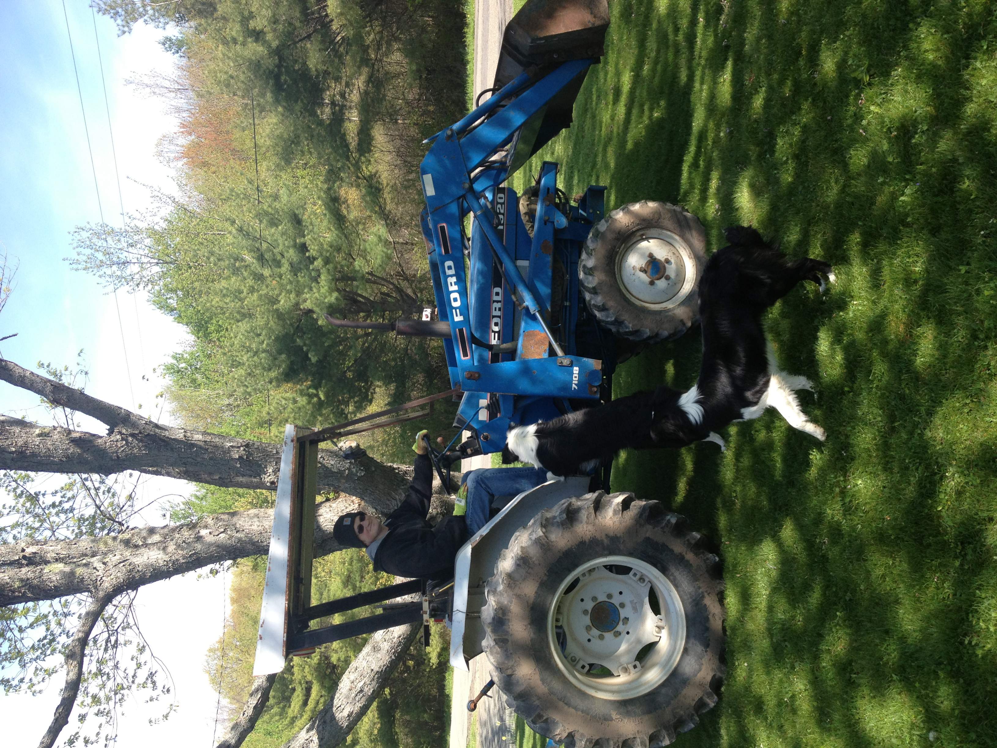

I went and looked at/drove the tractor this morning. It started right up easily after letting the glow plugs heat up for a few seconds. Ran like a top and idled down nicely. I drove it around, changing ranges and gears, forward and reverse. The clutch took a little getting used to but I was going pretty smooth after a few tries. The tractor overall is in nice shape, but there is some surface rust on most surfaces of the loader arms. The tires have some good life left and will last many years in my use I am sure.
The only issue I found was the 2wd/4wd lever...If you pulled the lever up to engage it engages, but then will fall back down on its own. The owner has a bungee cord to hold it up when he uses it currently, but I think this is something I would like to fix. Any information in the manual about an adjustment here? Both 2wd and 4wd work, but the linkage seems to be off for some reason.
The owner is the original owner, and is selling because he found a good deal on a 2120 and already has a bunch of tractors.
