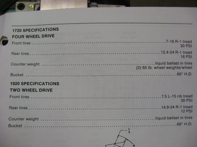

Joe, can't really say anything bad about the 7108. AFAIK the loaders are pretty much interchangeable in capacity and my '73' was put on when my 'baby' came out of freeway mowing service with MI DOT. Lacking fax I'll try to PM you some info from the manual I have for the '71'. (as in today) QA may mean a bit less without remote hydraulics for the fancier tools.
R1s should have you moving around pretty well on soggy hillsides and in 2wd much of the time elsewhere to spare strain on the drivetrain. They might wear down a bit faster on pavement over time, but lawn damage is the worst you'd get from R1s. btw: I dropped both the 1520's fronts (turfs) and landed on the fram when back-filling a neighbor's septic field. Pushed my way out backwards by digging in & curling the bucket.
I&T's "FO-46" shop service manual covers the series well and lets you compare your model's specs to the others. (see 'jmc' above) You'll see that some important mechanical stuff underneath is shared with the beefy 2120. :thumbsup: 'Range' selection isn't synchro but your 4 forward speeds are so you might be shifting on the fly without dub'l-clutching.

I don't know which was more confusing, correcting brightness or puttin' these in a PM. No specs for 1920 w/4wd. (??) This is from NH's 7108 manual (without permission)
