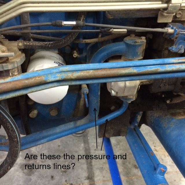

We have decided to split the tractor to check the clutch. If the clutch is bad I will order it on Monday. So expect a flurry of questions :)
1st batch:
Question 1: How do you support the back half of the tractor AND make it where you can roll the back half away?
Question 2: Front half, the oil pan looks like sheet metal so I do not think I can use that as a support point. Looks like I can use the front frame rail - how do you do yours?
Question 3:In one of the pics below - are those what the manual are calling the pressure and return lines?
Question 4: In the other pic, just confirming that those are the bolts that actually hold the halves together.
Thank you!
