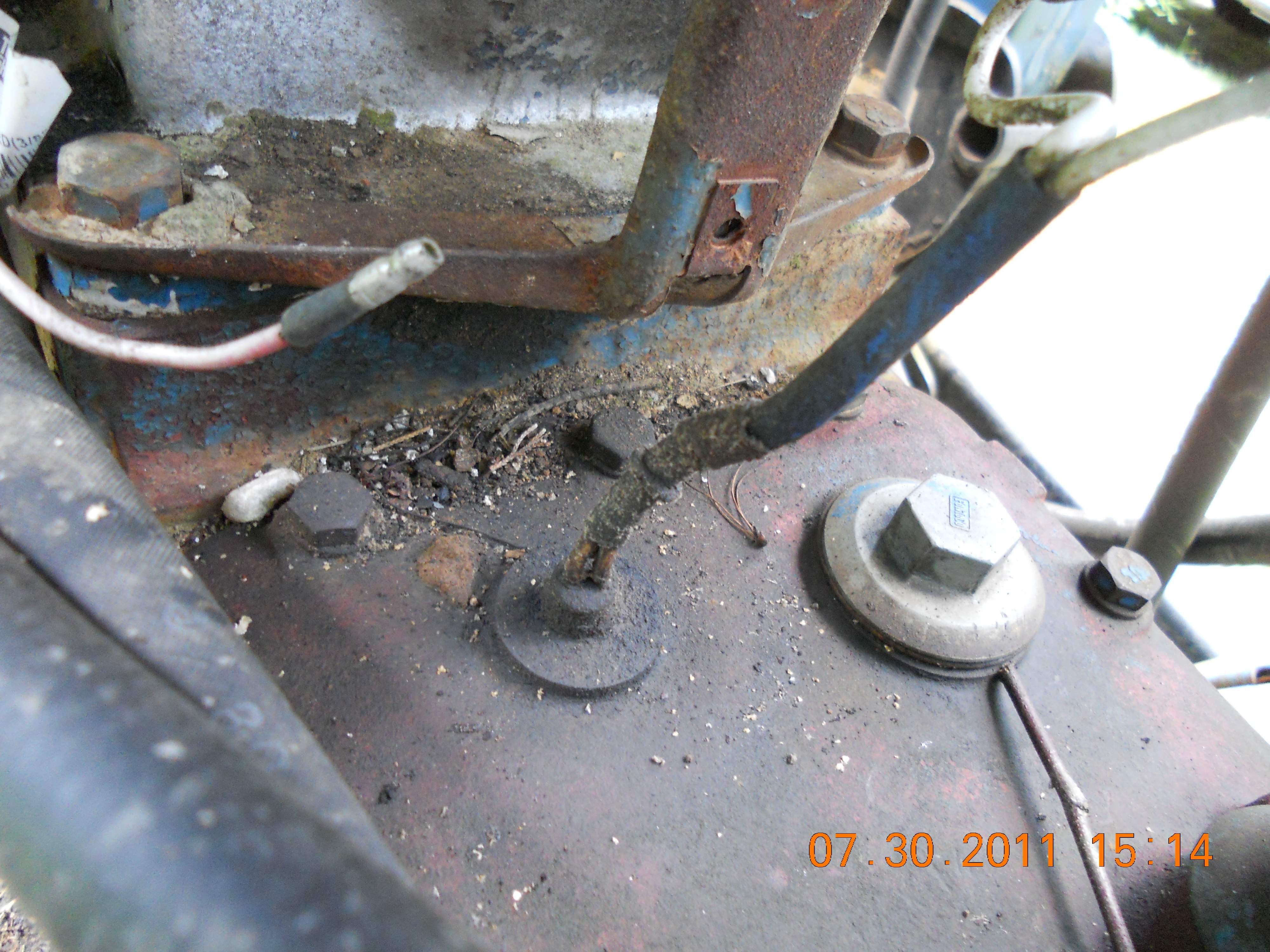

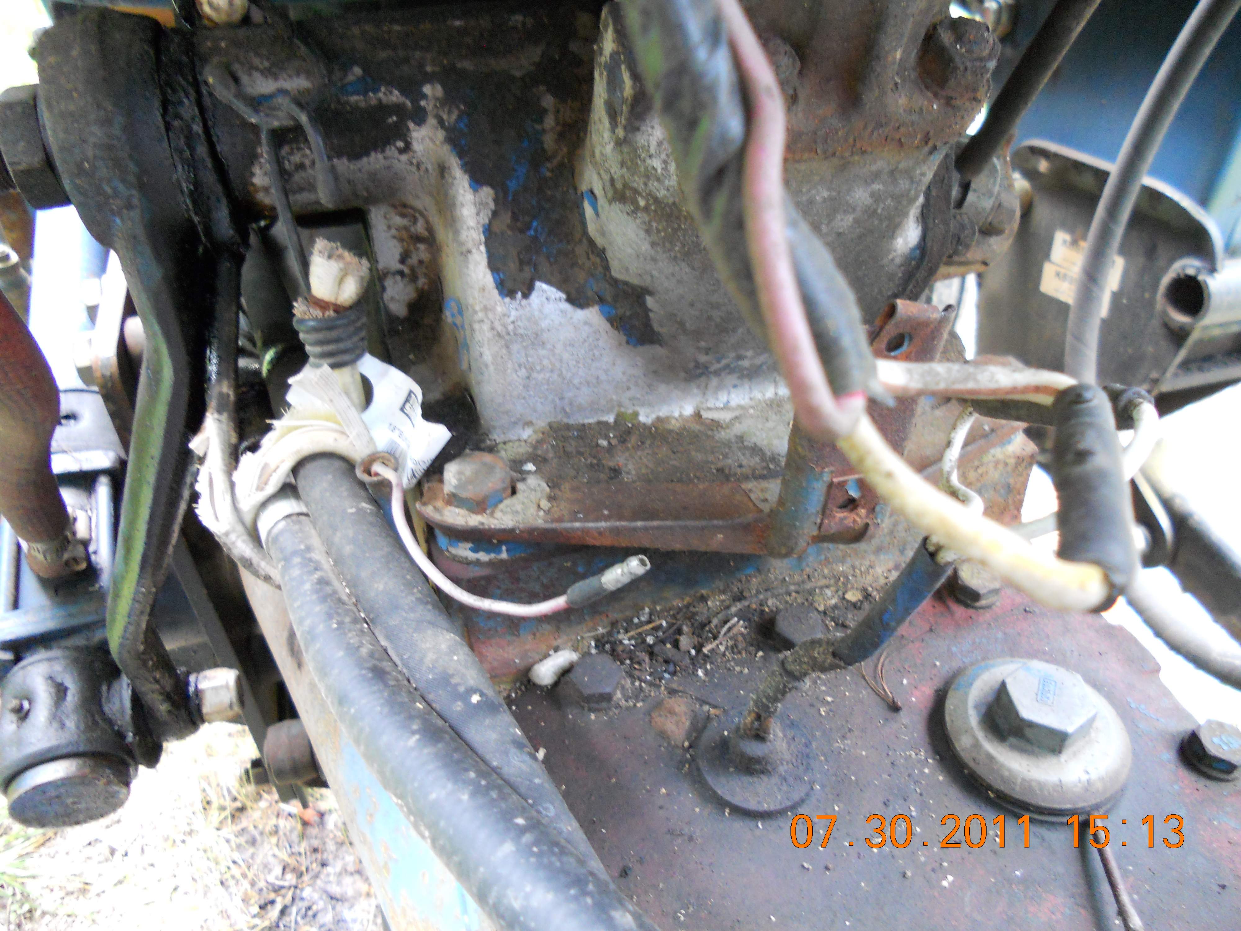

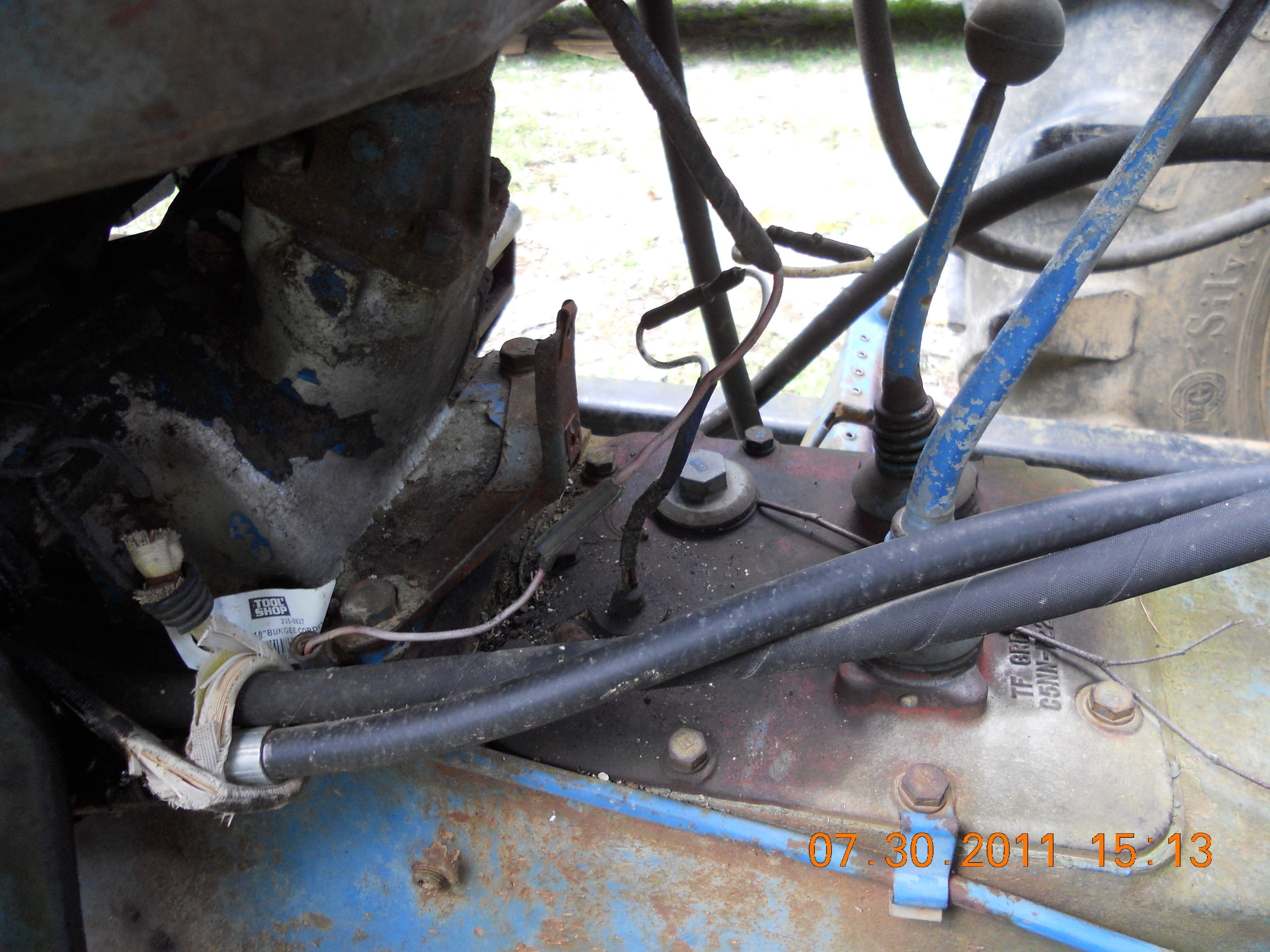

I took a few photos of what mine looks like. I appears that someone placed some sort of plug where your safety switch wires should be exiting the transmission. It's amazing what a little spray paint can hide. :D
   / Ford 2000 hi/low selector safety switch
#15
Yeah, I see what you're talking about from the pictures you sent. Mine has a rubber plug where apparently the wires once exited the transmission. I looked up under the crowling. There are no extra wires around the key switch but on the other side, there are several. I'll just have to try and pull them all down and see what I can find. If the safety switch has previously been by-passed, then the problem must be the two wires they tied together and not making good contact. What I don't understand is why it will eventually crank when I move the hi/low shifter to a certain spot. I'm still flabber gasted! Thanks to all of you for your time and effort. At least I 've got something solid to look at now whereas I didn't have a clue before. THANKS!
