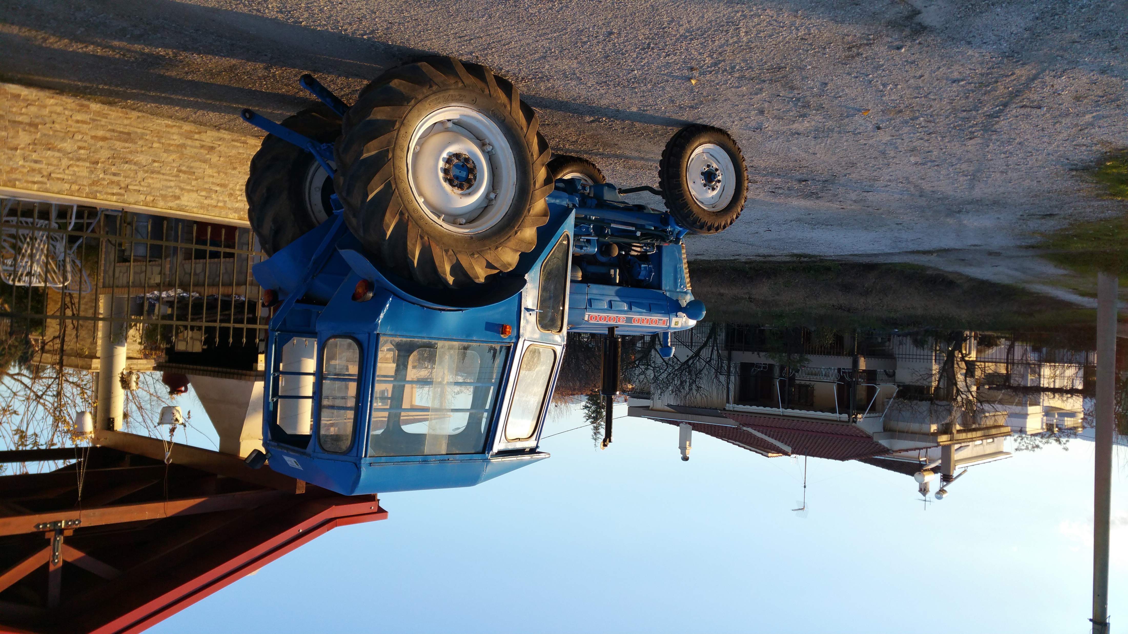

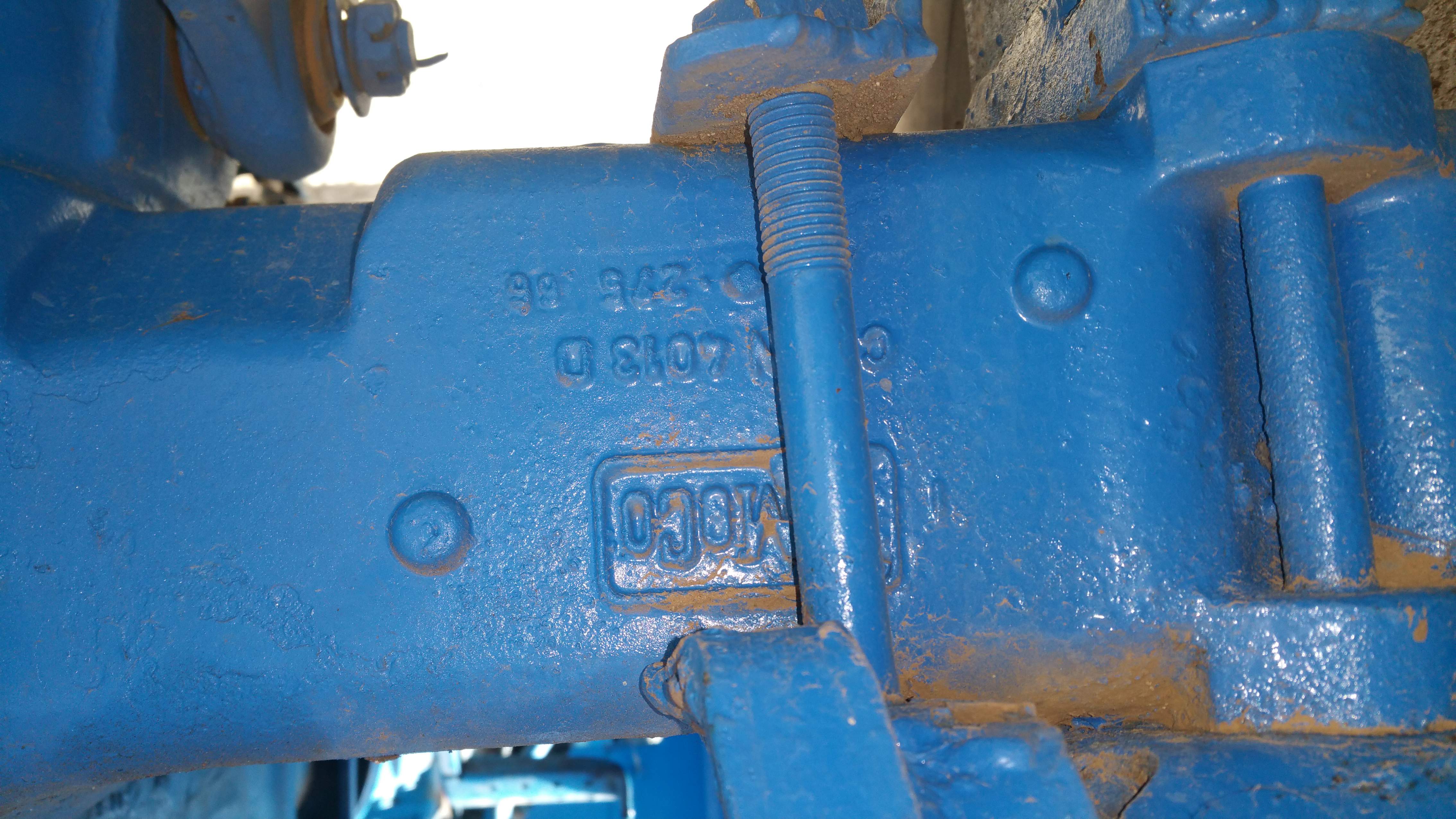

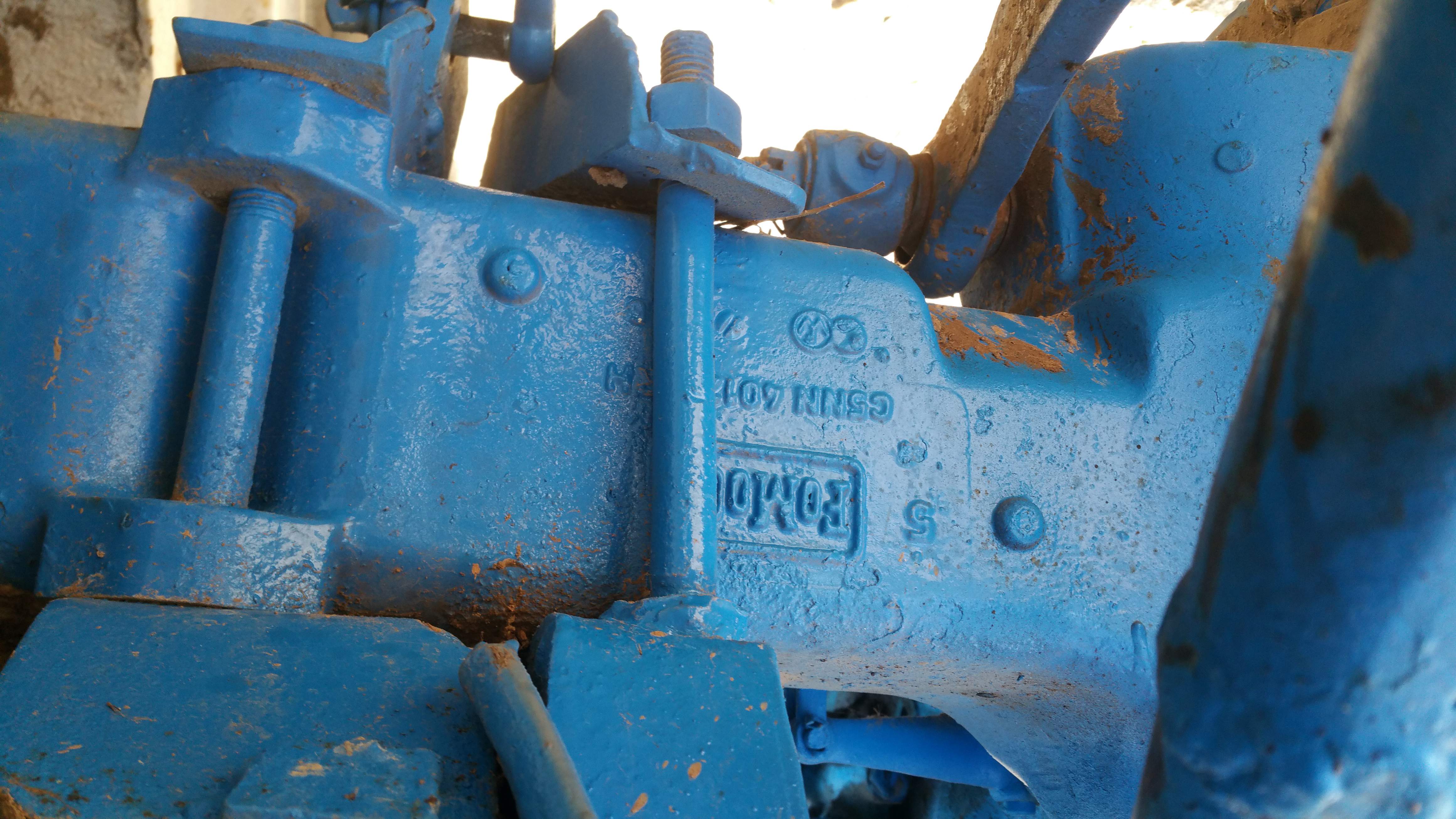

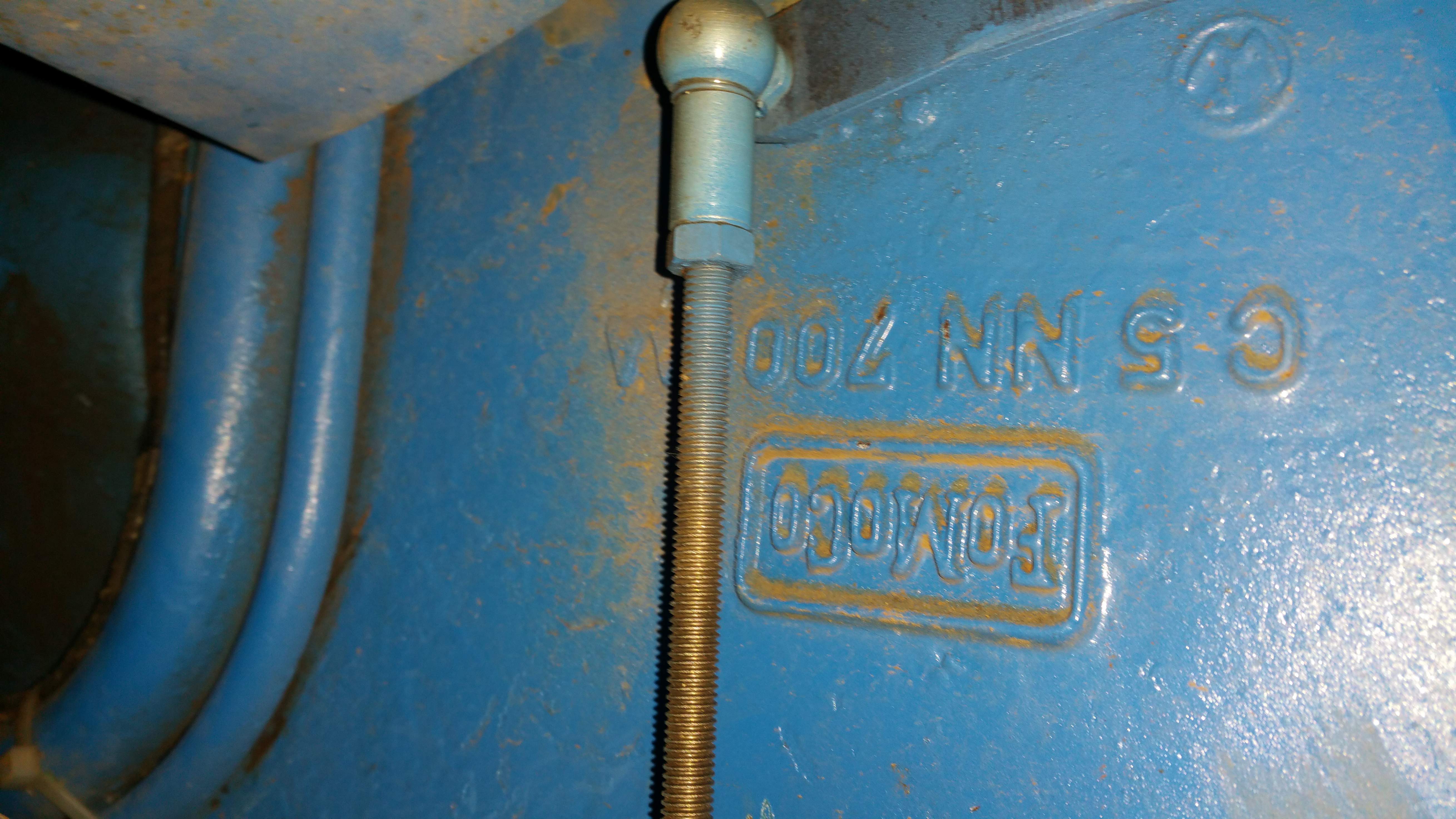

here is some pictures of rear axle 2015-01-11 12.49.59.jpg 2015-01-11 12.50.41.jpg 2015-01-11 12.38.30.jpg

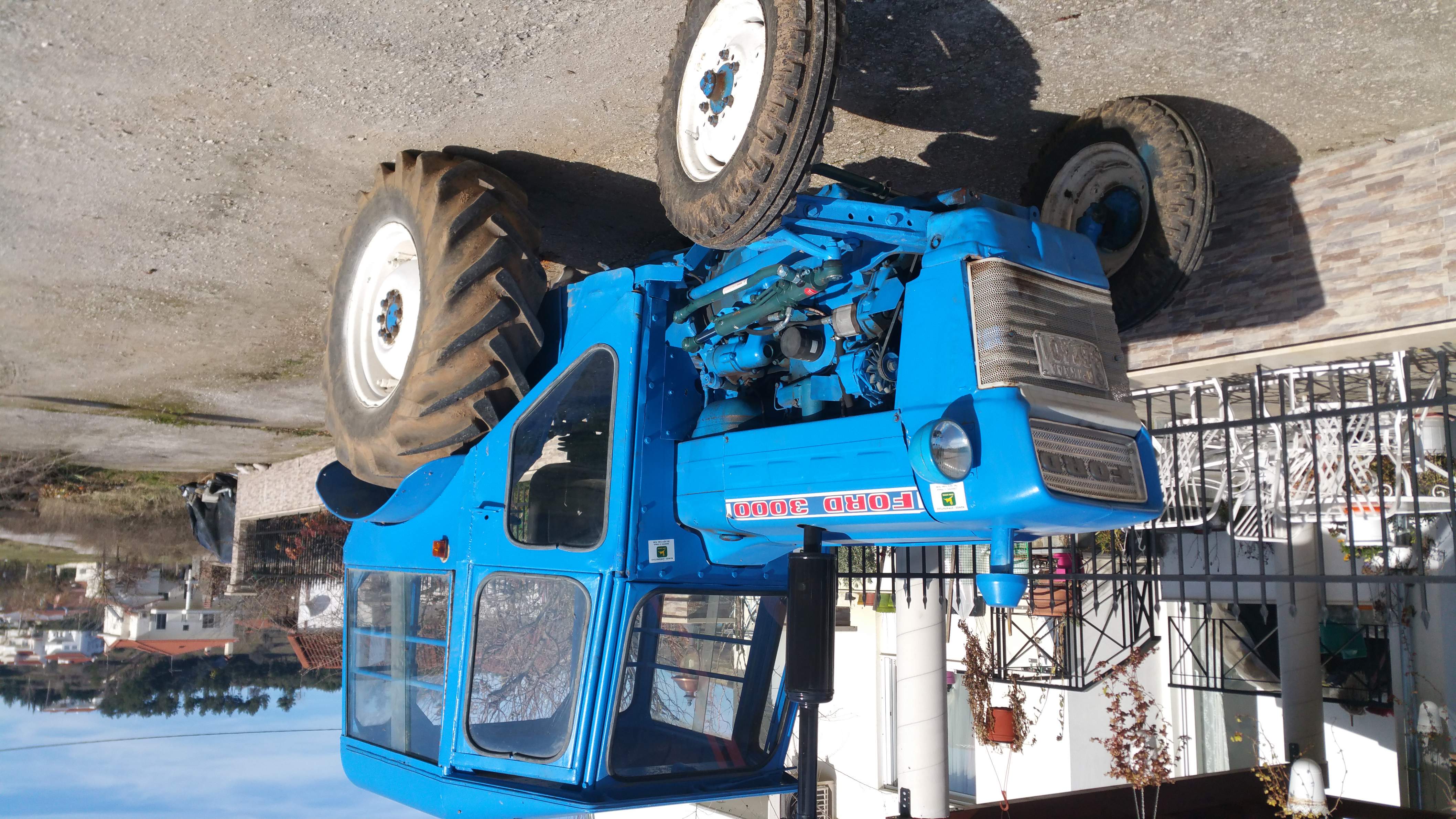

/ Ford 2000 or 3000 #9
Sheetmetal is correct for a 1966 2000/3000. Enclosed draft control spring and square rear axle housing points to it being a 3000. Would need complete correct model code to verify.

All of the part numbers on the castings are a 1965 design level. C5NN- is a 1965 Tractor Operations part number. So I'm going with Rick B that its most likely a 1966 Basildon built tractor. The Dexta/Super Dexta designations were dropped shortly after the introduction of the 2/3/4/5000 series in late 1964.

Ford 3000 Super Dexta...This is the model.Finally i found it...thanks all for help!
