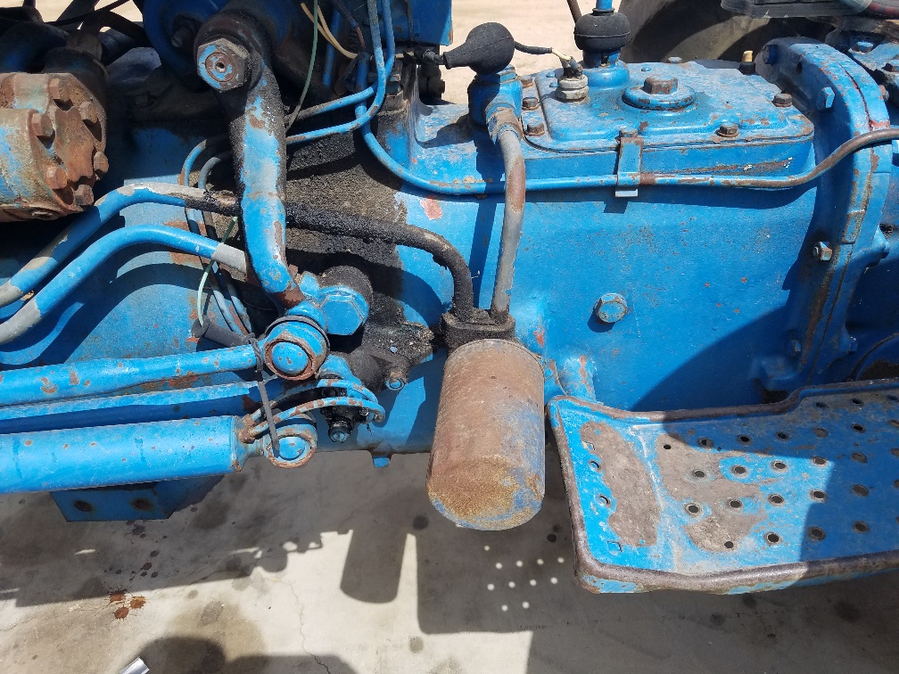

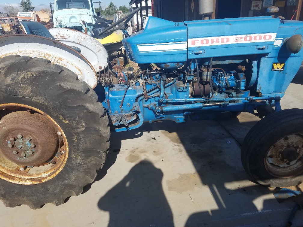

A Ford 2000 came into my shop last week and I was surprised to see that it has a factory Torque Converter transmission. My NH dealer didn't believe either and I had to send a pic to prove it . Is this thing rare or have you Ford guys on here seen an Ag 2000 with a TC???

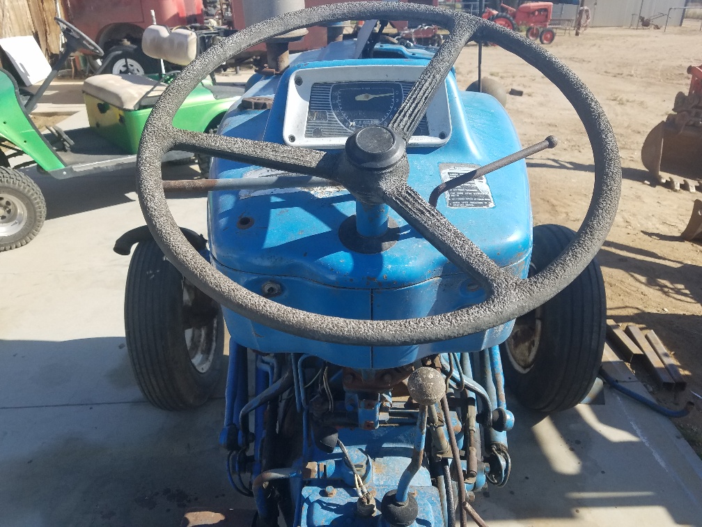

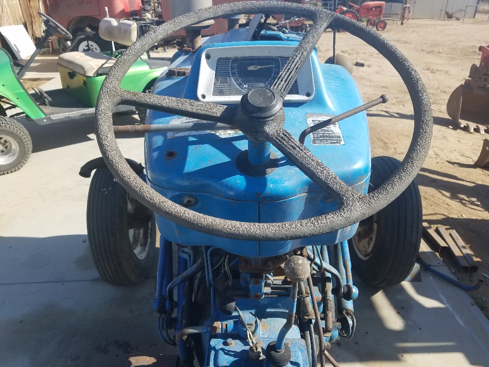

It's not a select o speed . It has a forward/reverse lever on left side of steering wheel and no engine clutch, it is a TC transmission. I rebuilt injection pump and am waiting for injectors as soon as they get here I can attempt operating it ( it has not run in 20 years and the owner is not sure if there was a problem with it). I will post a couple pics of it, seems like a real low hour tractor

No PTO on this unit. The data plate is in excellent condition and the model # is B1011F which indicates an Ag model no PTO and TC trans. Like I said in original post seems to be a rare beast.
