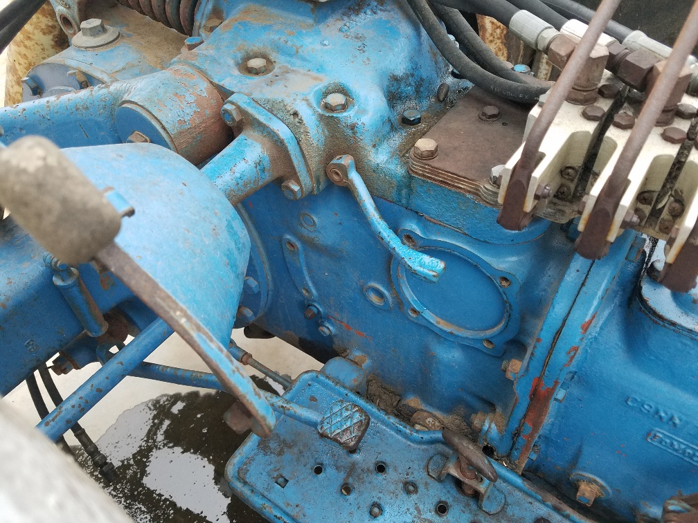

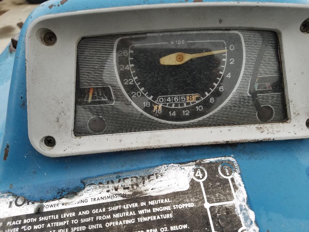

So the injectors showed up yesterday and the engine fired up pretty easily and sounded great. the hour meter indicated 465 hours and judging from what I have seen on the tractor I believed that yet I wanted to see if the tach and dash was working. after it started it was obvious that it was all working correctly and this unit only has 465 hours.
I need some help understanding what the purpose of the lever (in the pic)is. the lift will not operate if the lever is not held down, as soon as pressure is released from the lever the lift drops regardless of control lever position. does the the lever have a detent and is supposed to be down to operate the lift? what is the purpose of the lever? thanks for the help.

That lever is for draft control, might be a bad spring if you have to hold it for the hydraulics to work. The transmission set up seems like what you would find on an older (or modern) Ford backhoe, with a forward/reverse lever and a gear shifter.

The tractor has never had a FEL. The drawbar looks as if there has never been anything on it and no elongation from a pin in the hole. The 3 remotes support a Gannon box scrapper tilt, right side arm length and rippers. I ran it today for about an hour and what a blast to operate. The lever , as I found out, needs to flip up and then the lift operates as it should. Got a few more things to fix and then it goes back to the owner and I'm gonna miss this thing

As mentioned above, that lever converts the ept from normal ops to draft control ops. If in the lower pos, which is draft control, the 3pt will drop as soon as the 3pt lever is lower than the most up position. With the draft lever in the up position the 3pt lever will control the 3pt arms in the normal "position control" function.

Thanx guys, understand the draft control lever now. and all the fluids have been replaced. Changed the thermostat and hoses, fluid and filters are done. Used it to grade off some weeds and I really like this thing, having the TC trans is great in tight places. Unfortunately ( or maybe fortunately) the owner has told me that he really doesn't need it and is planning on selling it. I looked at a few different websites to get some comparisons for a price but this is pretty unique and prices were all over the board.
