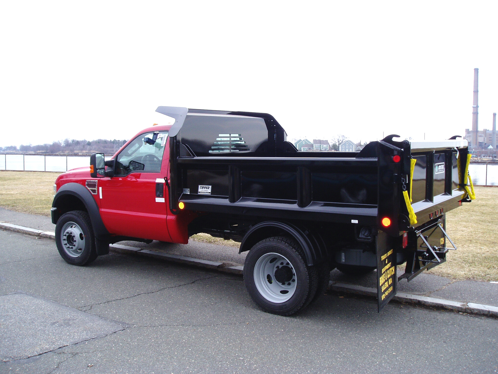

About a month ago I bought a New '08 F550 dump with the 6.4L TBD & 5-speed Allison auto with 5.88 rear end. I get about 9.4 unloaded and 9.1 loaded. Are you folks suggesting the 6.4 is junk and to be replaced in 2-yrs?
David
