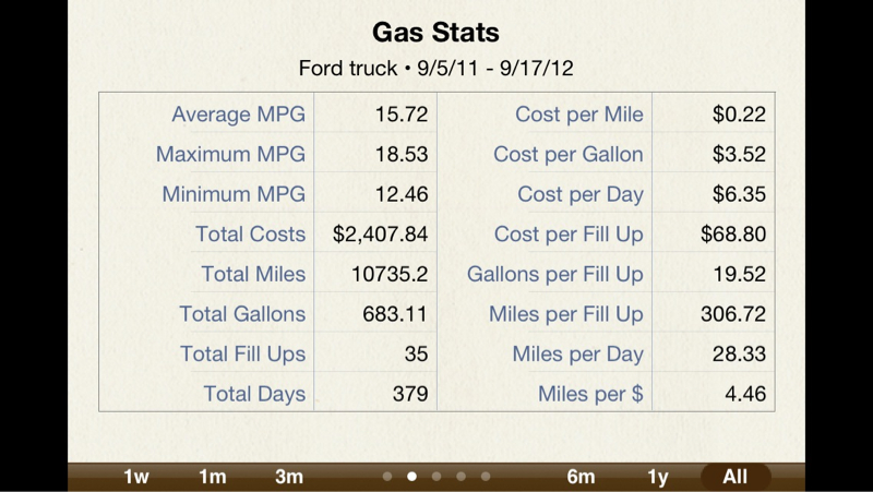

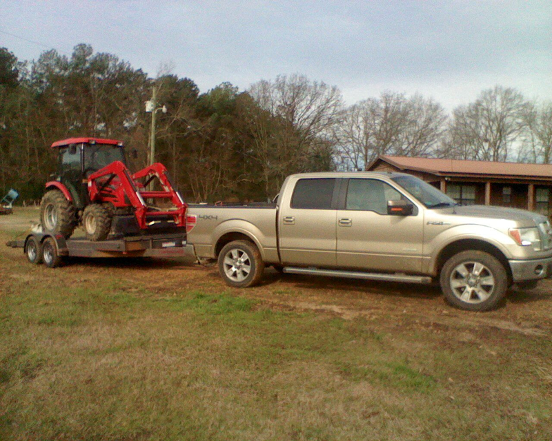

I have a 2011 screw cab ecoboost with 3:73 gears (max tow package). I get about 16-16.5 in town and 20-21 at 65 mph. I have about 11,000 miles and love the truck. I am getting about 3 mpg better than the dodge Dakota it replaced. Here are the real numbers since I started tracking. Realize I do a lot of towing. Gas was cheaper when I owned the Dakota but the ford is still cheaper per mile to drive.
