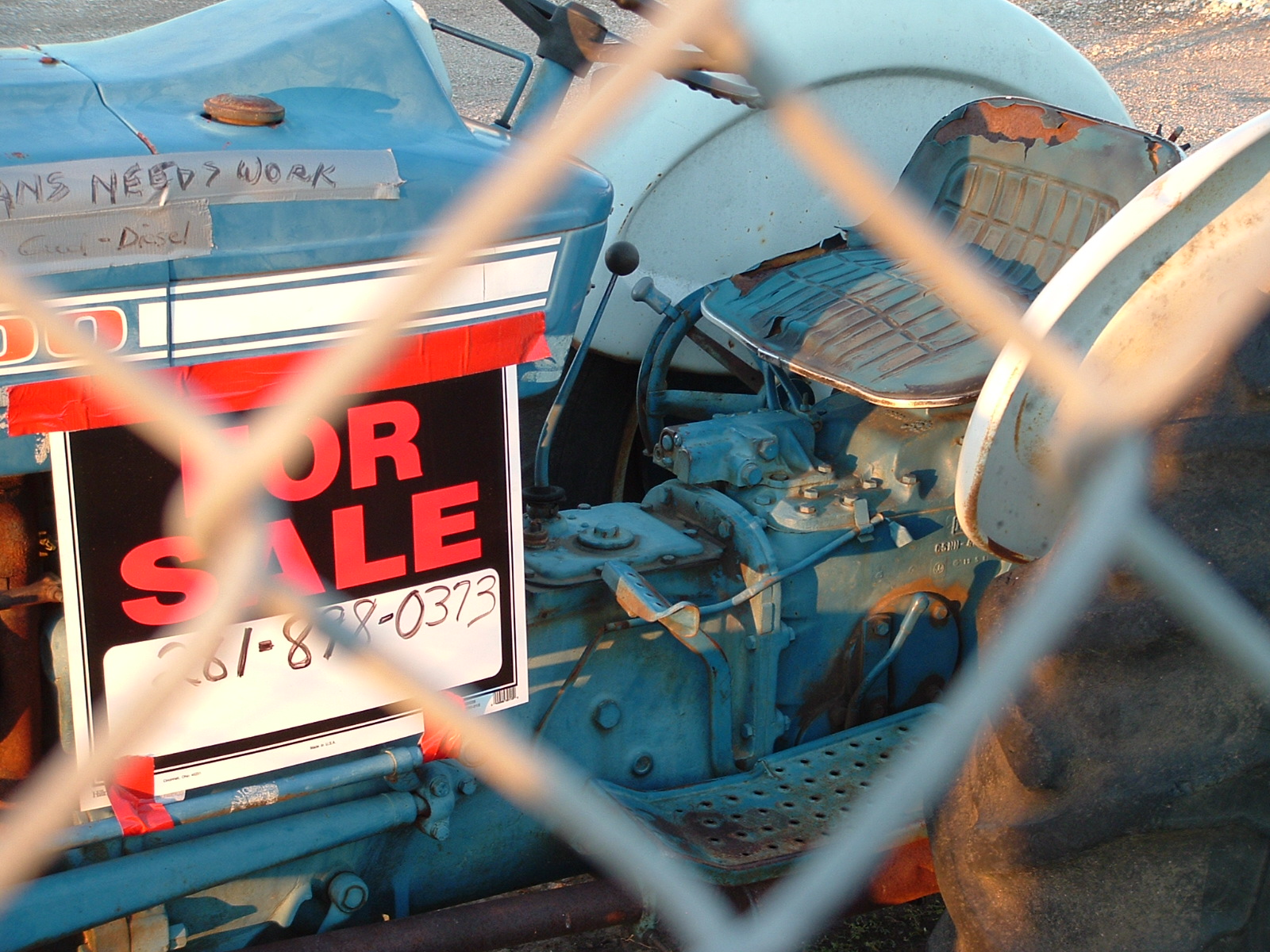

Howdy soundguy. The tractor was behind a fence so I didnt get up on it. It does have one Shifter shaft though. Here is a closeup pic of the mid section. I think its a 4 speed. I also found a picture on the New holland parts area. There was only one tranny listed with one shift handle that I could see, and it lists it to be a 4 speed. Any ID on that would be appreciated. Thanks!

4 speed, transmission PTO, manual steering. Shifter problems, gear/bearing problems. I think he's $500-$1000 over the market on that tractor. I hope the rest of it looks better than what shows in that one photo. I'd want to make sure that's actually a 3000 as well. Could very well be a 2000; there were more 4 speed low-spec 2000's built than 3000's in that config. At least it isn't a gasser.
   / Ford 3000 Advice #10
Post the codes from the bellhousing aft of the starter.. that will tell you whether it was a 2000 or 3000.. etc. Considering you can get a drop in trans for probably under 1000$.. you may still be ok.. IF the rest of the tractor is in good condition..er.. or better condition than the seat anyway!
