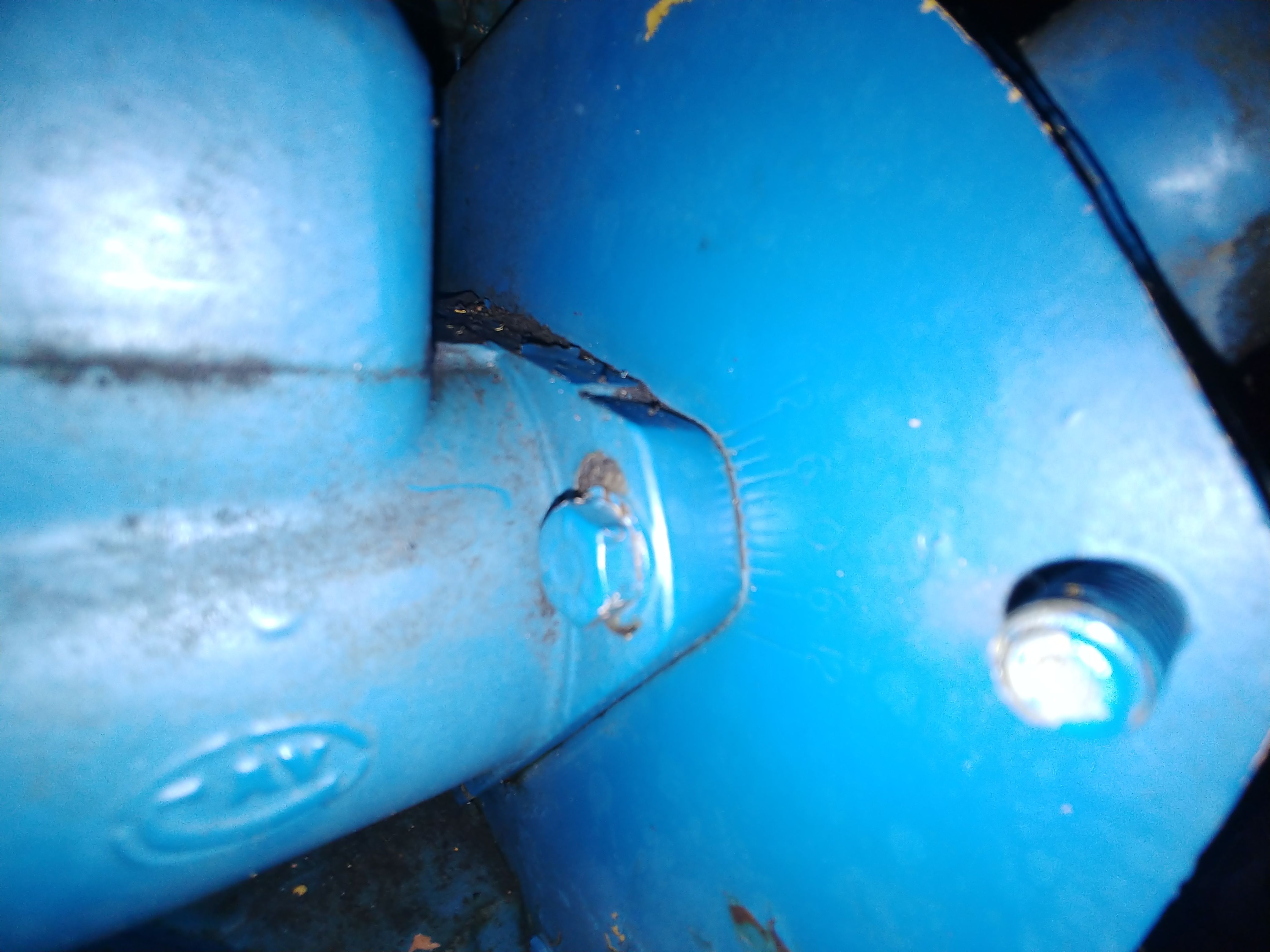

Putting my 3000 back together after burning a piston. Did not mark the injector pump lines when I tore the engine down. Need to verify the lines location on the injector pump.

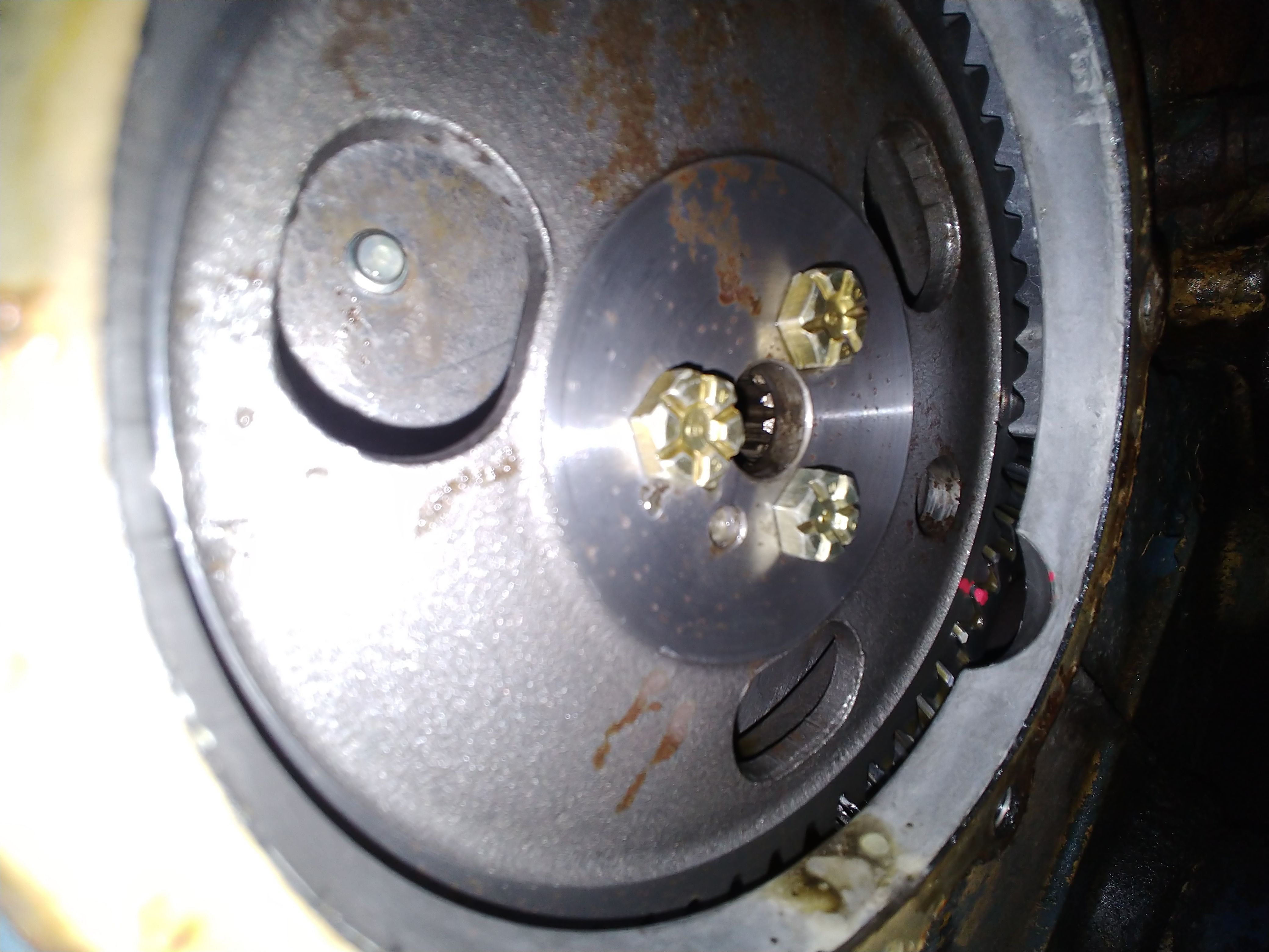

There should be a dowel in the drive gear that fits into the slot in the injection pump drive hub.
   / Ford 3000 cav injector pump W and U stamp #3
It's kinda hard to see but this picture shows the dowel between two of the bolts.

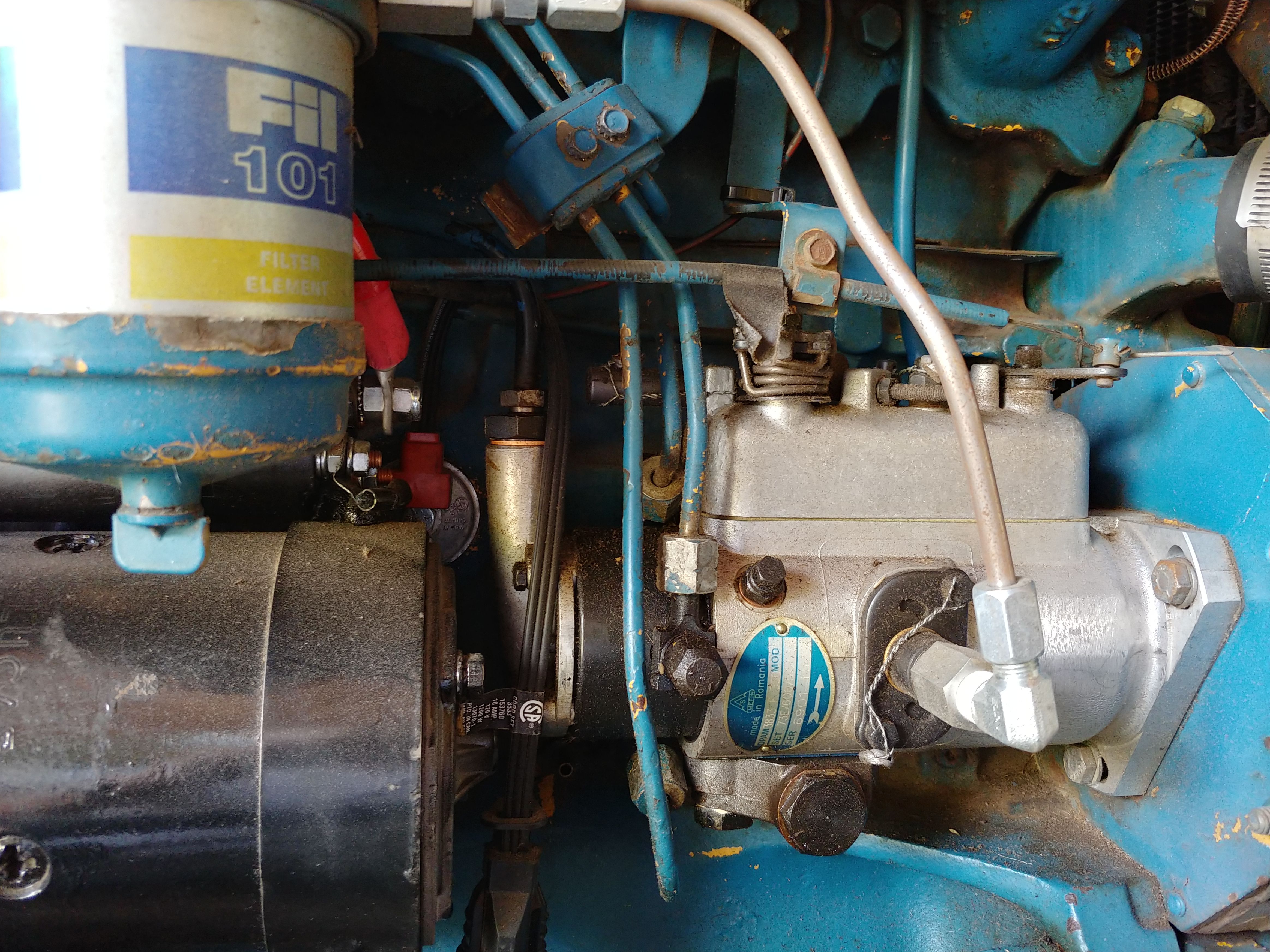

   / Ford 3000 cav injector pump W and U stamp #4
This one's hard to see also but the timing mark on the pump lines up with the 0 on the block.

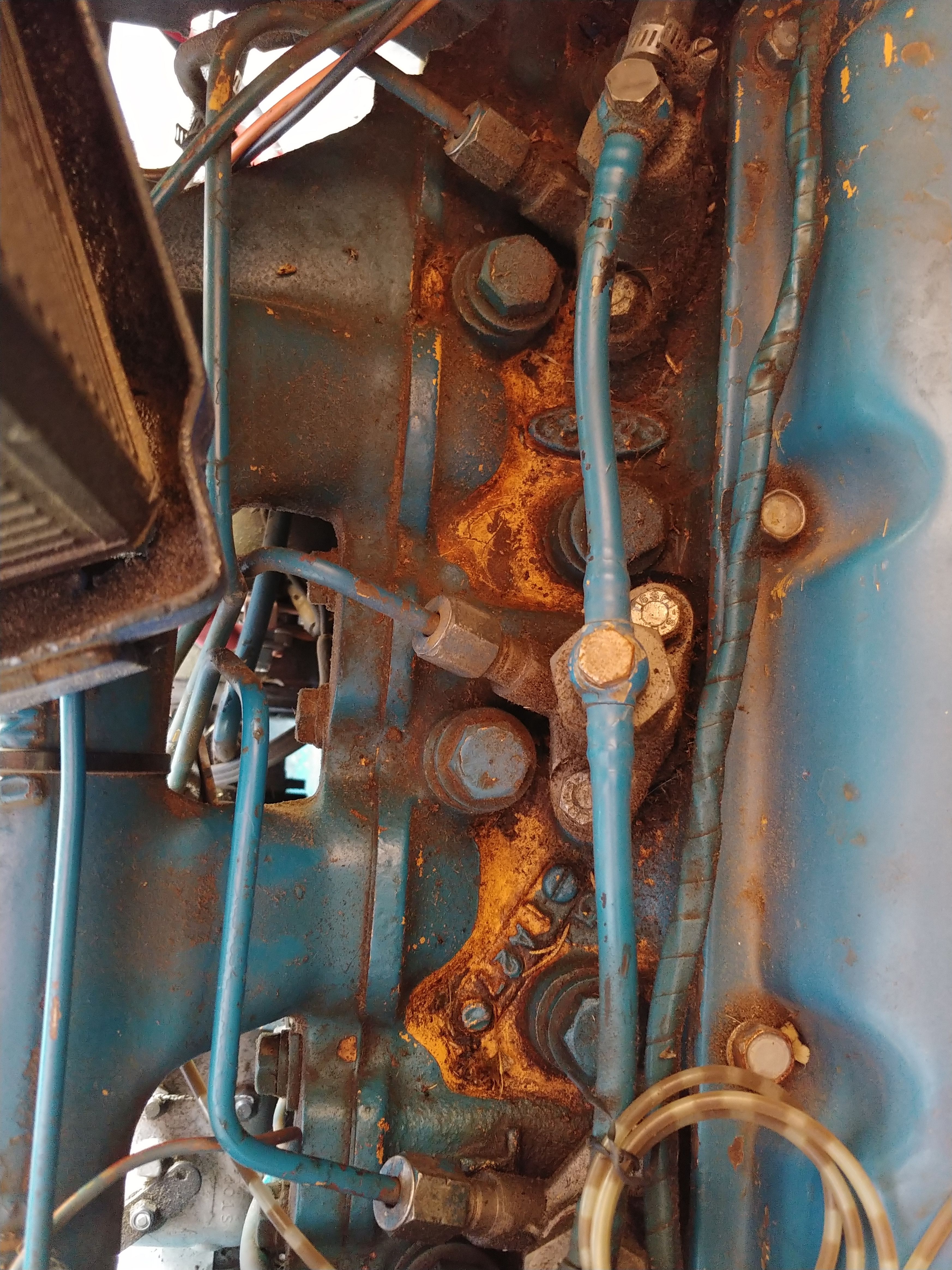

The bent lines should be an indication of what goes where..?? especially seeing theres only 3.!!

On my 1973 4000 SU, the line that comes from the top, back of the pump goes to #1, front of engine. The line that comes from the front of the pump, on the side goes to #3. The line that comes from the bottom goes to #2.
