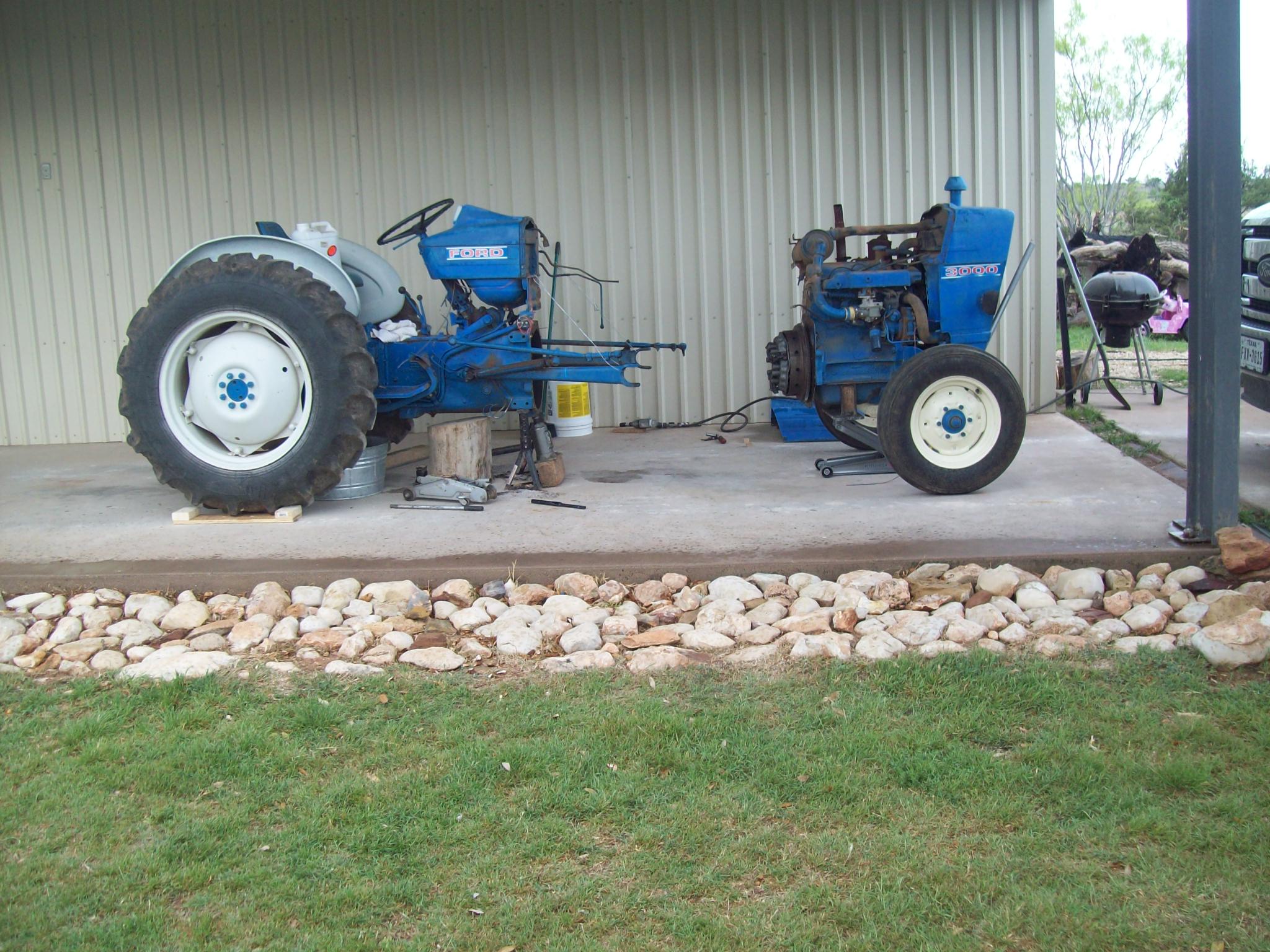

Just for fun, I was going through my photos this morning and ran across this. All in all, the repair took several hours but was not that difficult. I still have trouble getting the thing to fire and have found that voltage goes to nothing once the starter engages. It is probably something to do with how I have the switch wired in. I just jumper a hot wire to the coil to fire it up, then pull the jumper and go on about my business. I'll find a wiring diagram someday for the switch and get things hooked up right.
