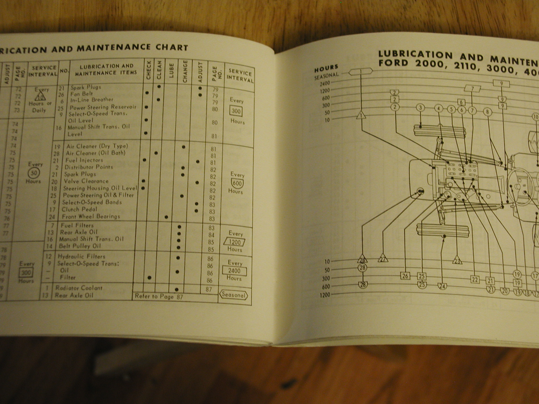

OK, I was off by a few hours, (My memory is not as good as it was in the past) the Ford Owners Manual I was referring to says front bearings are a 600 hour service.
(Its still a crappy description in the book and nothing in the service manual) I admit I know little which is why I ask here.
So for me front wheel bearing greasing is a once a year service, I think my points are still valid.

Not sure what points you are talking about. You've proved it impossible to thread a zerk into an unthreaded tapered blind hole. And you can't retain service interval information read from a manual. What Am I missing?

By the way, zerks are good when they work as they should. Best way is to screw a bolt and a fibre washer in the hole, instead of the zerk. When it is time to grease you change to a fresh zerk, grease and switch back to the bolt again. If you put zerks into the steel caps, they are not only exposed to dirt and water, you will sooner or later have one smashed or dented.
I am not sure about the need for it on a hub in normal use, better to take apart, clean and repack with fresh grease.
Reminds me of the, never used, small grease guns that came with every new chainsaw for greasing the bearing in the sword's tip. As an oldtimer said: "If you never had dirt in there before, you will get it when you pump with that thing".
   / Ford 3000 front wheel bearing zerk issue #14
600 hours?
I'd bet the grease in there is what left the factory...
Slow speeds, not much weight, probably good for another few decades.
Regrease if it makes you feel better, but probably not needed.
