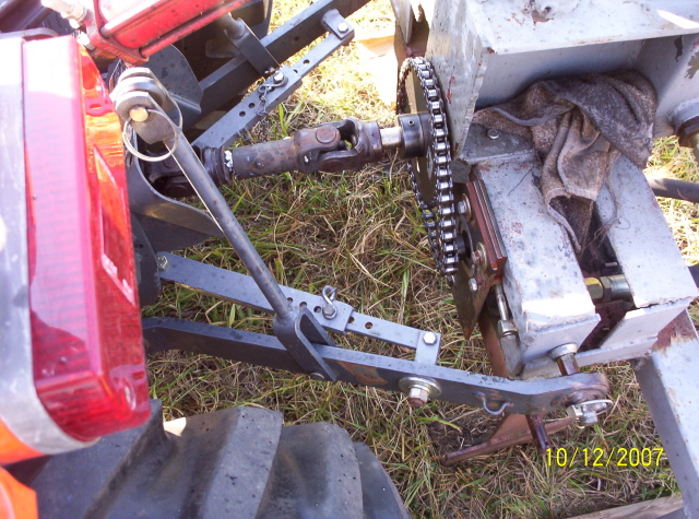

Set it up like this and you only need to run the tractor at about 1500rpm and use ever little fuel.

No other closeups that you can see how it's under the legs and the pump. You can see the adjuster in that picture and thats about it. I can take some more if you tell me what part you want to see.

The picture appears to show about, a 1 to 6 ratio chain drive to the shaft of a high rpm hyd pump.
540 PTO rpm X a 1 : 6 ratio = 3240 rpm
Any idea of the pressure and GPM's?
The GPM's of the pump is variable based on the rpm of the tractor engine.
   / Ford 3000 hydraulic tap for log splitter #18
It's a 3.5 to 1 ratio and the psi is set at 2200. I forgot to look at the spes, on the pump. It has 1" in and out ports so you can just about guess. When working by myself I run at 1500rpm and if I fell good I'll go up to 2000rpm. If I have a helper I'll take her to 2200rpm. With engine wide open it's way to fast.
