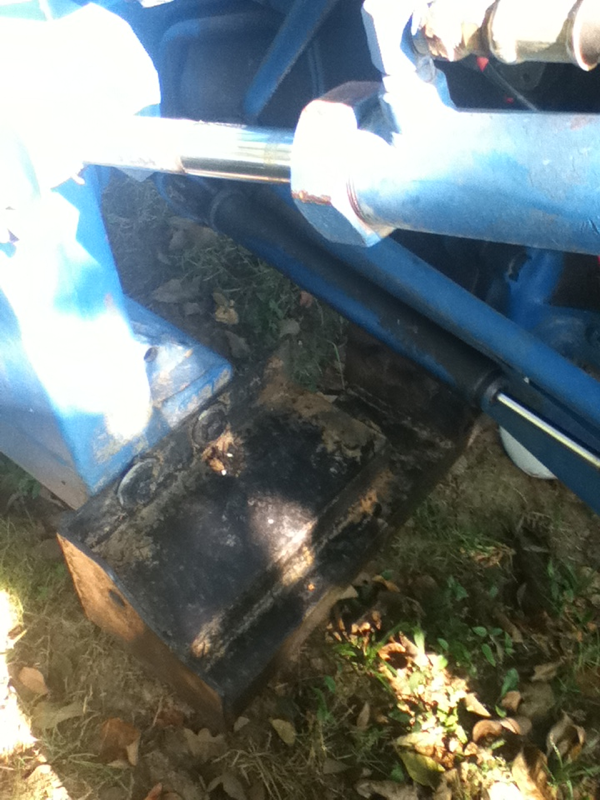

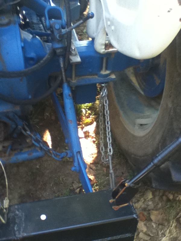

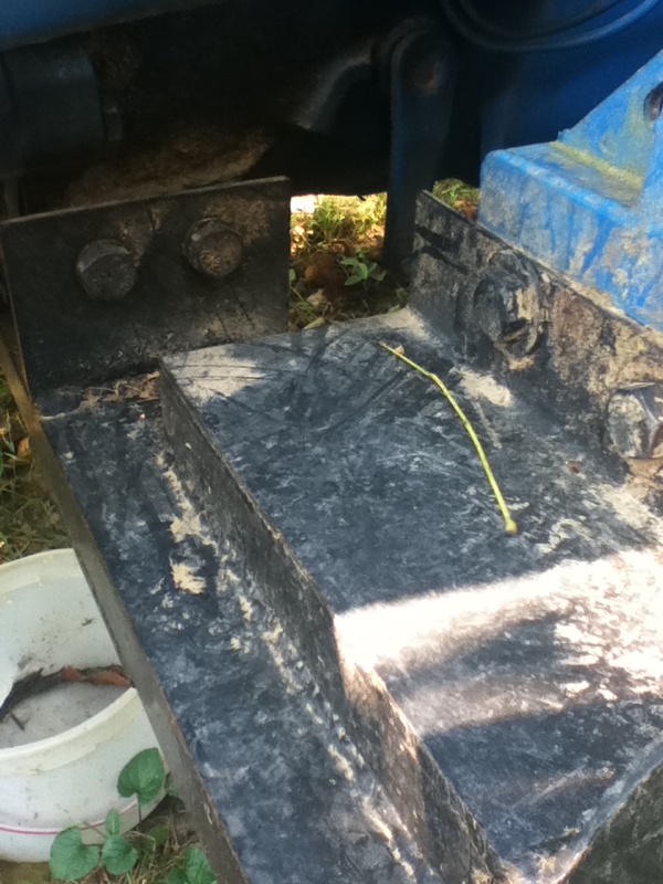

I have a 74 ford 3000 with a case front end loader. Had to fab all the bracket for bellhouse and rear axel hook up. Have not had any front end trouble as of yet approximate 5 years use on it. Will post some pics tommorow
