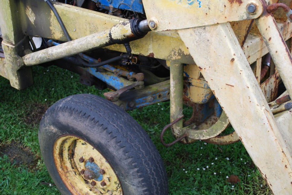

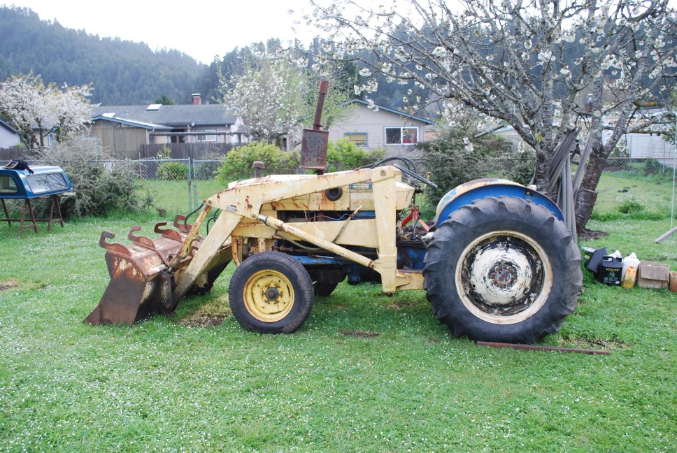

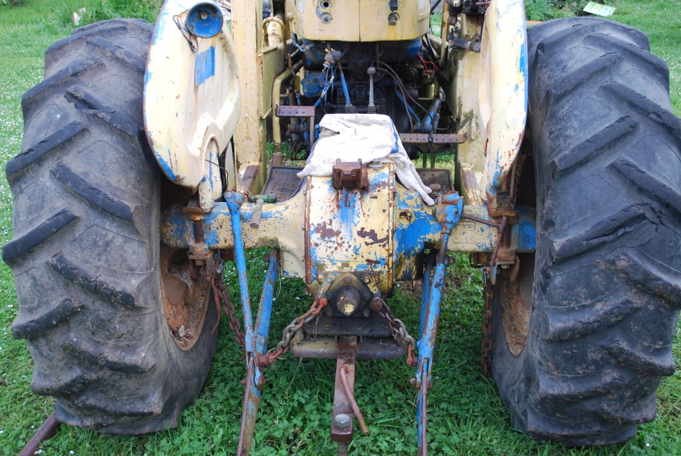

Post the pics of the front and rear axles
soundguy
   / Ford 3000 Model Year?
Finally got some pics, looks a little rough but the motor and loader run great. We have the lift off and ordered gasket and o-ring kit, o-rings are shot, but everything else looks good. Thanks for all the help, David

   / Ford 3000 Model Year? #9
Deffinately a light duty front axle like an ag machine.. and outboard breaks.. so not a 4000su.. and not something like a 3400/3500 industrial.
My guess is the backwards d is really a backwards C.. and then that makes it all fit, as a 'c' meanse 4-68+.. and that jives with the 71 model year in the date code.
On fords we frequently see backwards stampings.. and letters used as numbers.. I and 1 seem to be their favorite swap as well a b and 6.
soundguy
