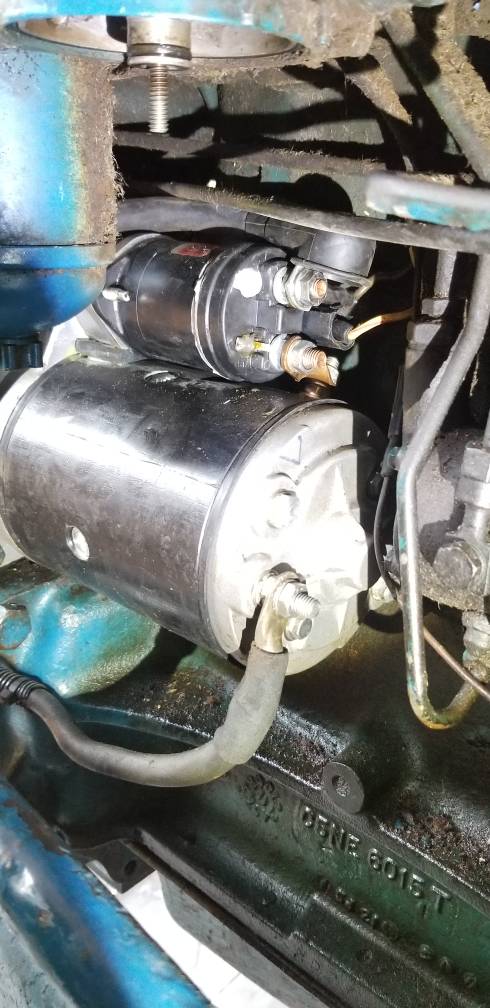

A couple of pictures of the new starter and how it is wired. 20180825_145808.jpeg20180825_092729.jpeg

I watched the video. I could hear the way it's banging in gear. First thing I would do is try and turn the crank by hand. The Bendix sounds like it's being thrown out and hitting the flywheel with a good amount of force, but no cranking. Do you have an amp probe? Is the battery cable getting hot while cranking? What do YOU think caused it to stall? You think the load was too great? Did it stall abruptly from hitting something? What is the oil level and condition?.. and coolant level.? Was it running hot when it stopped running? What's your battery voltage at? Are you trying to crank it over with the PTO engaged? Need just a bit more information before coming to an accurate diagnosis, but I truly hope we get you back up and running.

Yeah - test the battery - a Load test would be more definitive than a simple voltage test
If you can get a socket on the crankshaft damper bolt make sure the crankshaft is not locked.
If the engine is not stuck I would do some current checks of the main starter cable with an inductive dc amp meter while cranking.
By saying there is no heat generated while attempting to crank it sounds like a bad main cable or termination That also includes the - cable and it's termination. This assumes the battery has passed it's tests and engine is not stuck.
   / Ford 3000 won't crank to start #10
the voltage at the starter when cranking will tell you what's going on..
