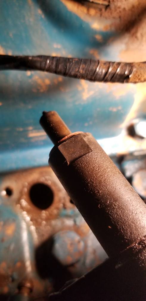

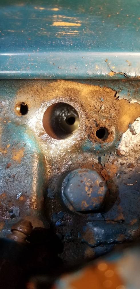

I think I found the problem: blown head gasket with water in the engine. See attached pictures of injector port #1 and the corresponding injector. Should the injector body be rusty and pitted? 20180828_070402.jpeg20180828_070058.jpeg
   / Ford 3000 won't crank to start #29
I think I found the problem: blown head gasket with water in the engine. See attached pictures of injector port #1 and the corresponding injector. Should the injector body be rusty and pitted?View attachment 568738View attachment 568739
The actual seal for the injector to chamber is the flat washer (at the bottom ) - so the injector body can get a bit rusty from water getting down the injector bore.
But if there is water/antifreeze in the cylinder / piston relief itself then that is a problem.
Is the crankshaft able to be turned now?
