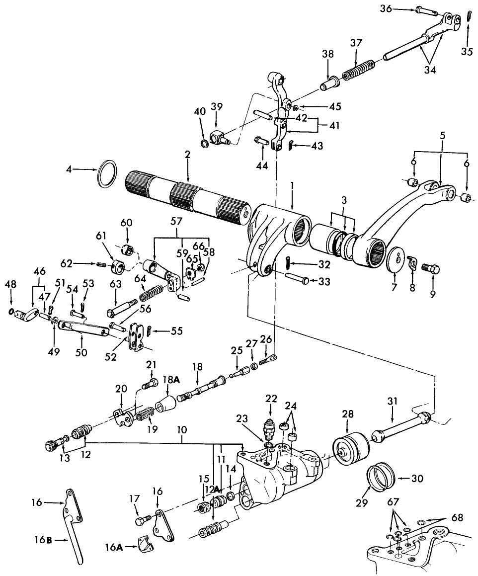

Also.. when you say 'the lift hyd. cylenders " you are speaking plural here. Ther eis only 1(single) internal 3pt lift cyl. Or are you perhaps talking about external loader cyls?
In any case.. you can get the lift cyl rebuild kit at at places like your CNH dealer or
Discount Tractor Parts and Manuals for Older and Antique Tractors
If the cyl is not scored you can usually lightly hone it with a brake hone then get a new oring and backup washer ont he piston and be good to go.
The part number for the cyl assy with unloading valve is:
C9NN478F HYDRAULIC CYLINDER Cylinder Assy., W/Unload Valve, Replaces P/N C5NN478F, Includes: Ref. 11 thru 15, (Not Shown), Start Year: 01/01/1965
I'm not sure if that is still a good number from CNH.. if it is.. expect it to be a real hunk of change ($$$$).. I'd try to rebuild mine first.. or find a salvage / used one.. next.. and a new one as a last option..
In the attached diagram, part number '10' is the assy I am speaking of.
