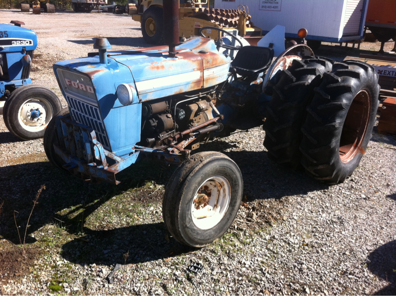

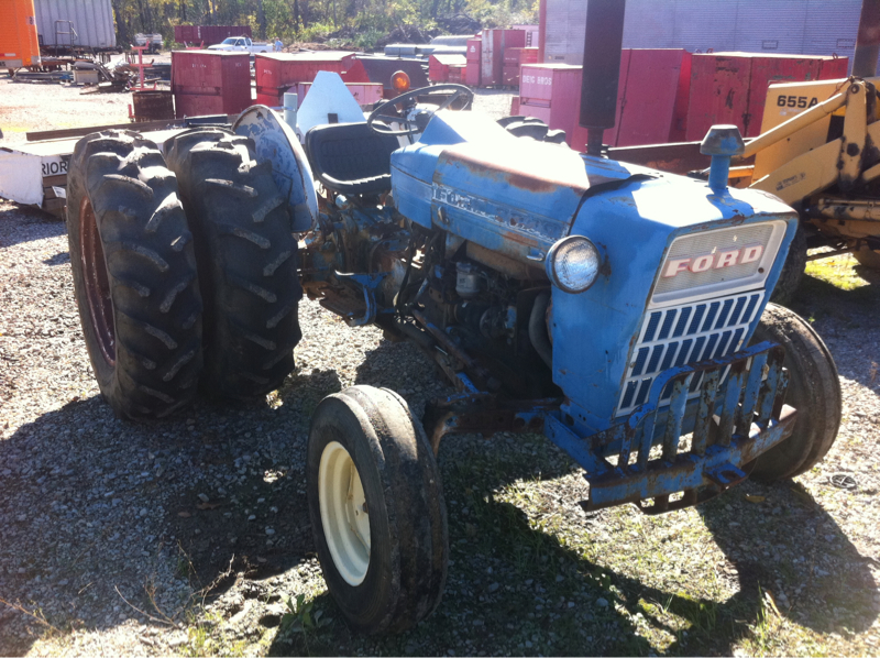

I shook the front end pretty hard and could see sloppy wheel bearing. Decent power steering leak. PTO spins when off but when you touch it it stops.
Think $2000 is a good offer??
/ Ford 3000 $? #22
pto sure should not spin when off on a live clutch model.. unless the clutch is wanting repalcement.
with all the faults.. I'd go a MAX of 2000

Looks like to me the front end is way out of alignment.
Yea Im figuring I would have to go through front end.
/ Ford 3000 $? #25
pin and bushing usually. no biggie... maybee a bolster reapir palte if the bolster got cut into..

Man that surly has more than 500 hours on it. Tires look decent but as stated I whoud say 2K max!

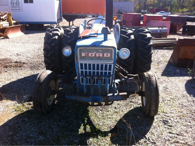

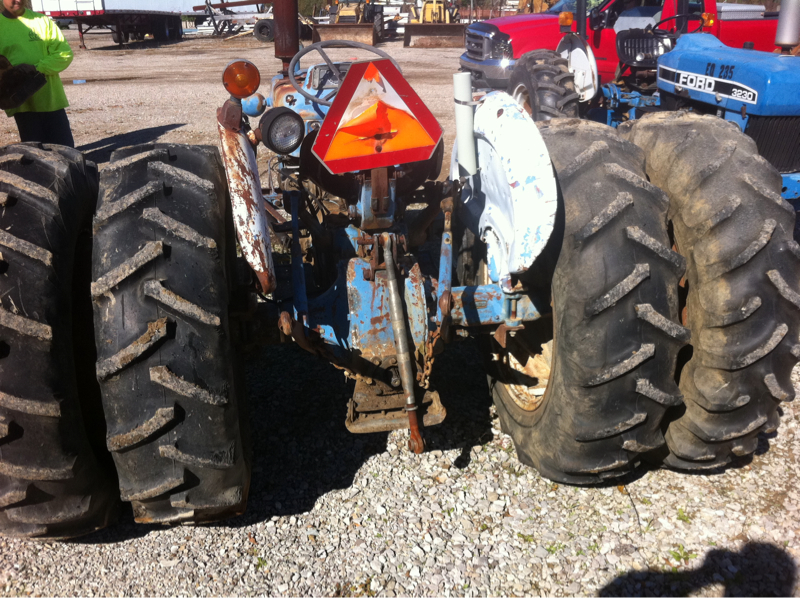

The duals are interesting. One wonders how the PO was using it. Tires loaded (probably)? If so, it has probably seen lots of FEL use. Though the rear tires are 28", the front spindles look short. I cannot tell from the photos whether it is a converted LCG. The hours on the tach are not believable. In any event, it is a late model 3000 with the right transmission and PS. It should bring $3000+ in my area if it has no known serious issues. Does it have remote hydraulics? Evidence of loader use? What is the asking price?
SDT

Tires are loaded, No remotes, and no loader use that I could see.
