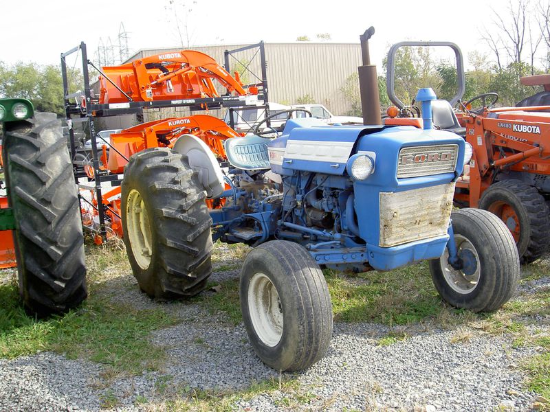

I am in need of a tractor I can use to mow my 5 acres (3 grass). Originally I planned to rebuild my dads 8N over the winter but found a crack in the block that couldn't be salvaged and am having a very difficult time finding a replacement and don't think I will have enough time to fix before the grass starts growing this month.

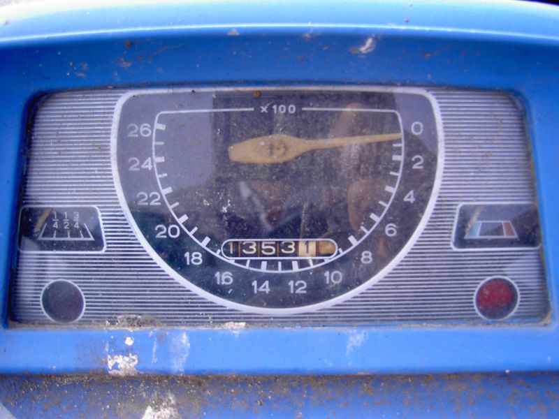

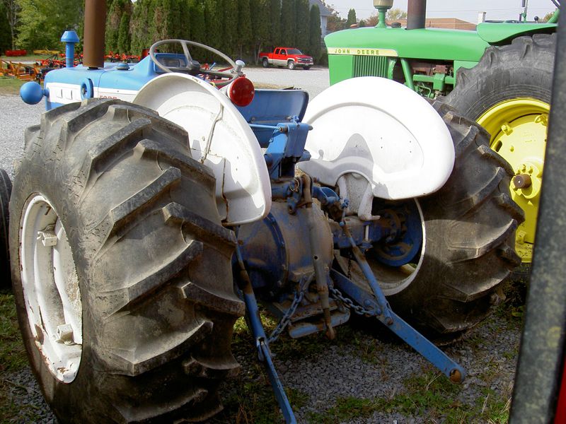

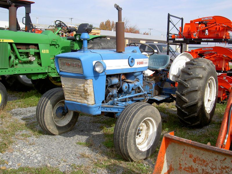

So I began the search for a tractor mainly to get me through the summer, but also to call my own and hopefully restore someday. A friend suggested a 1976 Ford 3000 he found for sale in my state. Its showing 1353.1 hours, but I am assuming theres quite a bit more based on the price of $3,550. I don't know if its gas or diesel since they didn't list any information in the ad. Is there a way I can tell from pictures of it? I have posted a couple below. From what I've read online this is a good tractor for my situation and just seems too good to be true. I'm also quite wary to be paying this much for a tractor since this a lot of money for my wife and I, and I don't want to get into a situation where it turns into a money pit.

Its kind of hard to tell from the pics, but it looks like a carb on the right side..
Although we had a 3000 (3cyl gas) back in the day and I thought the carb was on the left on it...
It was a great tractor for the size.

From the pics that is definitely a gas model. Looks to have power steering and positive traction. I would not be afraid at that price , but I doubt seriously the hour meter is working. I have a 74' 3000 gas that my grandpaw bought new in 74 that has never been off the farm to be worked on. The gas models are somewhat cheaper than the diesel model but are a very good tractor, just burn more fuel.
I would not be worried with tractor as long as it starts and runs out well. Ours has close to 10,000 hours on it(estimate) as the hour meter quit working in 78' with 1700+- hours on it.

Looks like gasser to me with power steering. Yes if it runs good and lift works seems a fair price. Diesels around here normally 5k in working order and gas 3-4.

That one is more like a 66 not a 76.
But it looks like it is a Select O Speed transmission.

Never EVER trust the hours on a 65-75 Ford tractor.
The tach and hour meter on them failed early.

ps.. I agree with ud. that has early louvered tin and early grill.

With the exception of a some of the Industrials like the 3400, 4400 and 4410
all gassers used a dry air filter with the cover in the Left hood. All diesels used a wet filter mounted in the nose like you say.
Makes spotting a gasser/diesel from a distance easy if you can see the left side hood.
