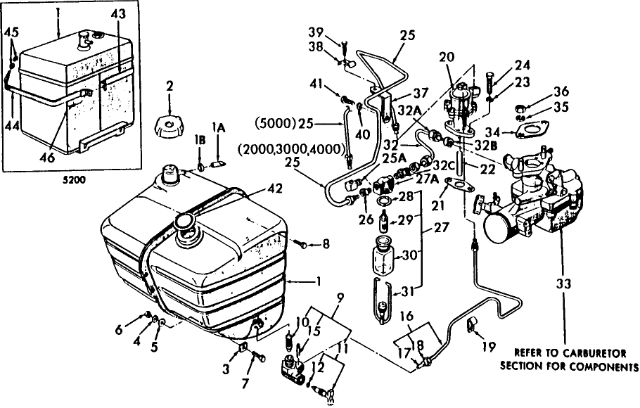

no there is a fuel pump on the front of the timing cover on the side the gen. is on
   / ford 3400 stalling when hot #22
ditto what WD said... just follow the fuel line from tank to carb.. at least that is how it should be anyway..
soundguy
here;s the exploded parts diagram so you can see the fuel routing...

I finaly got some plowing done! I replaced the coil and plugs, cleaned out the fuel tank and filters and then it wouldn't run at all. I removed the fuel line from the carb and turned the key- lots of fuel flowing. Apparently when the float was going up and down the valve pin was not going with it. Stuck in up postion (closed). I removed and cleaned, put back together and it fired right up. Put in 4 hours of plowing no problems. Thankyou to all who offered ideas and expertise. This website really helps, Thanks again, Joe
