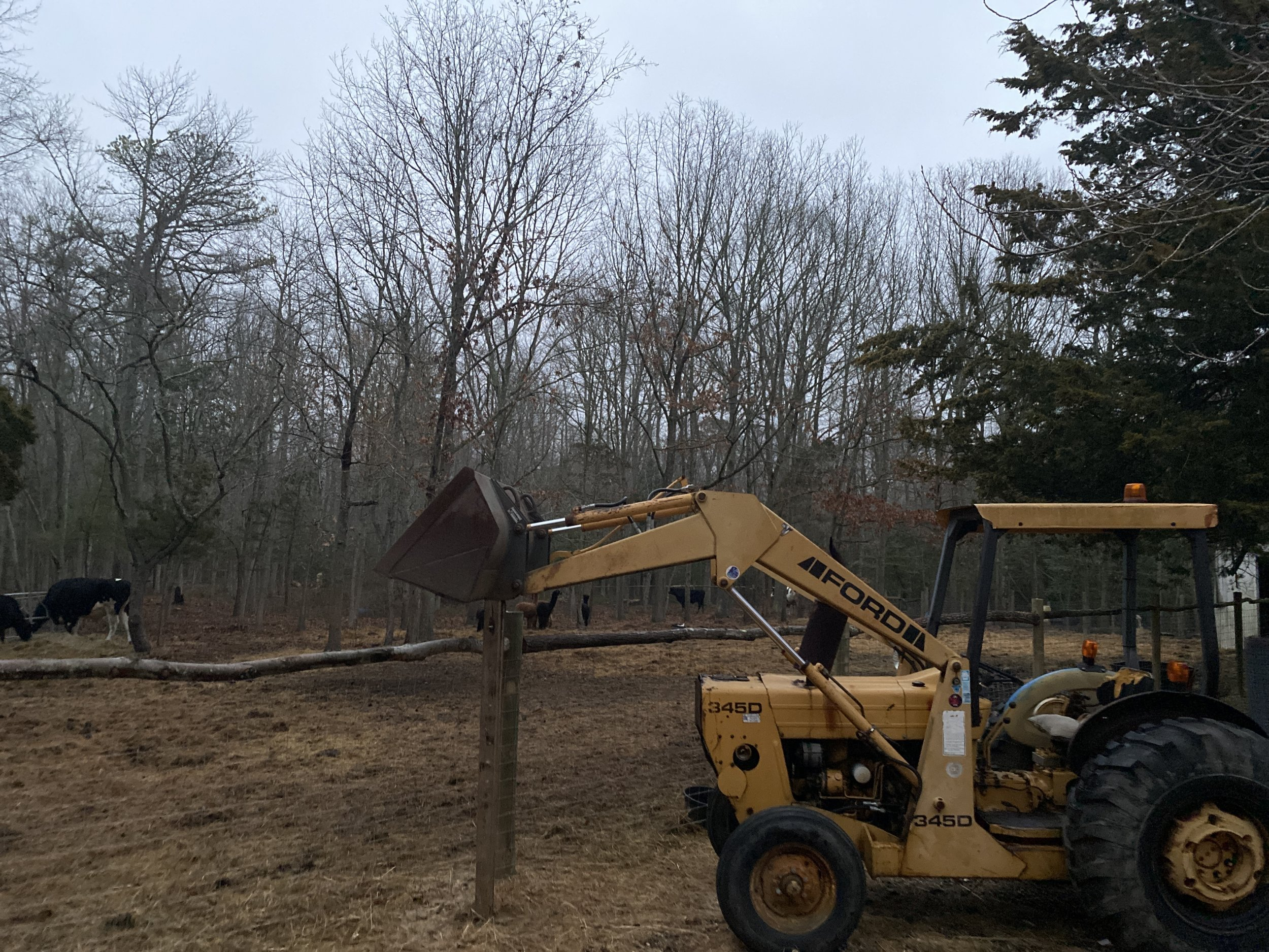

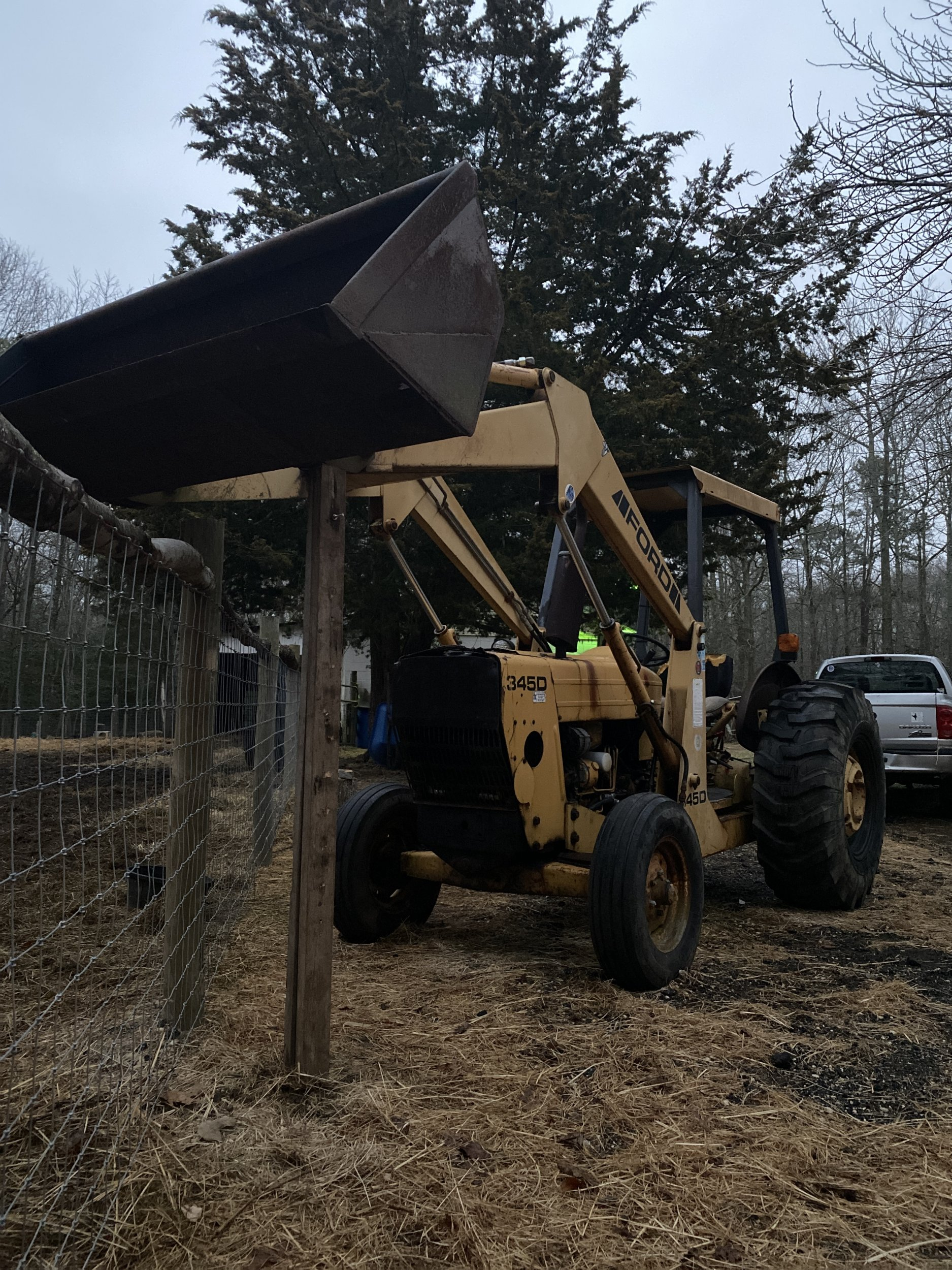

We bought a Ford 345d industrial tractor for our animal sanctuary mostly for around the farm and putting out round bales. Problem is I’ve been working on it a lot and I just can’t seem to get it running right, I’ve had it moving but with no power at all somehow some water had gotten into the hydraulic fluid and I’ve changed it out twice but there’s still some water in it. I’m not sure if that’s the reason it doesn’t wanna move or if it’s something else. Pulling my hair out over this thing for like nine months now or. We need this thing to be operational so badly and we really could use some expertise to get us on the right track.

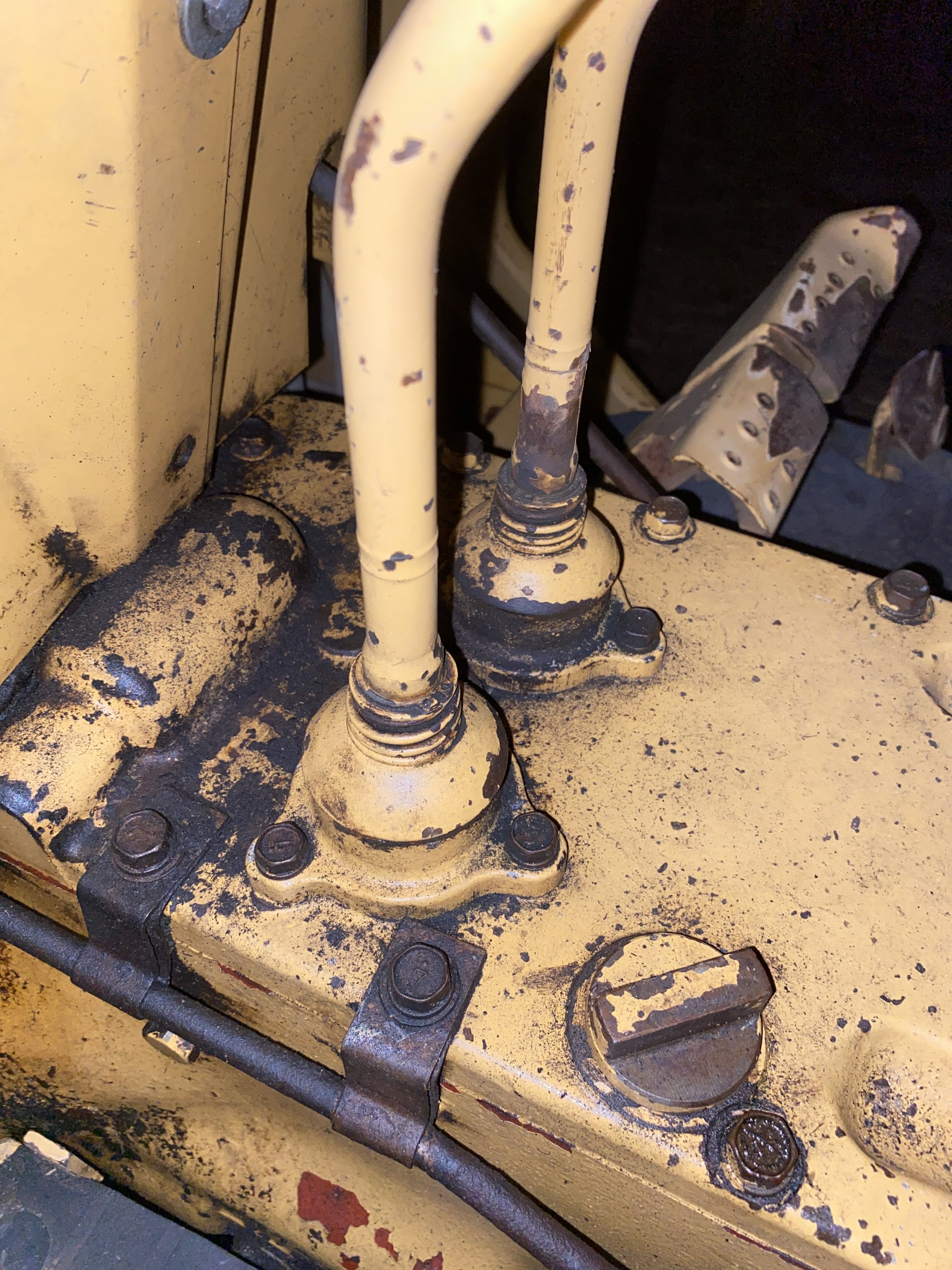

Water can be difficult to remove once inside the hydraulic system. It might require a drain and fill a few times. The important thing is to find out where the water is coming from. Just because it has a roof does not mean water can't get in through the gear shifters if there is a wind blowing. Perhaps you could post some pictures of the shifter's bases. I would certainly be checking the seals and other areas where water could be getting into the transmission.

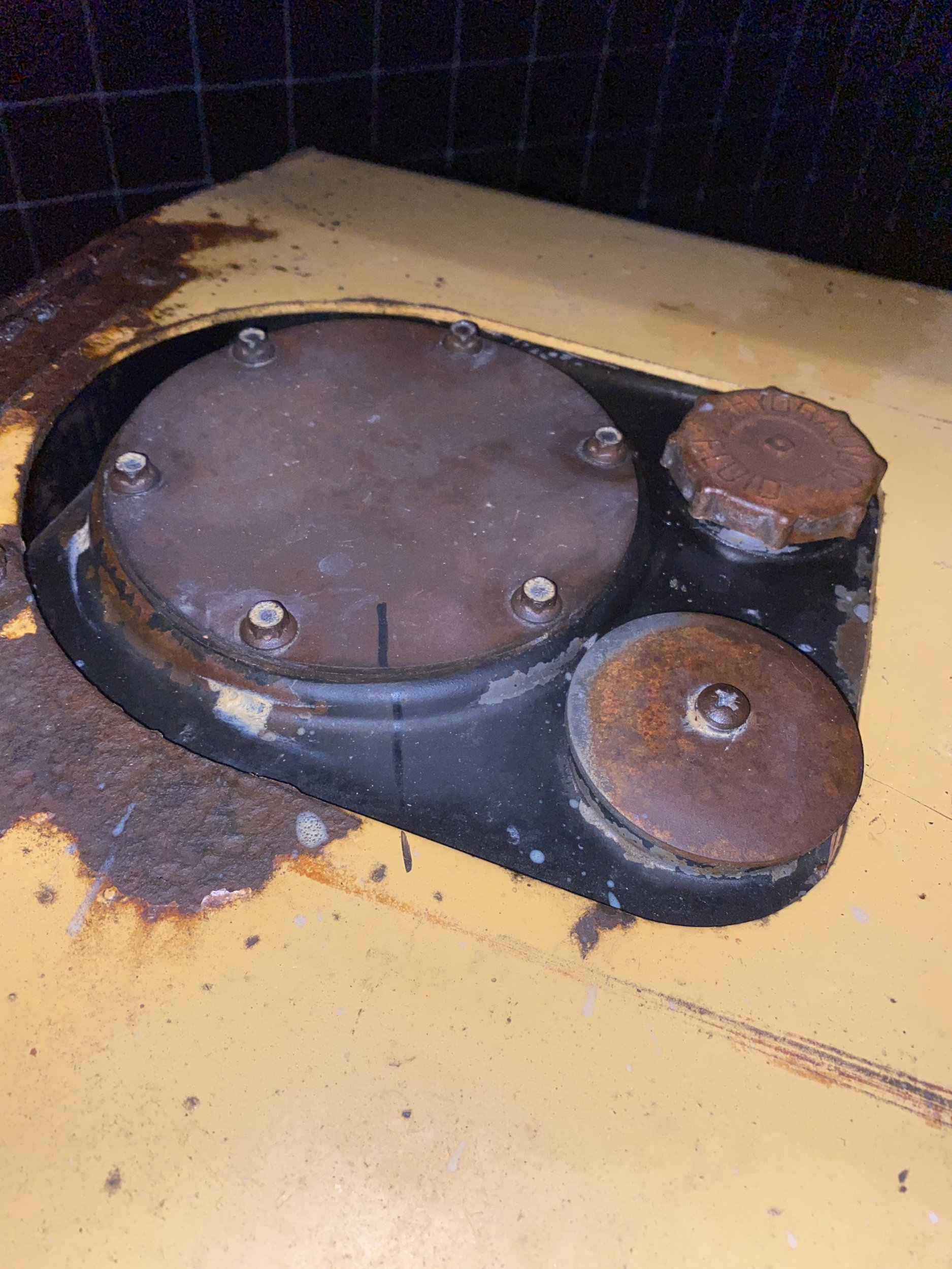

I will take pictures of the shifter base and put them on here. That’s the other part of this.. how is it getting there in the first place. The radiator fluid has stayed full and when I run it the fluid level doesn’t raise, so I assumed at first previous owner somehow got it in there by human error. Now I’m thinking it’s getting in there somehow when it rains. So I’ll post shiftbase and maybe we can figure this out. Really appreciate your knowledge and insight. And the light was on the dash when I accelerated it would come on, but light is now a aging off after change of air filter. So it was a needed change but not the culprit of why it wasn’t moving..

I changed the two hydraulic filters but one of them was for the hydrostatic hydraulic steering. There’s a little screen like a bucket with a handle inside the hydraulic reservoir. That was hard to get out so I didn’t mess with it last time any further. I’m getting ready to do a new fluid change on the hydraulics tomorrow hopefully with the loader bucket up all the way I’ll get all the water out. I’m worried that it’s not gonna fix the problem as to why the tractor barely moves
