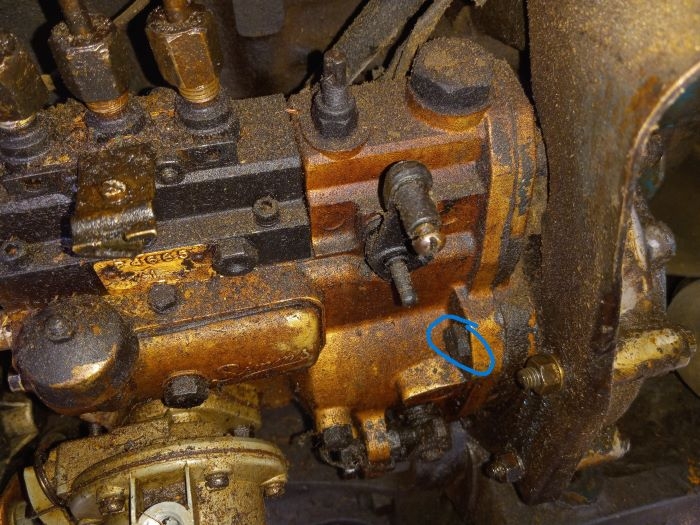

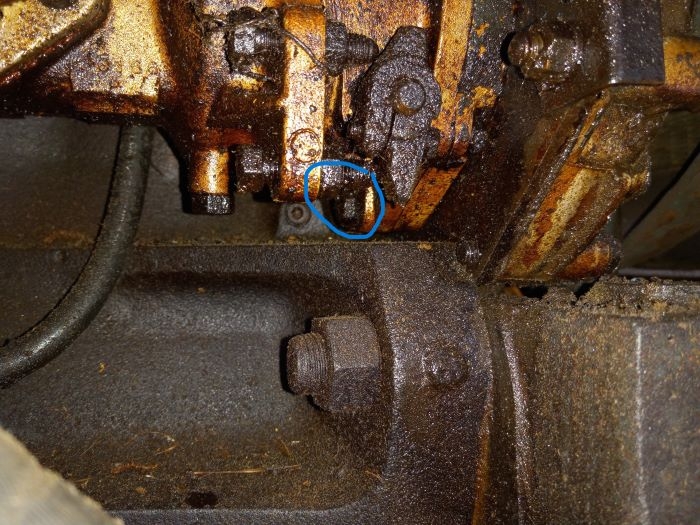

I have posted about leaks from this P4665 pump before, but the situation now is so bad that it needs a rebuild. Has anyone removed this before (front end loader attached)? Do I have to remove the radiator and manifold to get to all of the mounting bolts? I have the front and rear covers off (but not the front cover housing) and the flywheel at 19 degrees BTDC on the intake stroke and everything else disconnected. Getting wrenches on all the mounting bolts has me stuck. If anyone has done this before, I could benefit from a detailed disassembly procedure to access and remove the pump.

The mounting bolts are definitely difficult to get to. You don’t have to take the radiator out, but you do have to remove the lower radiator hose.

I have removed one end of the lower radiator hose, to get to the front pump cover. I have not removed the housing that the cover is bolted to. Is that necessary? My biggest question is where and how many the bolts are that mount the pump to the engine. I can see two: one on the right and one beneath. Is there one on the left under the manifold and in the small gap between the pump and the block? If so, the only way to get to it has to be removing the manifold. I have not raised the loader and propped it. The biggest impediment is the main frame of the loader, which doesn't move. Thanks for your help, TractorTech.

There’s another bolt on the back side of the pump, it mounts in a triangle pattern..(3)
There’s a timing mark on the pump and drive hub inside where the drive hub bolts are..at 12-1:00. (Inside)
