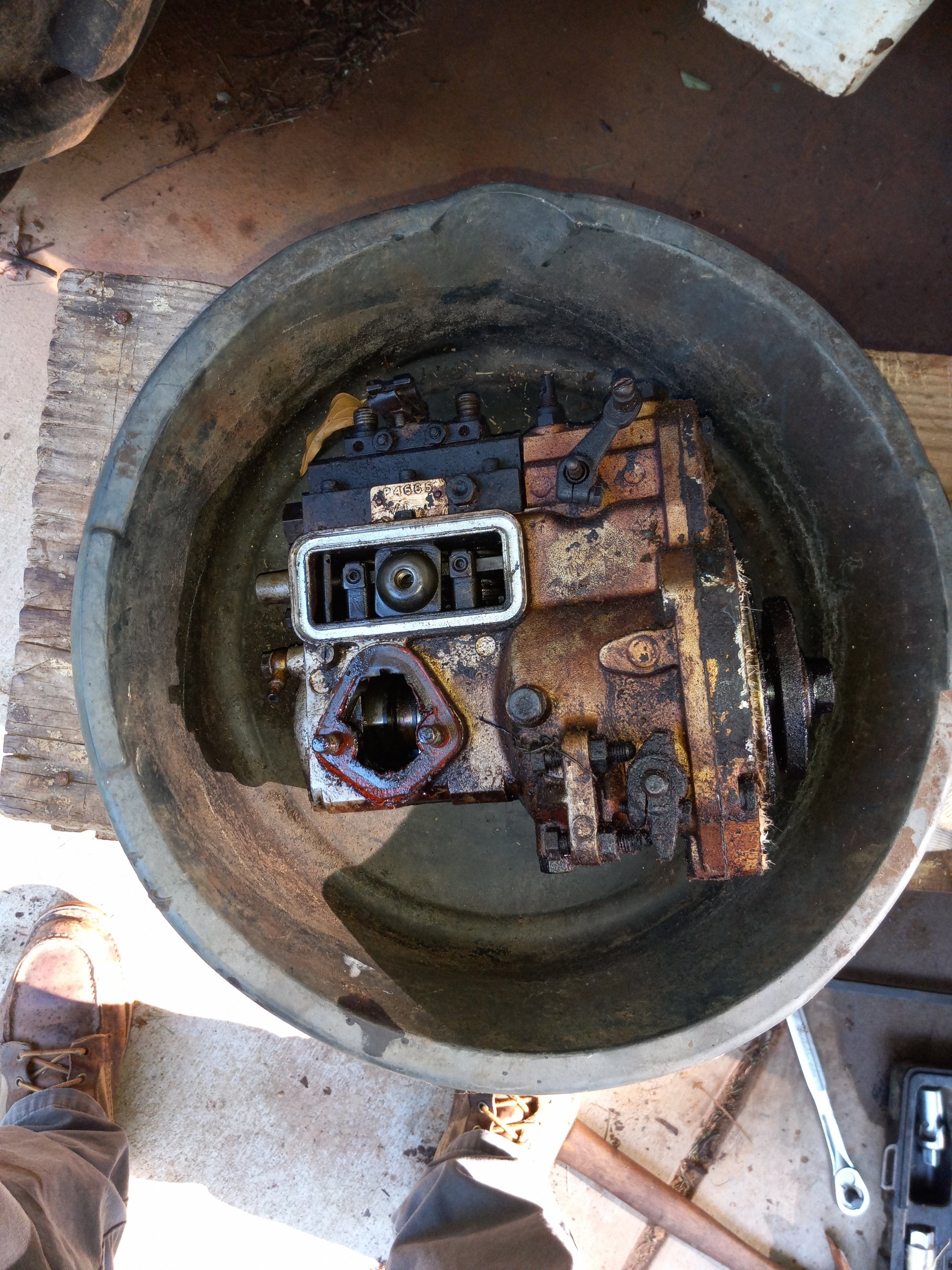

1/2” socket w a universal swivel and a stubby extension works great on the back bolt, if u attack it past the third outlet..
Hope that helps.

I got it out. I had to take the starter off to get access to the block-side bolt. Thanks for everyone's help. Couldn't have done it without you!

Sweat and Perseverance!
It looks like it has been in there since new!

I'm sure it has been untouched for 56 years! I have tried to get two mechanics and one shop to remove it for overhaul, but no one would do it. I know why now! Leaking diesel combined with dirt makes a huge mess. Thanks for your help!

Did u see the timing marks on the housing and drive hub.?? Did u use them.??
