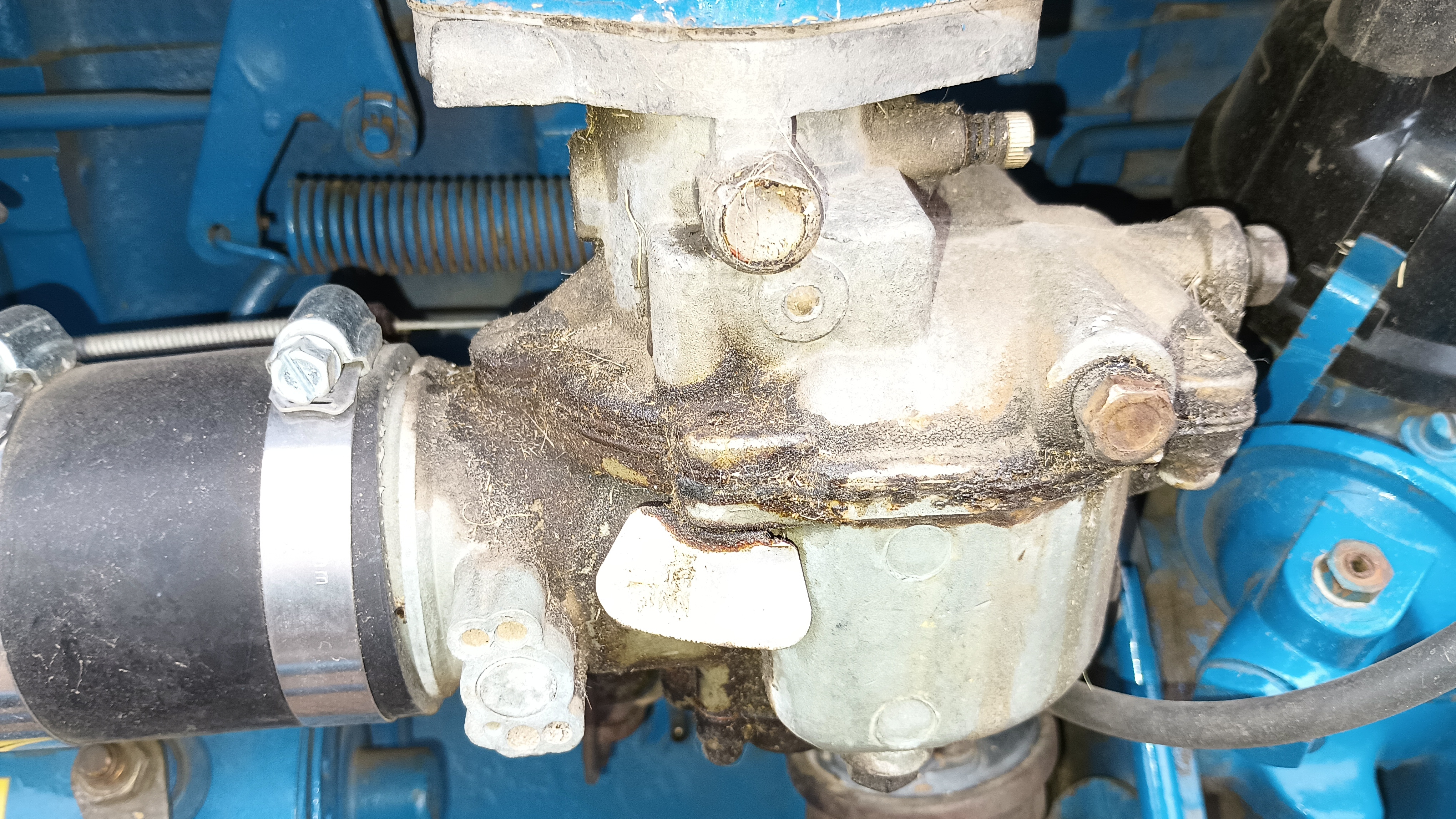

The vacuum advance on my Ford 3600 has been broken off since I've owned this tractor about ten years ago. (Over that time, I've though about repairing it, but didn't see the need.) The engine is actually from a 4600, but that shouldn't matter too much for purposes of my question.
The attached photo shows the distributor end, does anybody have a photo of the other end?

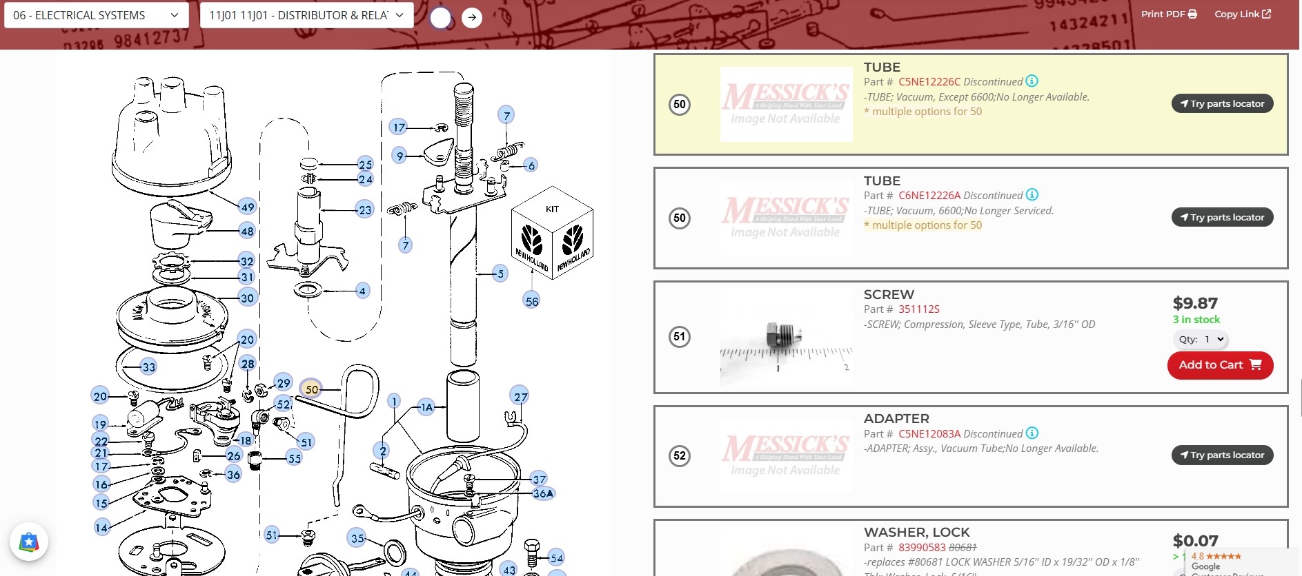

Here is the parts picture and descriptions
   / Ford 3600 Vacuum Advance
Thanks, but I already have that diagram. The vacuum line no longer appears to be available. What I really need to know is where the manifold end connects so I can make a new one.

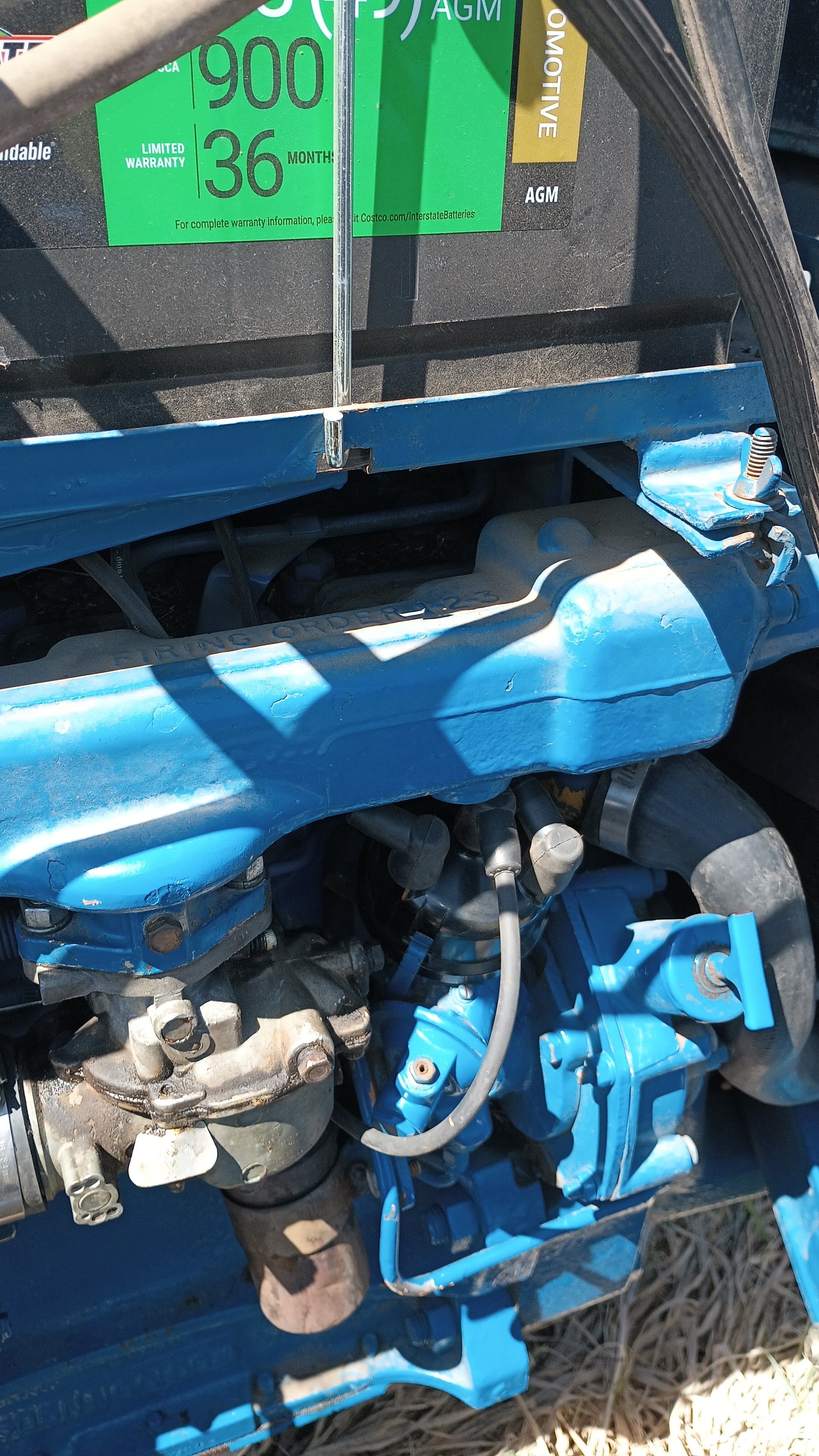

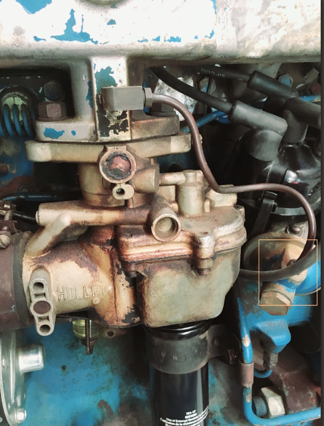

   / Ford 3600 Vacuum Advance #4
Here you go
I see a plug in my manifold where yours connects to the VA line.
Thanks for your help!
