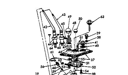

Does neutral start switch have continuity with gear shift levers in "N"?

Where exactly is the neutral start switch? not finding it in the manual....also, forgot to include this is a diesel.....

Neutral start switch wiring is parts key #61

It seems you have several problems. The starter won't turn the engine over and it only rund for five minutes whe it does start. A sjim points out, the starter circuit has a neutral safety switch so that you can not start in gear. The switch is located on the shift cover. The hi/lo lever must be in the neutral position for there to be continuity between the batteryand the starter solenoid. The red light is for the charging system as I don't believe your tractor has glow plugs. that light will come on when you turn the key to the run position. The possible causes for a failure to turn over is open circuit in the safety switch circuit to the colenoid, bad chasis ground connect, corroded battery terminals /cable connection, internally corroded cables dirty connection to the solenoid, bad ground betweeen starter case and the chasis, weak battery, failed solenoid and finally the starter is bad. If the starter turns but the engine does not, then the starter drive is bad. Check the battery connection, all the connections to the solenoid etc. and the cables and grounds first. they are the most likely to be the culprits. The first thing I suspect when you try to start and hear only a click is the battery terminals and the grounds. But your machine has been sitting unused so their are probably a few other possibilities.
