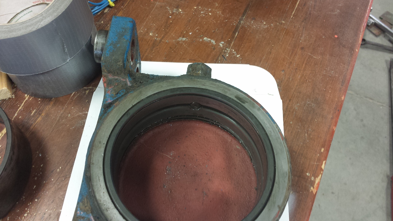

Sixdogs, I was afraid that's what you were referring to. In my case the axle oscillates on this surface. If I bond the gear case housing to the outer bushing the axle will not oscillate. I think maybe one variety of the Loctite material is designed to fix my problem. But after curing it would require machining to get the surface smooth and the outside diameter of the gear case housing back to the original diameter.

When I get the new outer bushing I'll fit it and see how much slack I still have. If it's minimal I'll put it back together as is. From the wear it appears at least a part of it's life lack of lubrication is the culprit. If the fit is good enough to allow the o-ring to seal and if I keep it lubed, I'm guessing it'll outlast me.

You mentioned that the bearing with the zerk adapter was a slip fit , This seems unusual , Is there a possibility that the housing it is installed in has been "beat up " a little bit ?? This would likely be a good candidate for the Loc-tite products discussed earlier in the thread ,

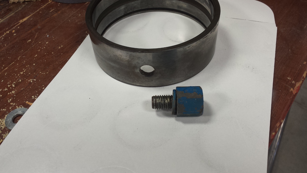

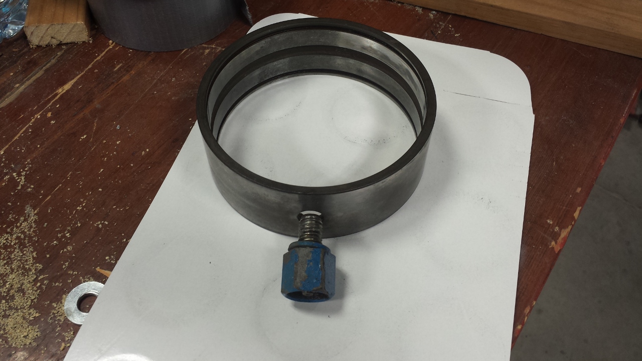

Kevin,
I removed the bushing from the front side carrier housing and flipped it over, to wear on the other side a while. It was just like the rear one. Remove the grease fitting adapter and the bushing slips out. The zerk adapter threads are even pointed slightly on the end to guide the bushing into the right spot. Strange but true.... :)
I bought a replacement bushing for the rear which is close to the O-ring, hoping I'd control the leak. $375 or somewhere around that. WTH. That's why I'm gonna try reusing the front one.
