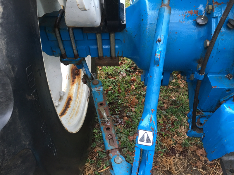

Richard,
Do you have a picture with the telescopic stabilizers in place? I ordered some but I have the straight brackets like the pick you posted and I'm not sure if I should order the angled version so there is no binding. Thanks in advance for your help.
   / Ford 3910 #52
Richard, Do you have a picture with the telescopic stabilizers in place? I ordered some but I have the straight brackets like the pick you posted and I'm not sure if I should order the angled version so there is no binding. Thanks in advance for your help.
Cool deal, looking forward to the progress!
   / Ford 3910 #53
I dont have a good pic but yes you need those angle brackets they'll clamp to the axle housing outside of the fender clamps. I'll try to remember to get a pic today.
   / Ford 3910
#54
Thanks for the info! I'll just give them a call today and have them change the order so that it includes the bracket and u-bolts. It's actually 15 to 20 bucks cheaper per side to buy the kit. I think they are waiting on one part before they ship everything (I'm not in a hurry). Glad I thought about it before they shipped everything.
   / Ford 3910 #55
Here is a pic of the stabilizer and bracket.
   / Ford 3910
#56
Thanks for the pic! That helps a lot. I went ahead and got the angled brackets and u-bolts. Now I just need to source a nose cone and grill. The prices on ebay seem to be all over the place on the grills. I found a couple for around $40 to $50, but I'm a little worried about fitment issues. There are no part reviews on ebay that I'm aware of so I'm kind of taking a leap of faith if I order something.
   / Ford 3910 #58
Thanks for hookin him up with the pic Happy!! I'm at the farm now and just remembered the pic ordeal. Thought I'd check TBN to make sure I got the pic he needed. That's exactly what I would have taken. :)

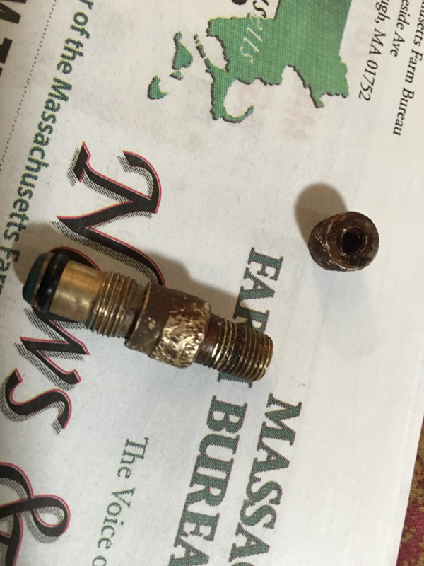

Ouch! That is a rather ugly looking valve stem area. CaCl is apparently eating your rims from the inside.
Good eye, I checked it out tonight, valve stem had a slow and I'm guessing intermittent leak that had probably gone on for a while. The tool end of the cap had rotted off and the calcium chloride must have occasionally leaked out through the hole, it was dry on inspection. I pulled the removable core, wire brushed everything and replaced the core assembly. Rim had rust scale on the outside around the stem, but seems solid after I got the scale off. Glad you noticed it!! That's the beauty of this forum and sharing!!
image-70645965.jpg The culprit
