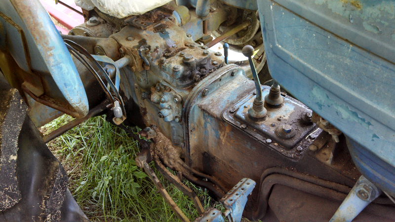

I looked and I do not see a dip stick anywhere. Here are some photos.

It's because this is not a 1963 4 cylinder 4000. I asked this question earlier to help give you correct info. Your machine is a 3 cylinder 1965 or newer machine, not a pre '65 machine. Model identification makes all the difference in the world!
What I said about pipe plugs and dipsticks does not apply to this model.
I don't know anything about the '65 and later machines, so am bowing out here...

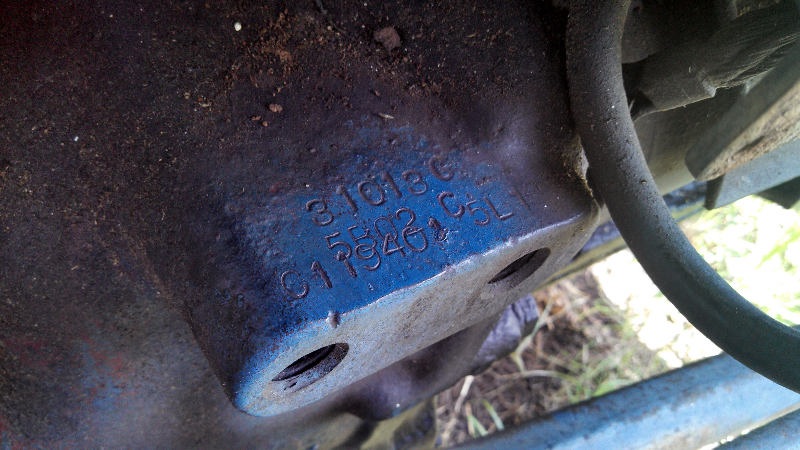

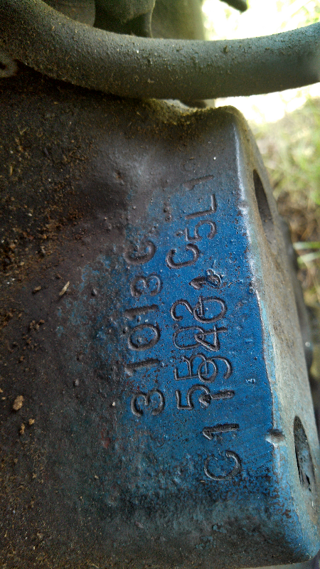

um.. count the injector lines.... one for each cyl...
no way you matched up a sn on a blue ford to a 63 series....
post it... there is a model id code , a date code, and a sn.. the sn will have a C, B or A prefix. beware that if it is a 3000, the model id could have a C or 3 prefix, depending on if it is pre 4-68 or not.
2000 will have a B or 2 model id prefix.... 4000 will have a 4/D prefix.. etc..
if you don't know what you got.. post the pics i asked for.. rear axle trumpet profile.. left side of engine area including front bolster and steering box area, plus a front on pif of the frotn axle and bolster.
detail right side pic under the seat of the center section will help too, if it is a 4000

Here's a couple pictures of the serial number. I'll have to go back out and take more if you actually need the others you mentioned. I woke up with some stomach bug today so I'm not really feeling up to keep walking out there to get pictures. Hopefully this will help.
