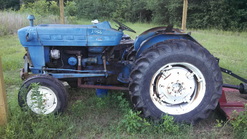

Thanks! They sure sold this to me at auction as a 1963 Ford 4000. I'm glad to know now. That explains why I was sent the wrong oil Filters a while back.
I had to go back out there and look cause I could have sworn it had a 4000 decal on it too. But it actually doesn't have any on it at all. I was able to just barely make out a 3000 on one side of it if you look close. Here's a picture of the whole tractor.
   / Ford 4000 How to check Hydraulic Fluid? #24
louvered early tin.. light front bolster.. radius rods.. left rear engine pump.. classis early 3000
whoever id'd it as a 63 4000 is a fraud
