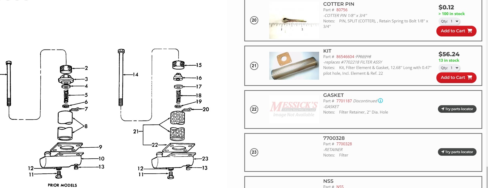

A+ !! Thanks for the link, I am currently looking to replace the Hydraulic filter that is located in the loader arm.... Not having much luck. A piece of trash got through and my loader bucket will not uncurl. loader lift and drop works great - pretty sure there is trash in the control valve due to a shoddy filter...

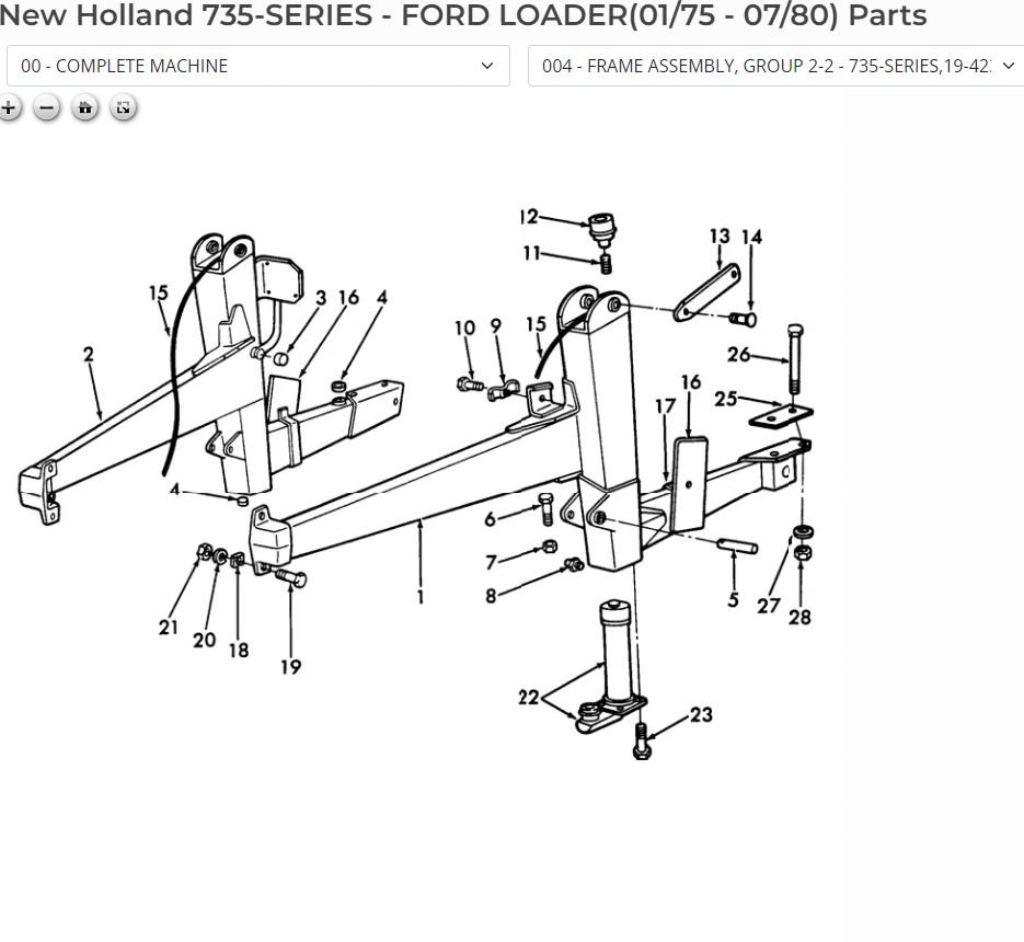

Looks like you have a 735 Loader on your tractor. Is your filter like this in the pictures?

Most have been replaced (hoses). However a collapsed hose could very well be the culprit. I have the filter on order as the original denigrated ( it looked to be a "Paper element" which became clogged and collapsed. I have seen the situation that you described with a drum/caliper the hose that attaches keeps fluid from returning to the master cylinder!Once the filter comes in and is installed I will begin to (crack hoses and inspect for flow..... Primitive and messy is how I roll!
   / Ford 4500 #45
It was not like this, it was the 'paper' type... I measured and have tried several of the filters that are depicted in the attachment on your post.
I am attempting this one I purchased from amazon (has yet to arrive)
WIX MN-S45E40T Direct Interchange for WIX-S45E40T, Stainless Steel​
I looked up the part number and the specifications seem to work; 9" long and right diameter
"The model you posted is - correct" and the illustrated parts breakdown is accurate.
If this works - I will let you guys know! Thanks for your input!
