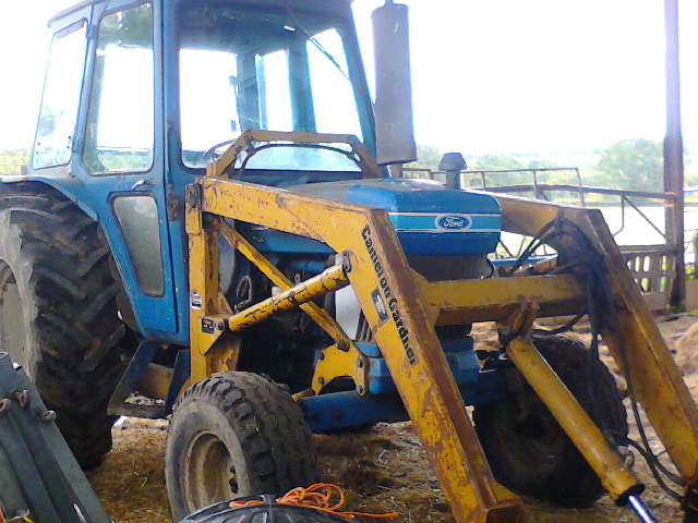

Hi my ford 4610 has trouble starting off in gears higher than low one i adjusted the biting point on the clutch but it didnt do anything any ideas?

Well the engine stays running but goin on flat ground it takes a lot of revs to get rolling as if the handbrake was on(but i know its not stuck on)

Idleing rpm but to get moving needs high rpm.no smell or oil.i know the brakes arent stuck on as it acts normal in lowest gear.

8 forward four reverse and it only starts moving right in lowest gear.could it be the clutch?

Well not familiar with the 8x4 but if its full manual and not a shuttle transmission then should be clutch. Its not popping out of gear right?

I had the same issue on my 4000. It was the clutch.
Yeah not much to go wrong on manual except clutch provided its staying in gear and not popping out.
