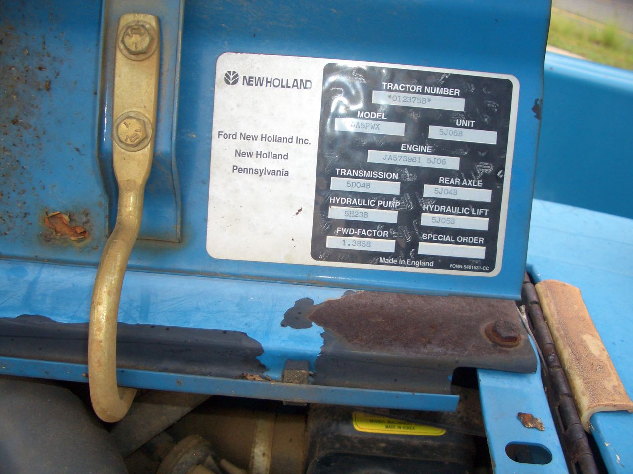

It's being advertised as a 1990, but it says turbo on the side and the serial number they are listing is 12548009342 which by tractordata.com would be maybe in the 1999 time frame. I thought I saw another post that said the turbo wasn't used until 96 or 98 or something...
If I remember right starting in 94 they had blue fenders before that they were white. It has the NH emblem on the front looks just like the 95 I had.
   / Ford 4630 or 3930 #23
It's being advertised as a 1990, but it says turbo on the side and the serial number they are listing is 12548009342 I thought I saw another post that said the turbo wasn't used until 96 or 98 or something...
12548009342 isn't a serial number for a 4630. Look for a six digit number with a two letter prefix BD or BC, or a 5 or 6 digit number with a 'B' suffix. Or locate the unit code (also on the data plate) which will date the final assembly of the tractor down to the day & shift. 4630's were turbocharged after 6/1/94.

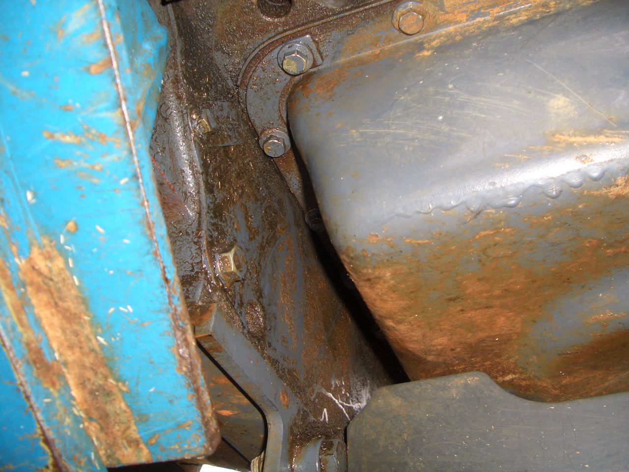

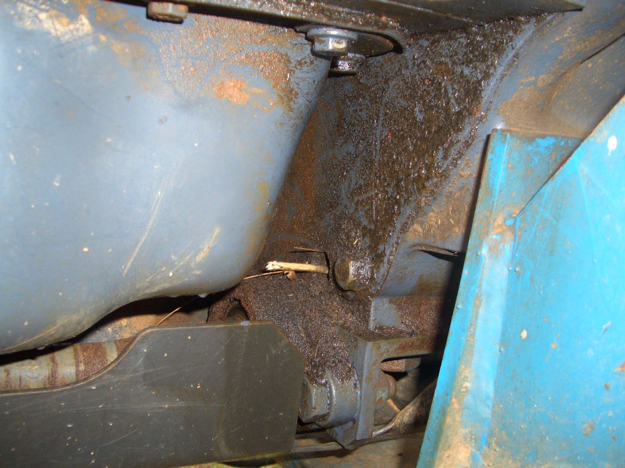

Ford 4630 pics of details:
This the oil at the rear of the oil pan, clutch cover:

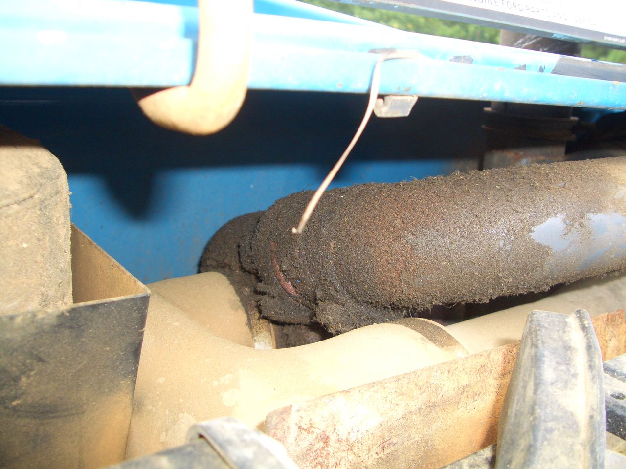

Data Plate inside the hood. It has Blue fenders
Oil on Turbo to intake hoses

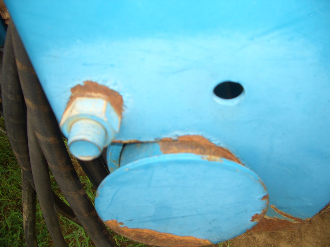

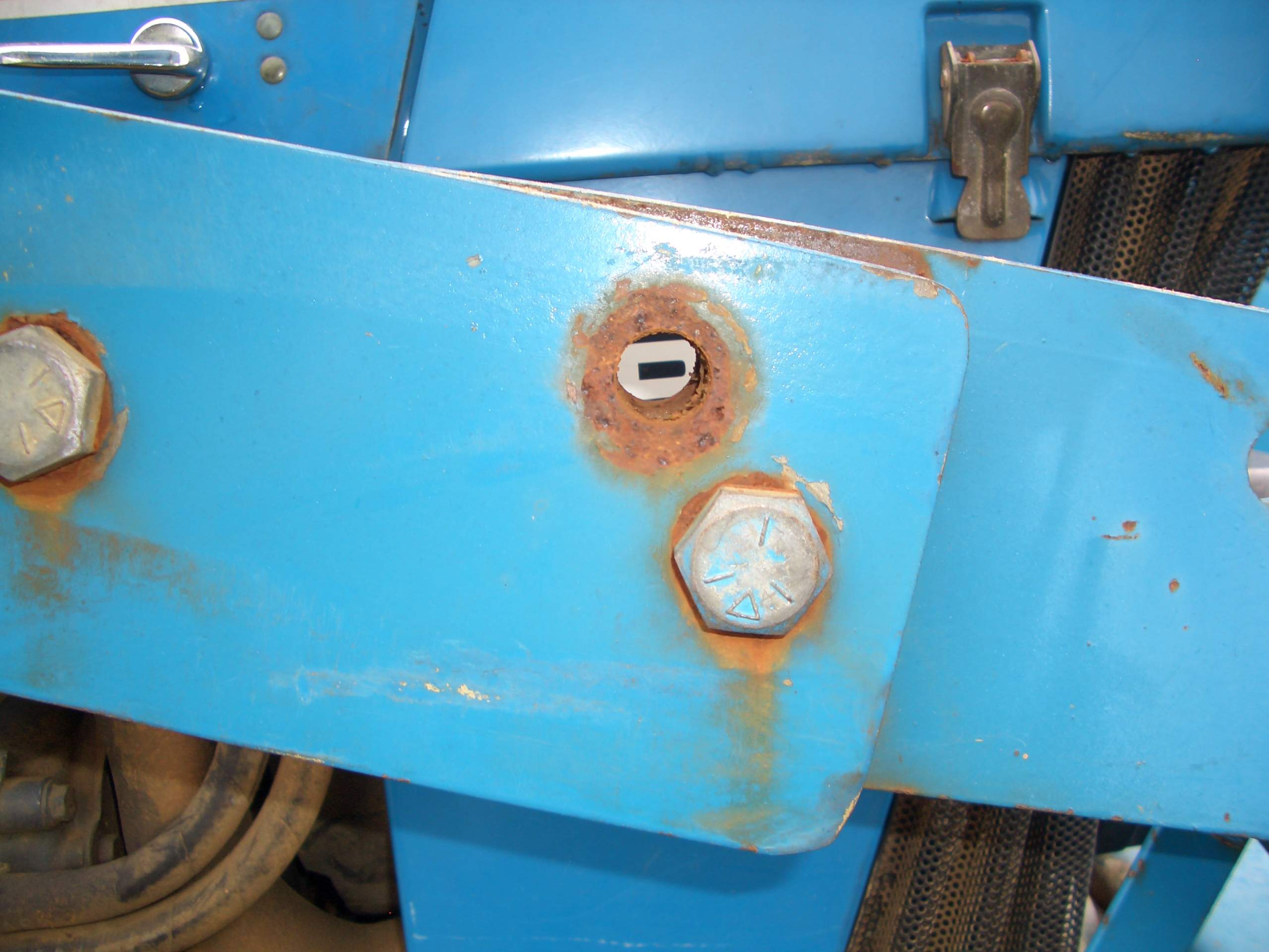

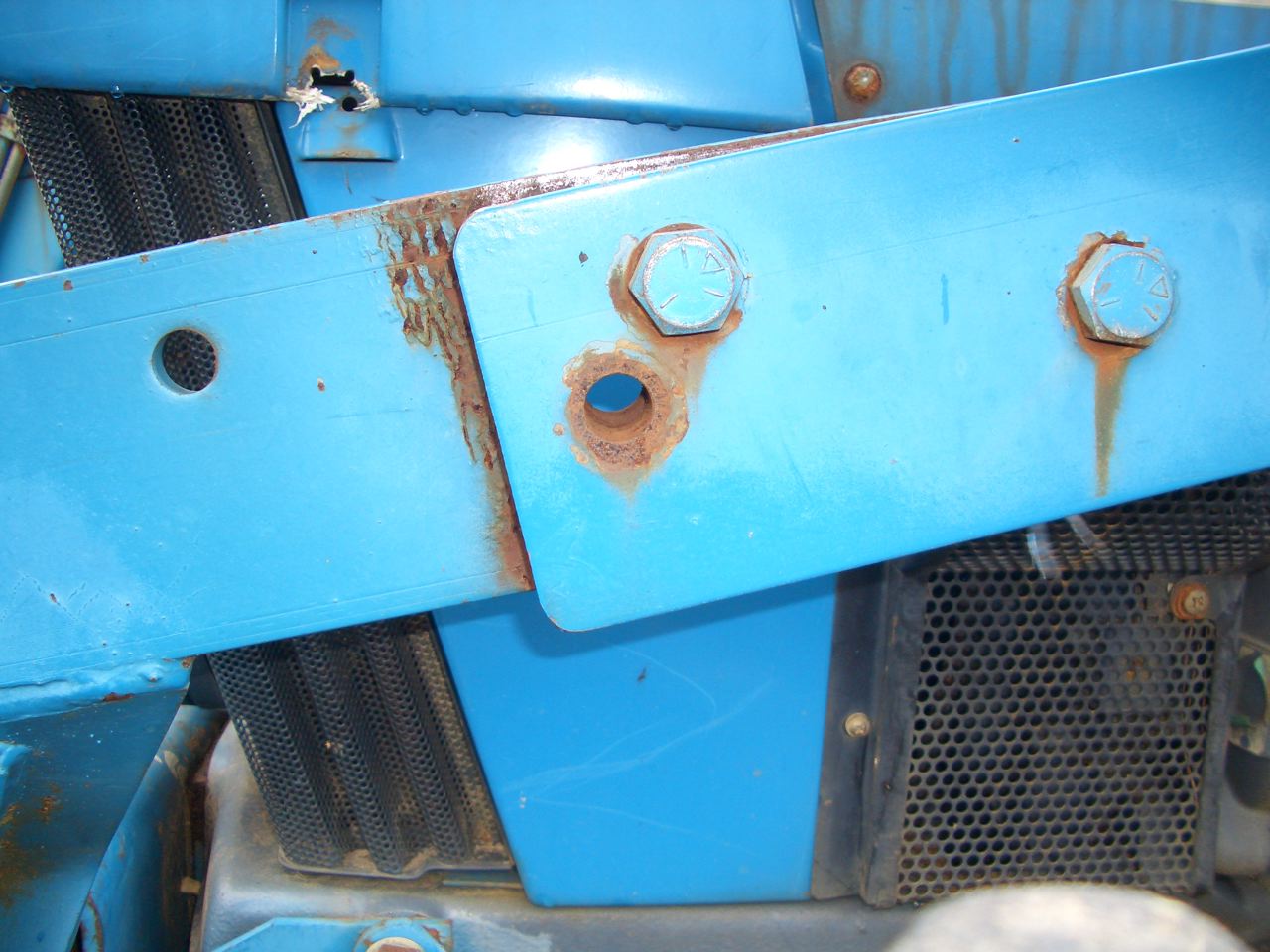

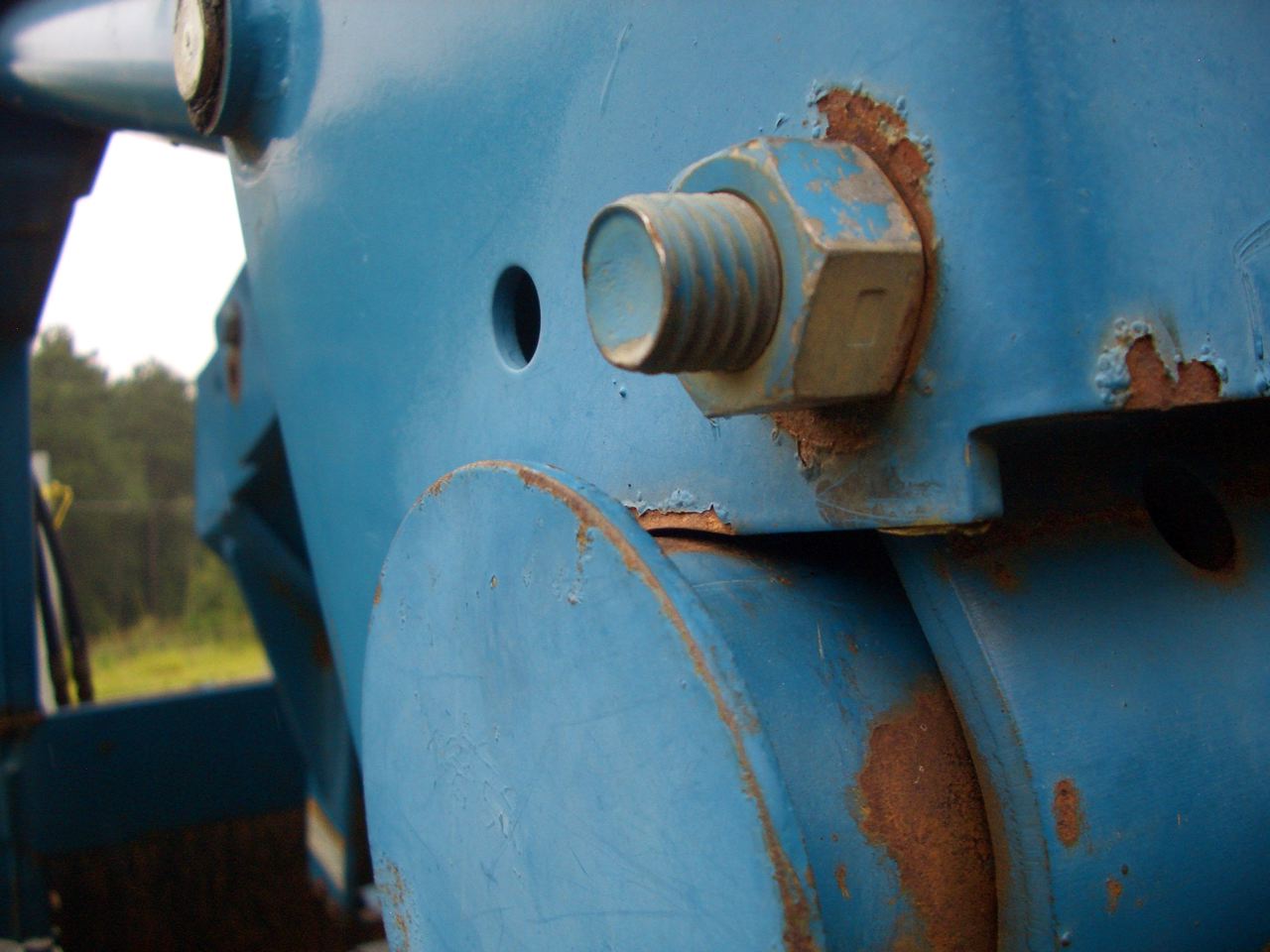

This is the lower left rear mount for the loader and the right. Very slight deformation of the metal where the loader met the pin (slight mushrooming). Didn't look bad to me.
The next pics are on the forward bracket of the loader. There's a bolt missing on both sides, and these two plates would shift under load about 5 degrees, from being misaligned up to misaligned down.

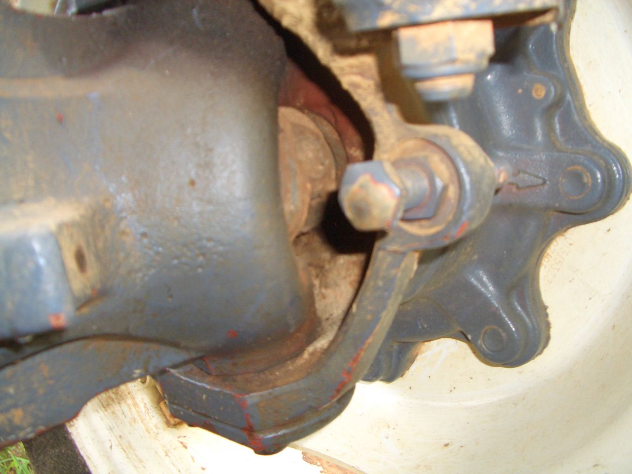

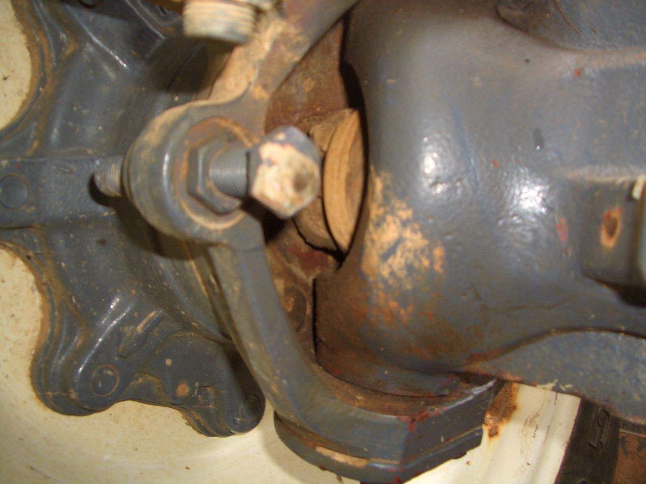

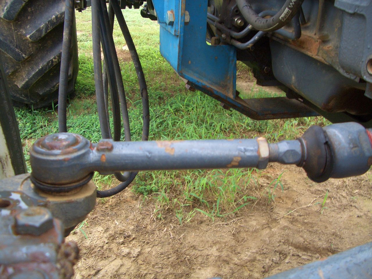

Front axle, maybe I would try to add a grease fitting on the tie rod ends.

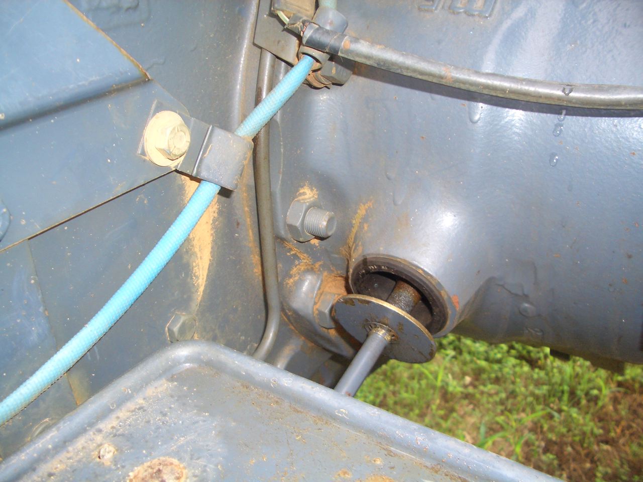

Out of curiosity, what is this rod for that enters the rear axle case on the front left side? That's the foot board just forward of it.

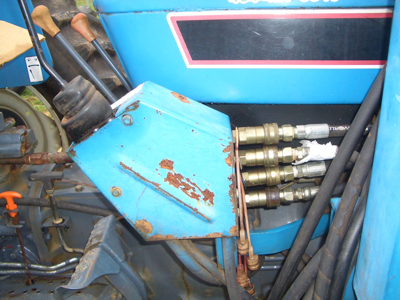

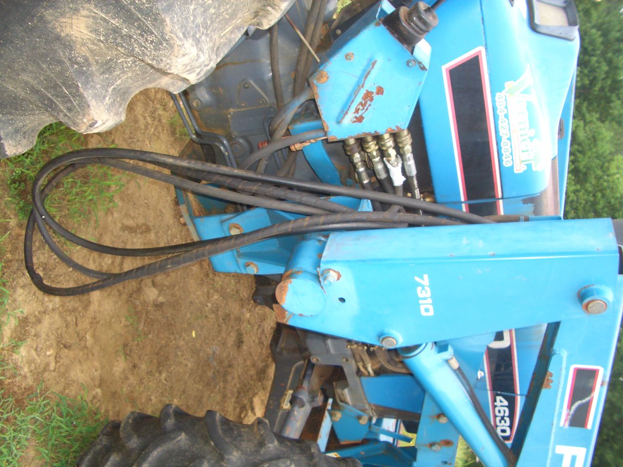

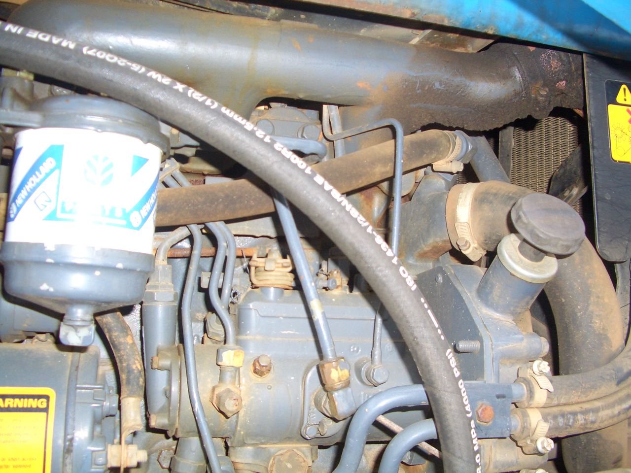

These hoses seem overly long. Is there a better solution?
