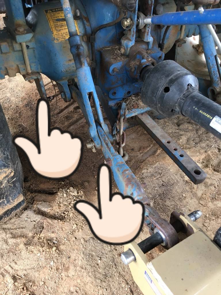

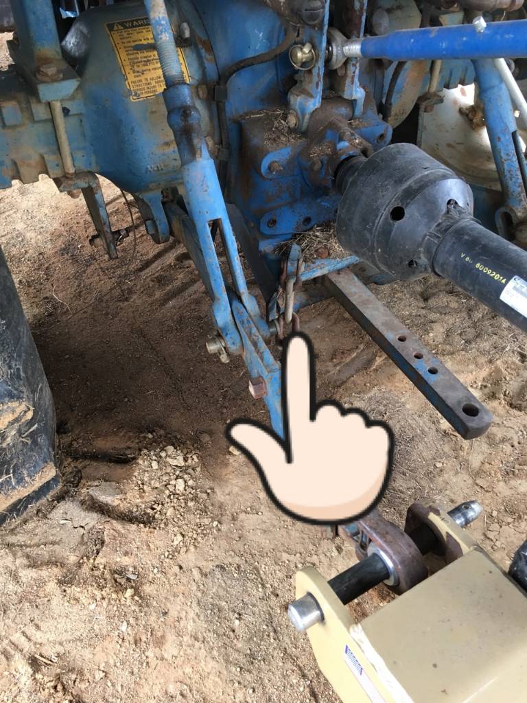

I’m a little gun shy as the first set I ordered for my 4610 would not work. If I remember correctly the bolt/pin diameter was too small where it connects to the lift arms. To make it work I was going to need to switch lift arms or drill existing ones out but was worried that might compromise the arm strength.
   / Ford 5610 rear stabilizer bar help #14
stibalizerchain runs from the outside (not inside) to the arms and sould have its anckerpoint inline with the lowerpoint attach to the tractor. Yours will brake when impl is atached.

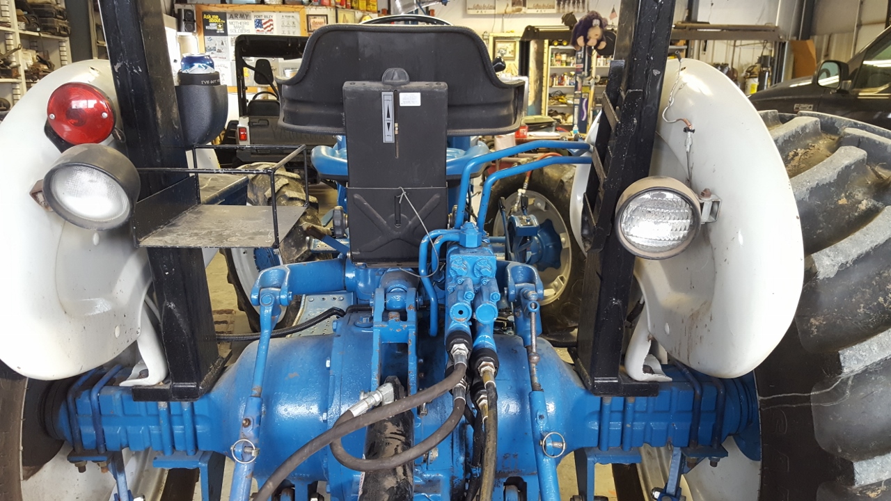

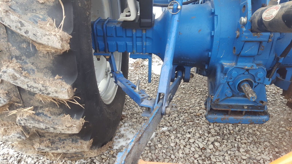

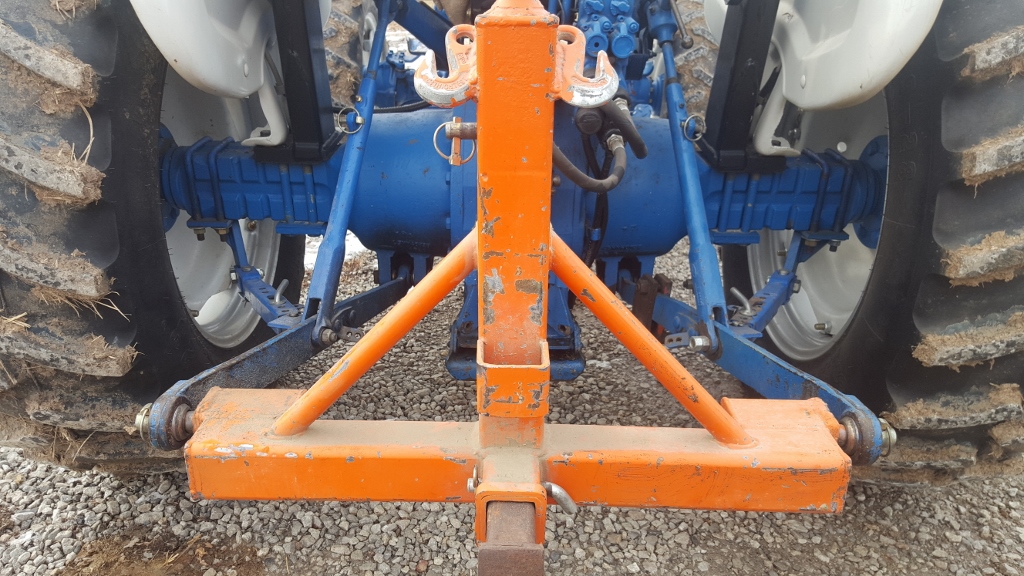

I've got hundreds of pics of my tractor but can only find one that include the stabilizers. I'm going to the farm where it's parked today. I'll get better pics.
My stabilizers came with brackets that U-bolted to the axle housing outside the fender/ROPs brackets. Then bolted to the lift arms. I don't recall having to drill my arms.
Here's a pic that barely shows the axle end.

Here's a couple pics of mine.
   / Ford 5610 rear stabilizer bar help #20
remove that chain
When I bought my tractor that's the exact setup it had. Installed at the factory.
I switched so I had better adjustability.
